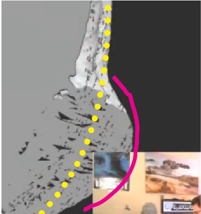

Planning the cuts

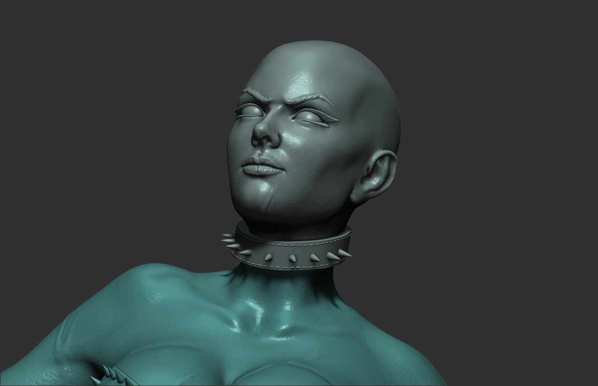

The ideal is that the clothes, accesories or props of your character allow you to hide the cuts, this way you won’t have to do much post-processing and the sculpt will have a cleaner look.
In my case the few clothes she’s wearing helped me with this, the following image shows the division of pieces with a yellow line.
Cuts 01
In case you have the chance, it’s important to take advantage of creative freedom with the design. In my original design the choker around the neck wasn’t considered but it allowed me to divide the head from the torso, it’s an element that integrates well with the other accesories and functions to hide the cut.
Cuts 02

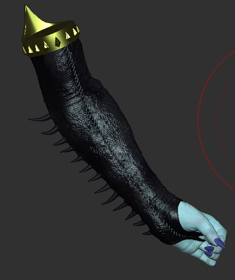

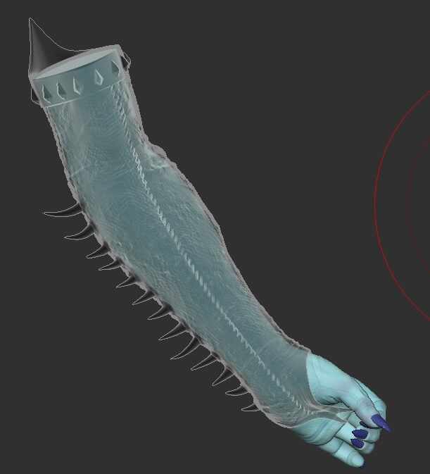

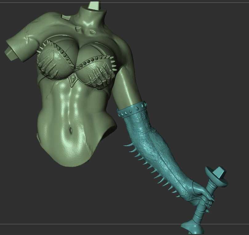

For this subject I’ll use the right arm as an example; I knew that part of the arm and the forearm were going to be covered by the long glove, even though this geometry wouldn’t be visible it was necessary to keep it in order to fill the hollow space of the long sleeve.
brazo01
brazo02

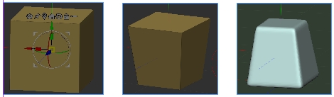

The key has nothing fancy or special it’s just a tappered cube with smooth edges,
this softened edges are important in order to facilitate the connection between the male and female piece,

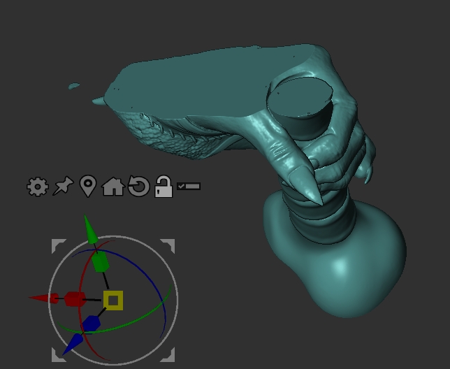

connector 01
At this point we need to weld using dynamesh, not only merge, the connector to the subtool that will be part of it, the boolean operation to get the female piece will be generated later in the process.
Male 01
Merging subtools

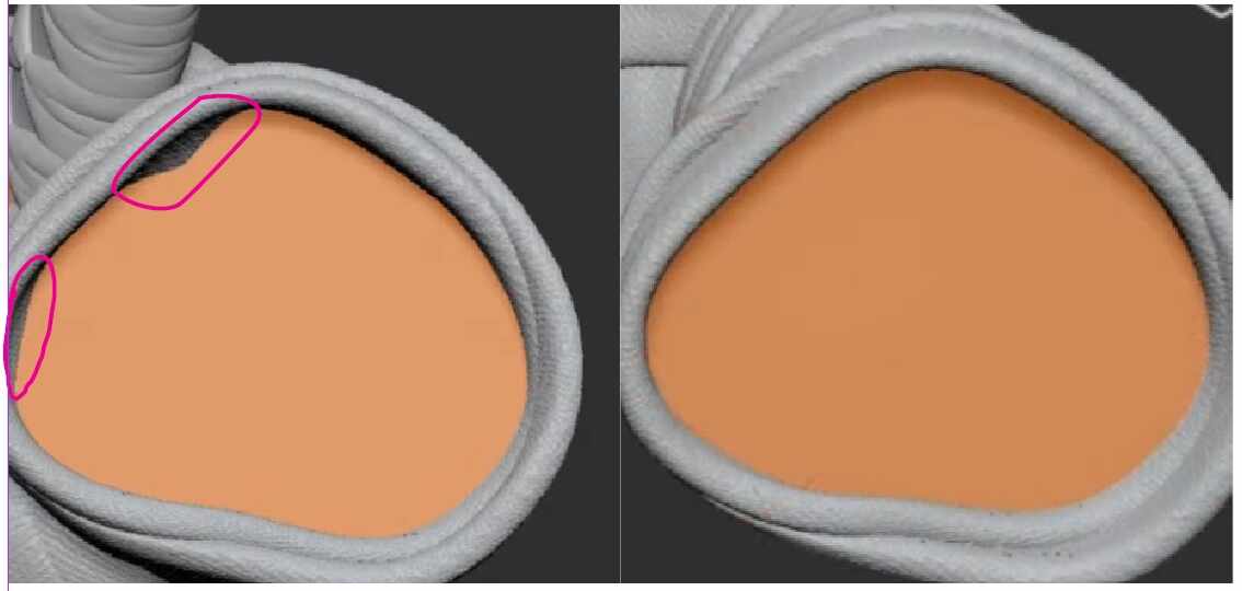

Fixing holes
To make sure the resulting subtool has no holes:

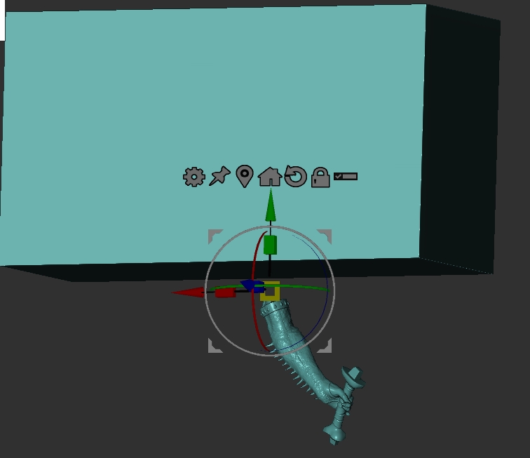

1-Create a cube big enough that covers the subtool
2-Create a new folder with the subtool to be cheked and the cube below it
3-Turn on the arrow in the boolean menu of the subtool to be checked
4-Select subtract mode in the boolean menu of the cube
Check01
5-Position the cube over the subtool and move its pivot below it
6-Slowly move the cube in order that covers the subtool. With the subtract boolean it gives the impression that the cube is slicing the piece, just as the real slicer software. The goal is to locate holes inside the geometry and fix them
Check02 Check03
If you find areas that need to be adjusted
7-Select Move brush/turn on Backface mask (Brush/Automasking menu) and move the inner walls of the meshes in order to create a penetration
8-Dynamesh again, this welds both meshes and closes the hole
check04
On the left mesh with inner hole. On the right the hole has disappeared
IMPORTANT NOTE: Be careful with the move brush and adjustments you make, if you are not careful enough you can modify the outer forms (visible areas of the piece) and afect the original design.
check05
The pink line represents a deformation

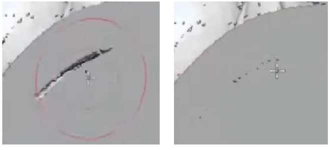

Floating Geometry Check
Sometimes booleans and dynamesh can leave some floating polygons that will cause errors with the slicing softwares, to check if this si happening and fix it:
1-Select the subtool you want to check/turn on solo/turn on Polyframe (you can hide the polygon edges by clicking on line)
2-Go to Polygroups/Auto group
3-Select the Rectangle Select brush and CTRL+Shift click on the subtool (this isolates the polygroup of the subtool from other polygroups)
4-CTRL+Shift drag on the canvas to invert the selection
If your subtool didn’t dissapear, congrats you don’t have floating polygons, if it did go to step 5
5- Invert again the selection by CTRL+Shift drag on the canvas (this turns on visibility on the main subtool you’re checking)
6-Go to Modify topology/Delete hidden, and the floating polygons have been erased.

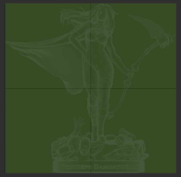

Checking scale
I used the scale master plugin with a bounding box previously generated to check the real physical size of each piece.
Scale01
I want to take the opportunity to complain about the scaling and measurement system inside zbrush, I understand that this is the way it was programmed but I find it super unintuitive, other software has a more understandable manner to deal with units, scale and measurements.

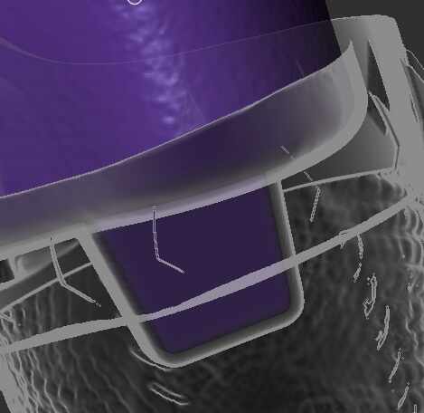

Making the key cut (female parts)
Before creating the female piece by using booleans, it’s very important to add all the necessary male connectors to the male piece and be sure these won’t be modified or moved.

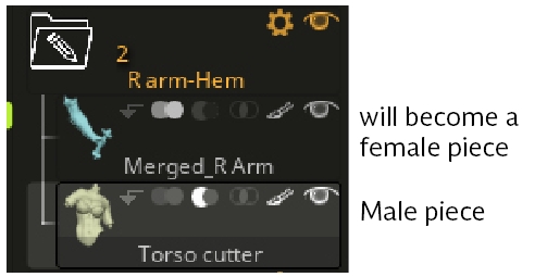

I’ll use the torso and the right arm as male and female pieces respectively, the process is something like this:
kcut 01
1-First I duplicated the male part that will provoke the key cut (torso), then create a folder
Note: It’s very important to duplicate and not to use the original male piece
2-Rename this duplicate with the sufix cutter “Torso cutter”
3-The subtool that will have the key cut (right arm) must go over the male piece
kcut 02
4-Turn on subtract boolean in the male piece/Turn on the live boolean button
5- Apply the inflate function to the male piece in order to create a physical gap between the key and the female piece.

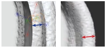

This is a crucial step in order to have a size tolerance that will ensure that the male piece will enter into the female, take into consideration that this gap will be filled with glue in the printed piece.
6- If the boolean operation created “walls” it’s important that these have a measurement of 1mm as minimum. If this walls are thinner use the Move brush (backface mask turned off) to pull out the mesh in order to increase their thickness, be careful not affect in a destructive way the original design.
kcut 03
On the left the wall thickness is less than 1mm, on the right it has been increased to 1mm

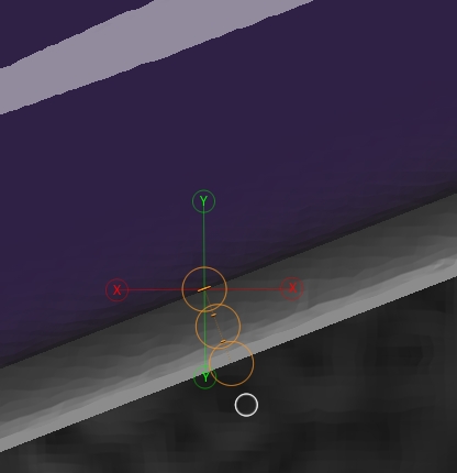

7-In the folder containing male and female pieces, push the gear button and select Boolean folder. This will generate a merged version of both subtools with the boolean cut applied. It’s necessary to measure the gap distance between the male and the female.
8- Select the new subtool with the boolean cut, go to Display properties/Flip
9-Turn on visibility of the original piece, not the duplicate in the folder, I mean the male that will connect to it and turn on Transparent button
10-With the transpose line measure the gap. I followed the advice of Ian Robinson to have something between .2 and .3 mm of gap
If you’re happy with the gap distance select again the female piece, go to Display properties/Flip, this will return the normals back to the original orientation.

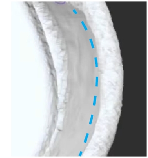

Most of the time the boolean substract operation will produce very hard edges on the cut surface, this can lead to difficulties at the moment of connecting the printed pieces.
1-To fix this just grab de TrimDynamic brush and turn on Sculptris to soften those razor sharp edges
Refine01
The blue line represents a very hard edge that needs to be softened

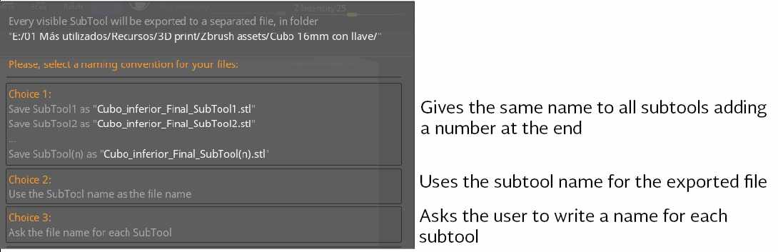

STL export
This can be easily done by using the zplugin 3D print hub
1-Select the subtool that you want to export
2-Click Update Size Ratios and select the right measurements in mm
IMPORTANT NOTE: If you need to export several subtools do not select another one different from the first you selected. Changing the selection will create scaling issues.
3-Go to Export options/Visible (it will export only visible subtools) or Selected (to only export the selected subtool).
4-Export STL and define the file location. If you selected visible in step 3, a window will prompt with the naming options for the exported pieces.
export01
I followed these steps for all separated pieces and obviously this presented lots of challenges to me, remember it’s my first sculpt for 3D printing. Naturally I had to rework some areas because I didn’t know the rules and characteristics for a piece to be 3D printed.

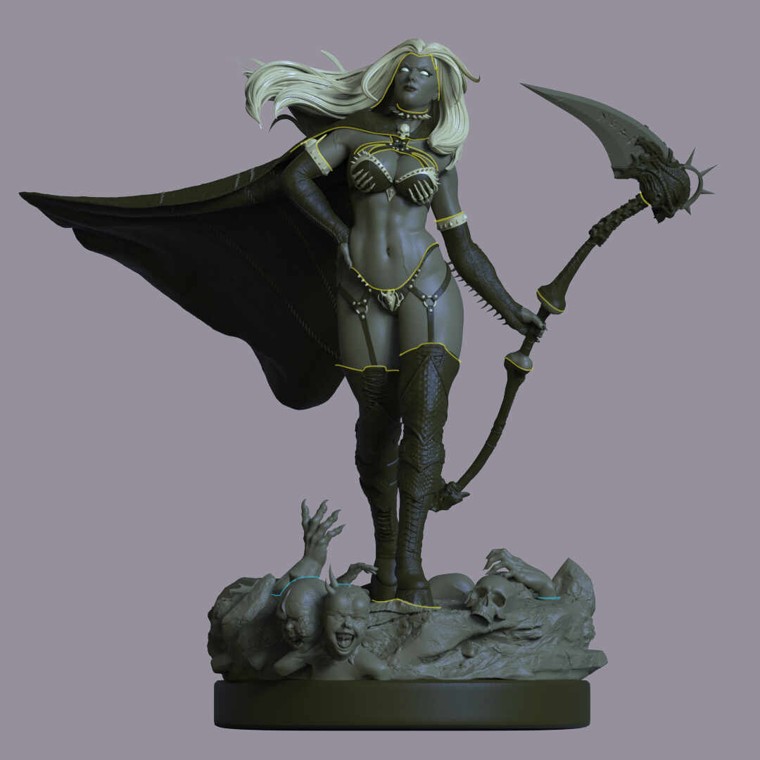

Final Thoughts
This blog entry closes the adventure I had with the creation of this fan art. Along the process I’ve learnt lots of things to consider for my next pieces.
First walk, then run
To be honest I didn’t think this piece would be so complex to finish, maybe I forgot it was my first attempt to sculpt a semirealistic female figure and prepare it for 3D printing.
I think it’s important to learn and acquire new skills bit by bit and focus on a main aspect, for example: human anatomy, sculpting hair, hard surface or whatever. With this piece I faced lots of challenges and difficulties for the first time and in some point of the process I felt overwhelmed, sometimes my inner voice said “maybe it’s time to quit and start an easier sculpt”, fortunately I didn’t hear it.
It’s okey to put yourself in front of challenges but be careful not to overexert your capabilities and skills, this could lead to frustration and quiting the project.
Even though I haven’t printed the piece I’m very proud and happy with the final result, obviously is not perfect but it’s a great first step.
I’ll be posting the final renders as soon as possible, feel free to comment and critique.
