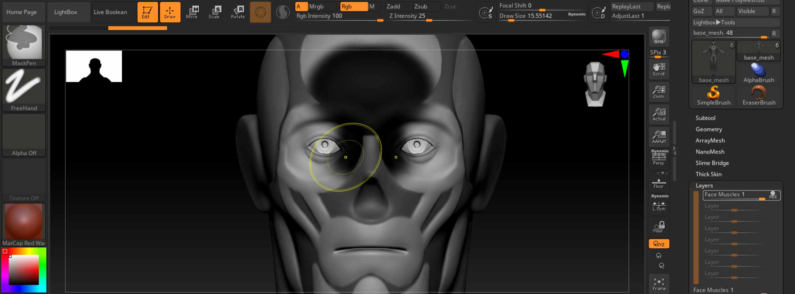

I think a few others have reported a similar issue before, here and at Polycount. I think those involved Polypaint though. This involves painting/adding a different material to certain sections. Either way, the issue is linked to using Layers. Baking them down fixes the issue, but it would be awesome if this issue was fixed. :slight_smile: The plan for my project was to use a Layer to sculpt muscles of the face and then paint a different material over them. The problem is is it shows everything in black instead.
ZBrush_7wFEyechXi
I know the image looks like I have RGB enabled, but it’s because I have to hold down Ctrl, Shift and Print Screen to take a snapshot. Only Mat is enabled for the brush though.
