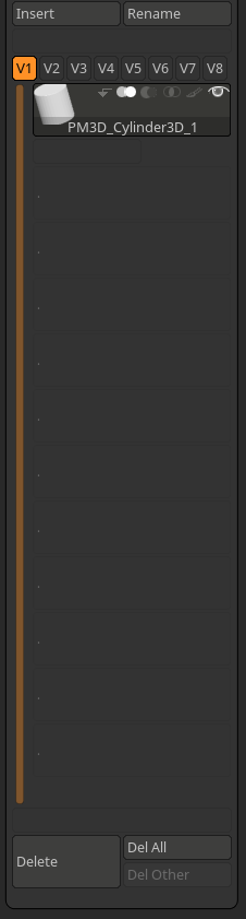

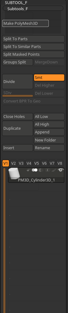

It is possible… i have been working on it for three weeks, and got it to work… i know have just a sub tool menuScreenshot 2024-05-01 090913 Screenshot 2024-05-01 090921 Screenshot 2024-05-01 090929
