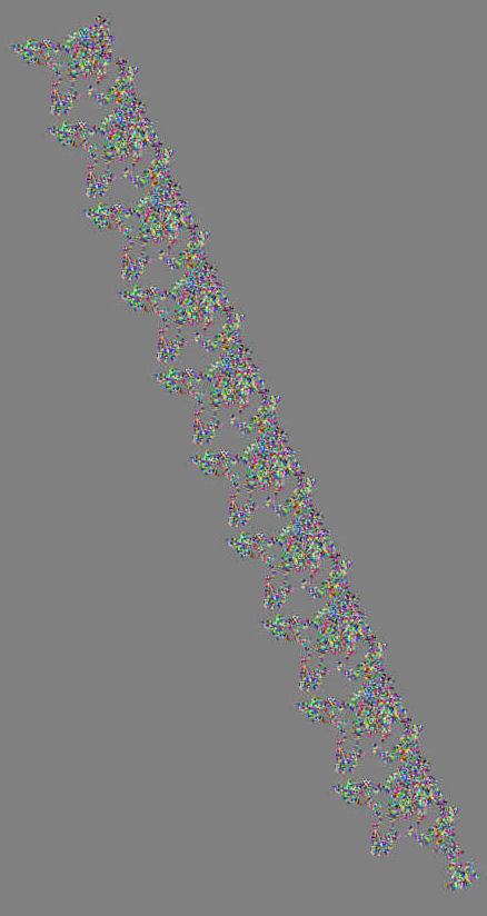

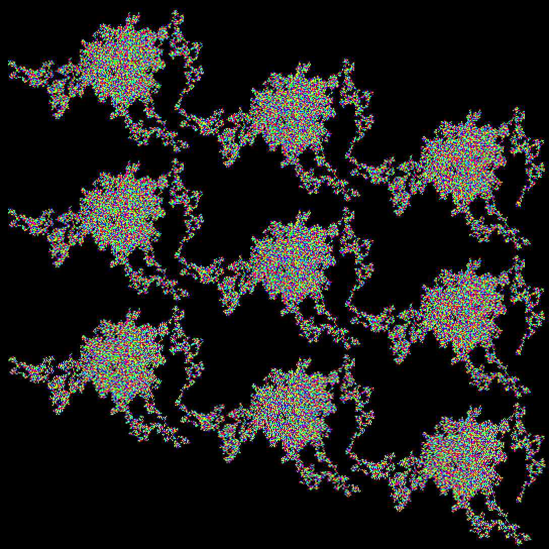

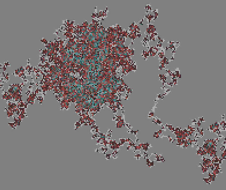

Now i have write a small “Walking Drunk” routine with the following result (50.000 iterations):
The routine starts drawing an object in the center of the canvas and move (one step) random in one of eight direction (N, NE, E, SE, S, SW, W, NW), then move random for the number of iterations.
The image shown a regular pattern… :o… not a random pattern.
The word of pseudo, random, aleatory number is very misterious…Tonight (i hope) i’ll write a personal random number generator and i’ll post the script to do some tests.
Now you can try with the Zplace2 revI beta2 version: set the parameteres and press the “W” button…
Thanks for trying.

Thanks all for reply.
I had some problem with the internal math precision of Zscript:evil:
I have written some more code to test the rand generator…
Download the Zplace2 revI b4
The first example show basic method:
Start ZBRUSH
Load Zplace2
Select Sphere 3D
Set DrawSize to 5
Press the “Snap” switch
Open the “Walk” section
Press Ctrl-D (place Sphere3D on canvas center)
Now select this color R= G= B=
Set iterations to 10 (10.000 iterations)
Press “Randomize” button (To start with new seed)
Press “ShowInfo” switch
Now press “Drunk Walking” button (or press Ctrl-W)
You can see the sphere3D random movements on canvas…
You can stop the walking pressing ‘ESC’, you can restart walking pressing ‘Ctrl-W’.

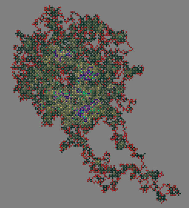

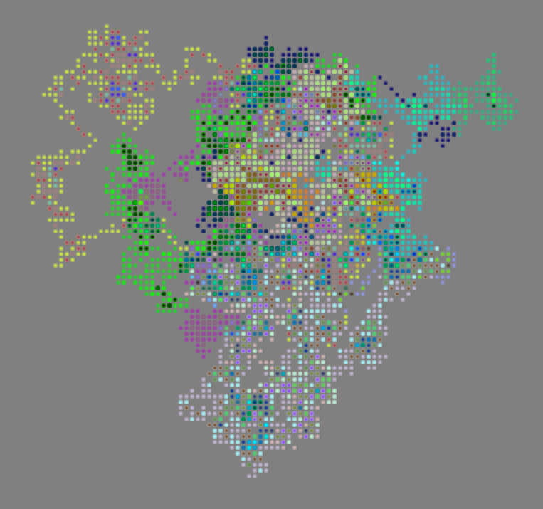

In the second example we start another walking, but with a new property: each time the color of object changes to reflect how many times that place was reached:
Start ZBRUSH
Load Zplace2
Select Sphere 3D
Set DrawSize to 5
Now select this color R=255 G=255 B=255 (white)
Set sColorR = sColorG = sColorB = -10 (grayscale). You can see the selected colors in the palette.
You can see the sphere3D random movements on canvas…with different color where is located multiple placements.
Some hints:
Try with different objects (3D, 2D 2.5D tools), different _MoveX and _MoveY values, different color ramp, etc
You can overlay two or more “walking” with different Z…then render with shadow
To obtain a ‘regular walking’ you must have _MoveX = _MoveY = DrawSize/2
If sColorR = sColorG = sColorB = 0 the ‘walking’ is monochromatic.
You can stop the ‘walking’ by pressing 'ESC, press ‘w’ to show the GYRO, move the object and restart ‘walking’ with ‘Ctrl-W’.
Use a 4096x4096 canvas with Drawsize=8 and _MoveX = _MoveY = 4 for best result.
With high mumber of iterations the procedure will draw strange regular pattern…

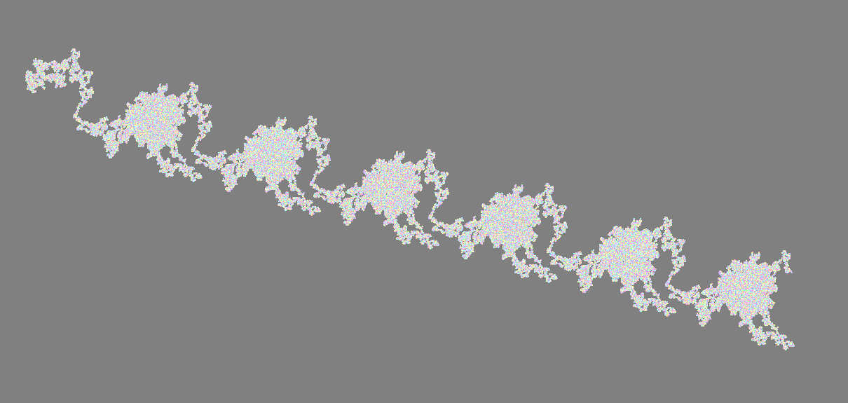

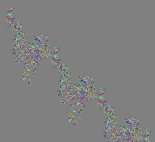

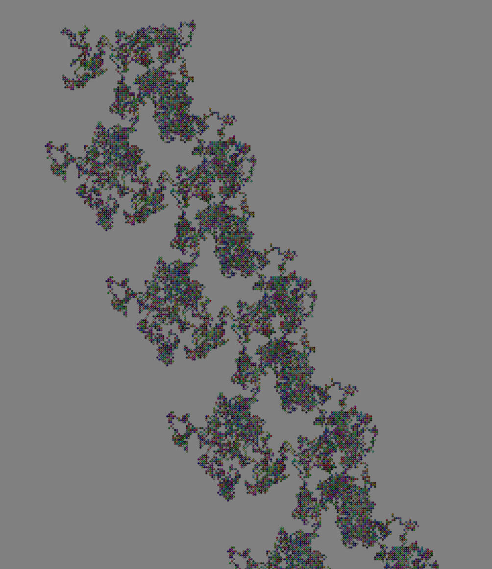

Here is some examples:
Thanks for try.
cameyo

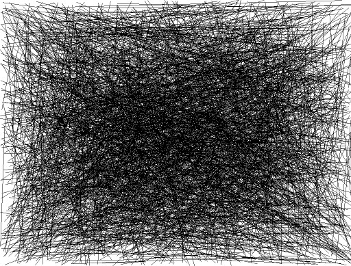

Just drawing a line with Startline and Endline with Pilou randomizing
Something like that :slight_smile: (it’s not pseudo code this time, it’s real code :slight_smile:
open window 1040,778 …// open a graphic window
N = 0.2561 …// initialize N to a number <0
for T=1 to 2000…// draw 2000 lines
N = (( N + pi ) ^ 5 ) - int(( N + pi ) ^ 5 ) …// the Pilou randomize system (thx Jp-Petit)
X = int(N1040) …// Xposition of the Startline
Y = int(N
778) …// Yposition of the Startline
X1 = int(N1040) …// Xposition of the Endline
Y1 = int(N
778) …// Yposition of the Endline
line X,Y,X1,Y1 …// draw a line
next T
Seems uniform and regular :wink:
Pilou
