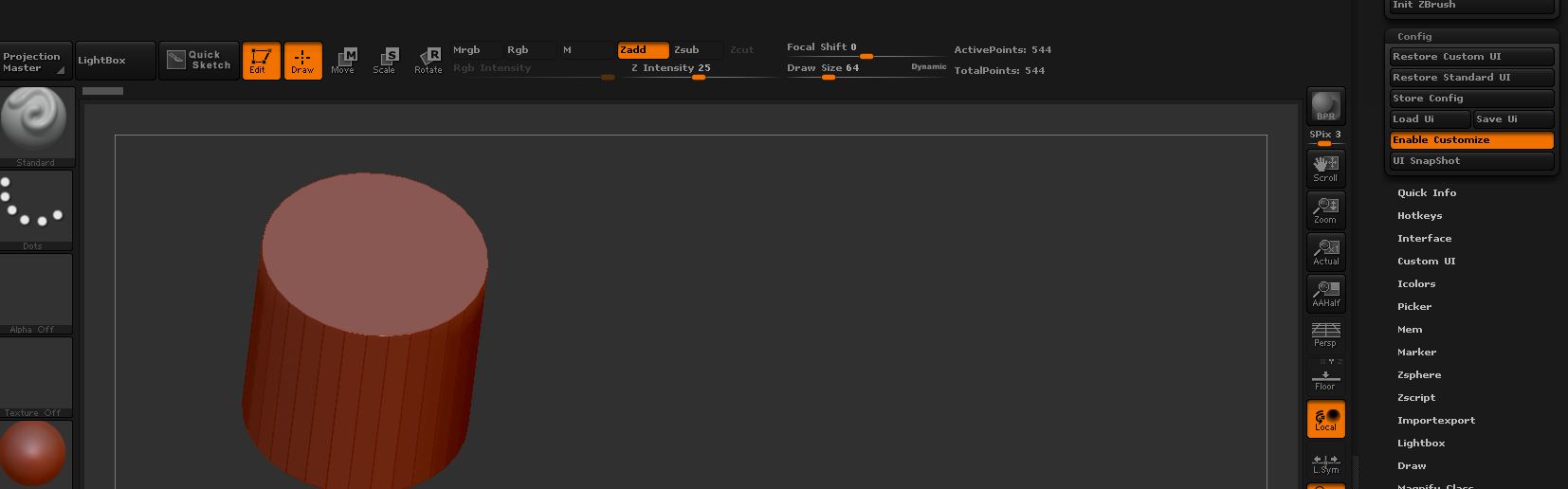

  1. Go to the Preferences Menu/Config and turn on Enable Customize Button.

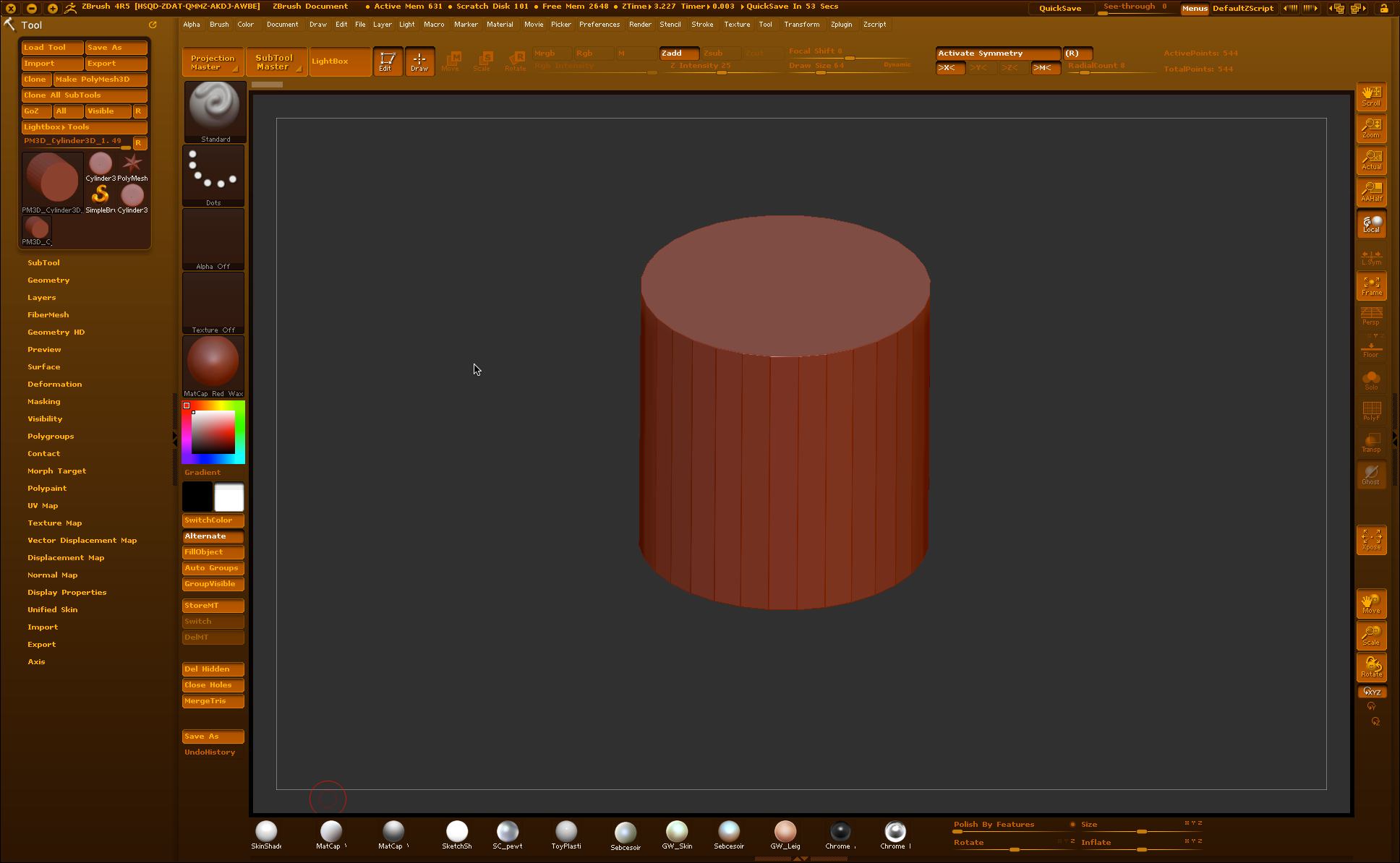

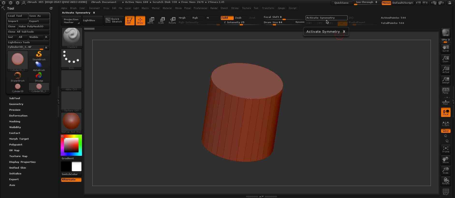

  2. Select a 3d Primitive like the Cylinder and draw it on the Canvas and turn on the Edit Button.

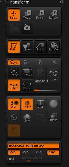

  3. Now if you go to your Transform Menu you will see that the Activate Symmetry and all of it’s Options can now be used where as if the Cylinder3D or other Primitive was not in Edit mode it wouldn’t be active.

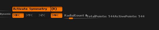

  4. Now grab each button and the Sliders one at a time over to the top of your interface

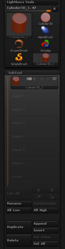

  5. Once you have all of your buttons lined up on the interface turn off Edit, Clear the Layer, go to your Cylinder3d (or the 3D Primitive you chose to use and go to the Tool/SubTool menu and hit Delete button and then hit Ok.

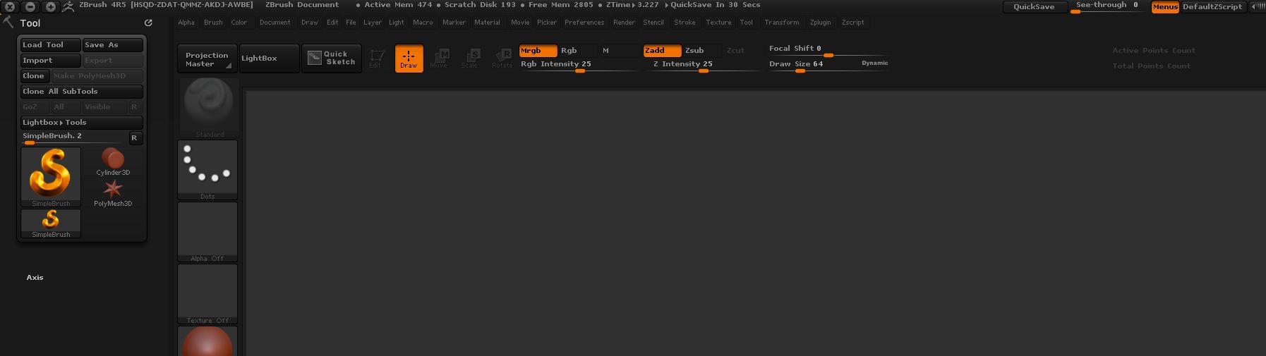

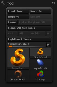

  6. Hit the Simple Brush in the Tool Menu and then hit the R (Reset) Button. This is so that it shows only the usual start up buttons.
  7. Turn off the Enable Customize Button

  10. Close ZB and open it back up. It will seem like the buttons didn’t work. To make sure they did select a Primitive again go into edit mode and they should pop up on the interface where you put the buttons.

If you find that they are not there or that some other buttons are missing try it again, you may need to remove other buttons that you do not need like the QuickSketch button up on the interface to make room for the others. Also Make sure that no buttons/sliders are overlapping by scrolling over the button or slider and see that the frame of the button/slider are not overlapping.
this one you can see clearly the overlapping of the Activate Symmetry and R buttons and the RadialSlider, Total Points and Active points which will cause some major problems.
