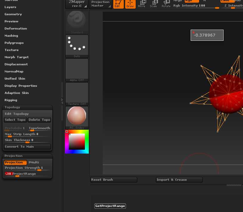

Francis,
  1. Click on the slider to make it active.
  2. Enter the numbers from the keyboard, pressing ‘-’ first for negative values.
  3. Press the ‘Enter’ key to enter the value.
The image shows the result of my entering -.378968 this way and getting the value with my script.
EDIT: I presume that sometimes negative values will work better than positive but it will depend entirely on the nature of the mesh and the relationship between subdivision levels.
