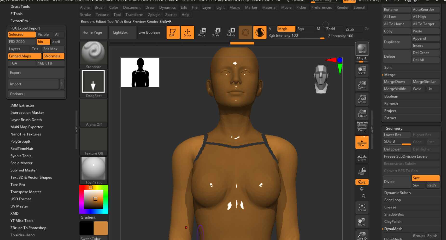

I trying to import an fbx file with a view to adding texture maps to it. It’s a female form which is split into subtools such as head, arms, legs and torso. If I subdivide the individual subtools, the geo is nice and smooth but they split apart, leaving a gap inbetween each one. I can then add the texture maps to each individual subtool however I can’t then knit the whole model back together.
I tried using zremodeler brush but couldn’t make it work, looked at bridge brush but I think that’s just for bridging circles rather than irregular shapes.

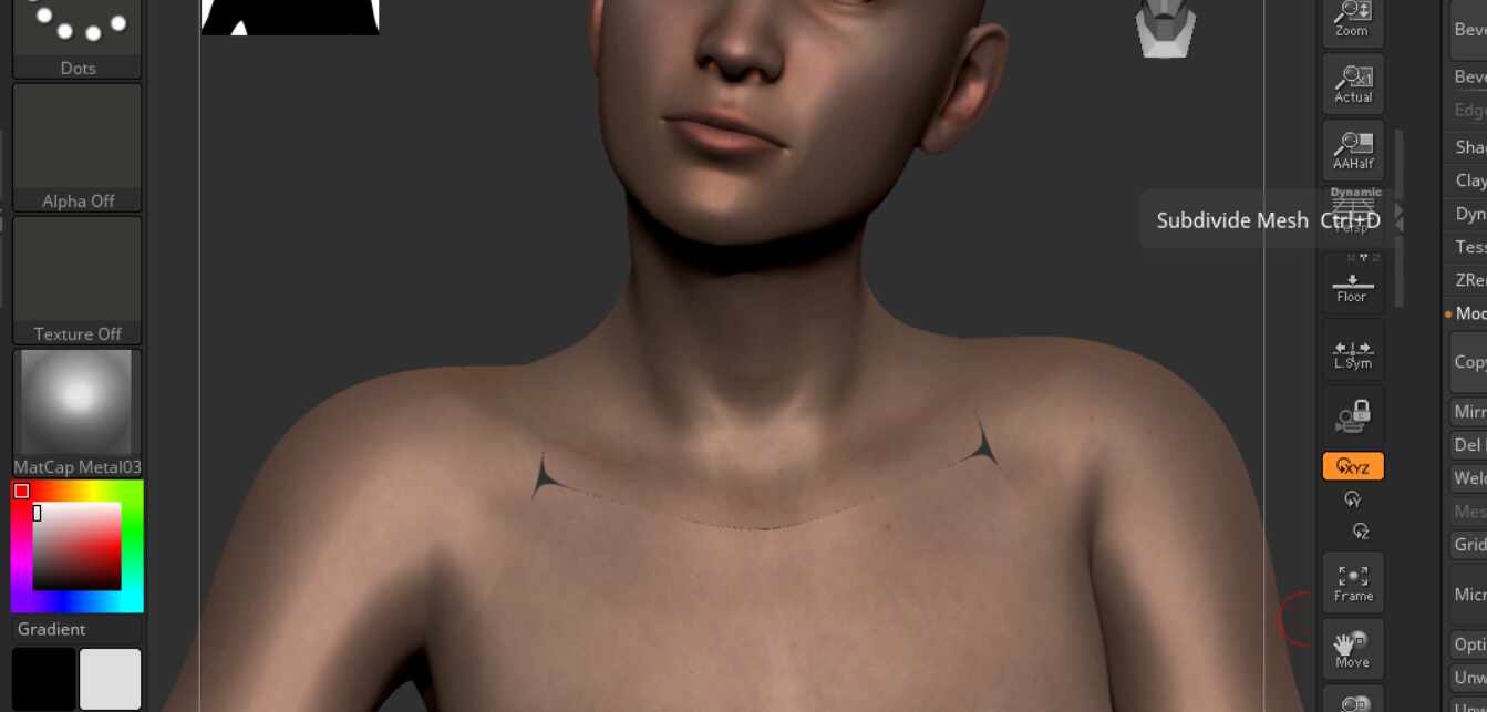

The gap is reduced but not gone but we’re getting there! I tried on this OBJ rather than FBX (not sure if that makes any difference at all) but still get little gaps as you can see:
Not quite sure how to use the ‘weld points’ to get the desired effect! (and keep the texture on).
Grateful for your help :slight_smile:
