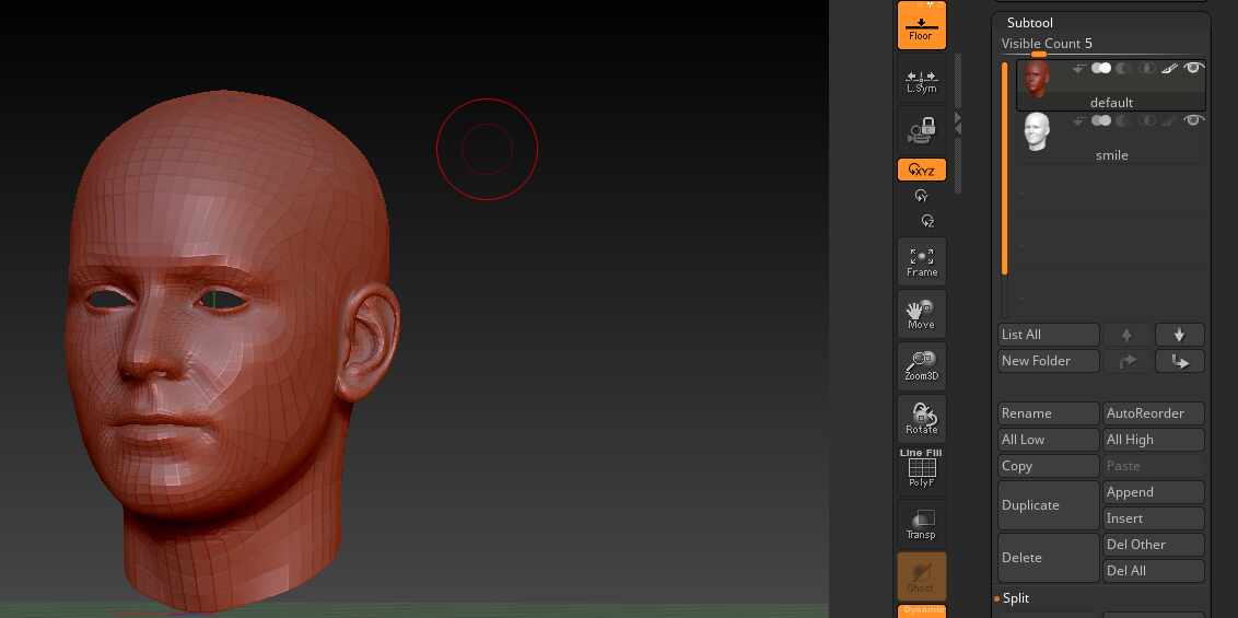

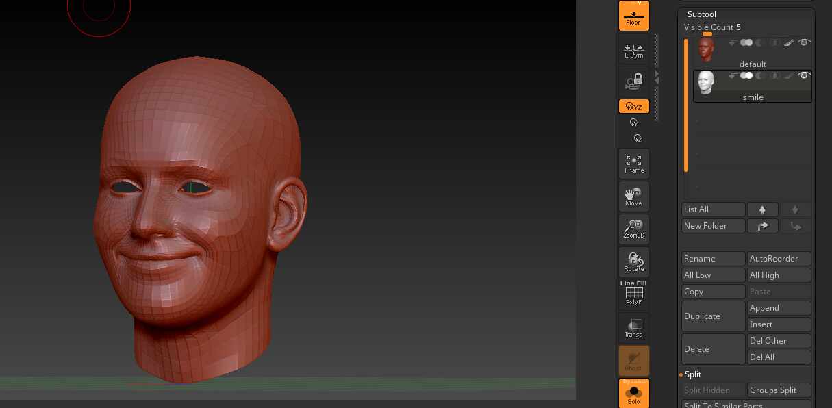

i have two meshes ( same topology) default and smile
i would like to merge them for making blendshape.
how to add “smile” model to the default model’s layer as a blendshape node with zscript or macro.

As you found, ZBrush does not support importing Blendshapes from FBX. You can do it by hand, using OBJs:
  1. With your model imported and selected, create a new Layer in the Layer palette. Record mode will be on.
  2. Press tool>Import and select the OBJ that you want to use as the Blendshap. It will be imported into the new Layer.
