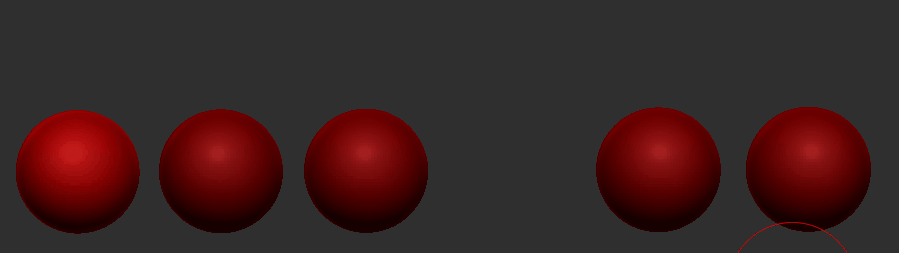

Here a little gif that illustrates that behavior (the number is the mod of the current subtool).
