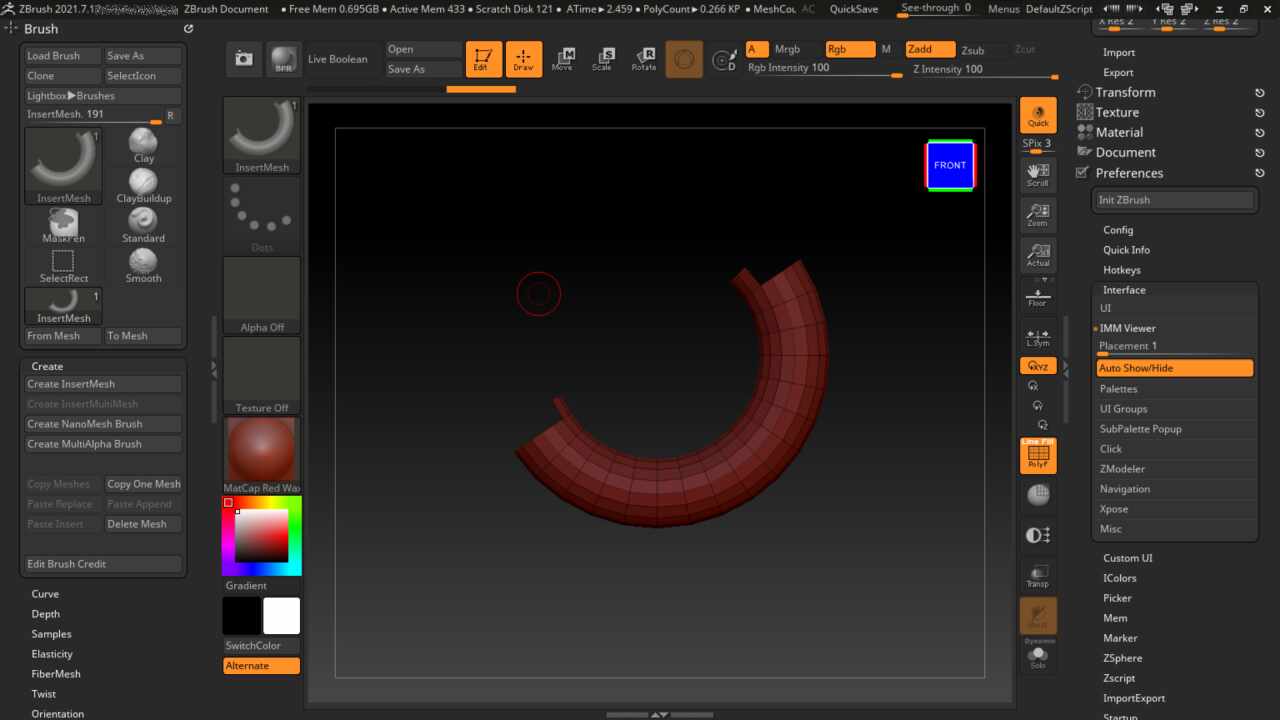

My question is about the moment at 8:20 in, the InsertMesh brush is created and ZBrush shows both the InsertMesh brush but also shows the IMM Viewer at the top. Whenever I repeat these steps with 2021.7.1 I do see the brush but I don’t get to see the IMM viewer on top.
I checked my preference setting (Preferences => Interface => IMM Viewer) but just to make sure I also renamed the “ZStartup” folder to force ZBrush to start in a pure vanilla state. But even in this state the InsertMesh brush shows up, but not the IMM viewer.
Despite the preference being set to default (Placement set to 1, and Auto show/hide is enabled).
I can’t help the feeling that I’m overlooking something obvious but can’t put my finger on it. Do you have any idea what could be happening here?

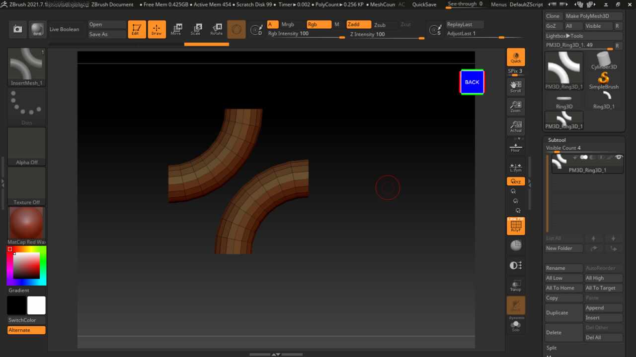

Here is what’s shown on my screen:

Thanks for the feedback but unfortunately this doesn’t seem to work… if I follow the tutorial exactly, so including duplicating and then ‘re-merging’ the subtools, I get the exact same result:
The insert mesh brush is shown but the IMM viewer never pops up. As I mentioned above: this applies to my custom interface, but also happens whenever I reset everything back to default.
Does the viewer appear when you load any of the default IMM brushes? If not, then there is an issue related to either your installation, custom UI, custom preference settings, or display resolution. If it appears for those but not with the content you are working with then I would suspect an error in your process or an issue with the content.
Your UI looks atypical. Please note that to test issues related to a problem UI, it must not load with the program. Loading a problem UI and then switching may not clear all issues. Restore the default UI then store the configuration with Preferences> Config> Store Config, and restart the program.
Additionally, these are the default settings for the IMM viewer. Please revert these if they have changed in the program, store the config and restart.

I notice in the last screenshot you posted that your IMM brush still only reads as having 1 mesh–that little number 1 in the corner of the brush thumbnail. The viewer will not launch for a brush with a single mesh.

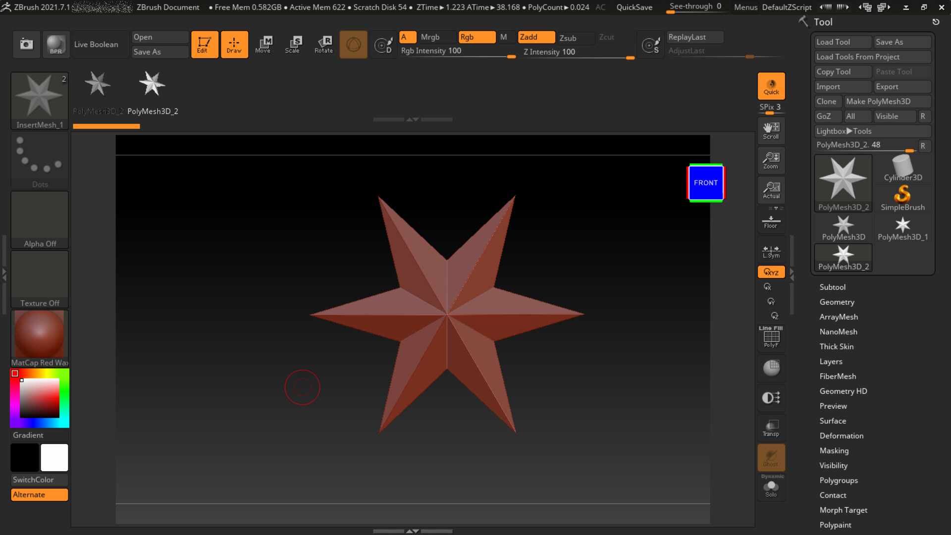

  1. Select the default polymesh3d star from the tool menu, and in Edit mode position it on the screen as desired, and select Brush> Create Insert Mesh Brush with the “new” option selected when asked.
  2. Now, with the star still active, select “Create Insert Mesh” brush again. Since your first single mesh brush should still be active, it will ask if you want to create a new brush, or append it to the existing one. Select “append”.
This will add a second instance of the star mesh to your brush, creating a multi part brush. The viewer should now appear.
Please let me know if your experience matches what I have described.

Loving it, thank you so much. I highly appreciate this.
Ok, for contexts sake I started this with my custom environment because I also wanted to make sure that the behavior I described above wasn’t caused by my own doing. My plan was to reset ZBrush if this procedure failed (and then try again), but it worked like a charm:

I also think I finally understand what was causing my issue… You already mentioned it above though: 2 meshes. But I misunderstood: I figured that I used 2 meshes in my last screenshot because there were two separate sub tools, so nothing merged. I assumed that this was the needed difference from the tutorial (they merged sub tools).
