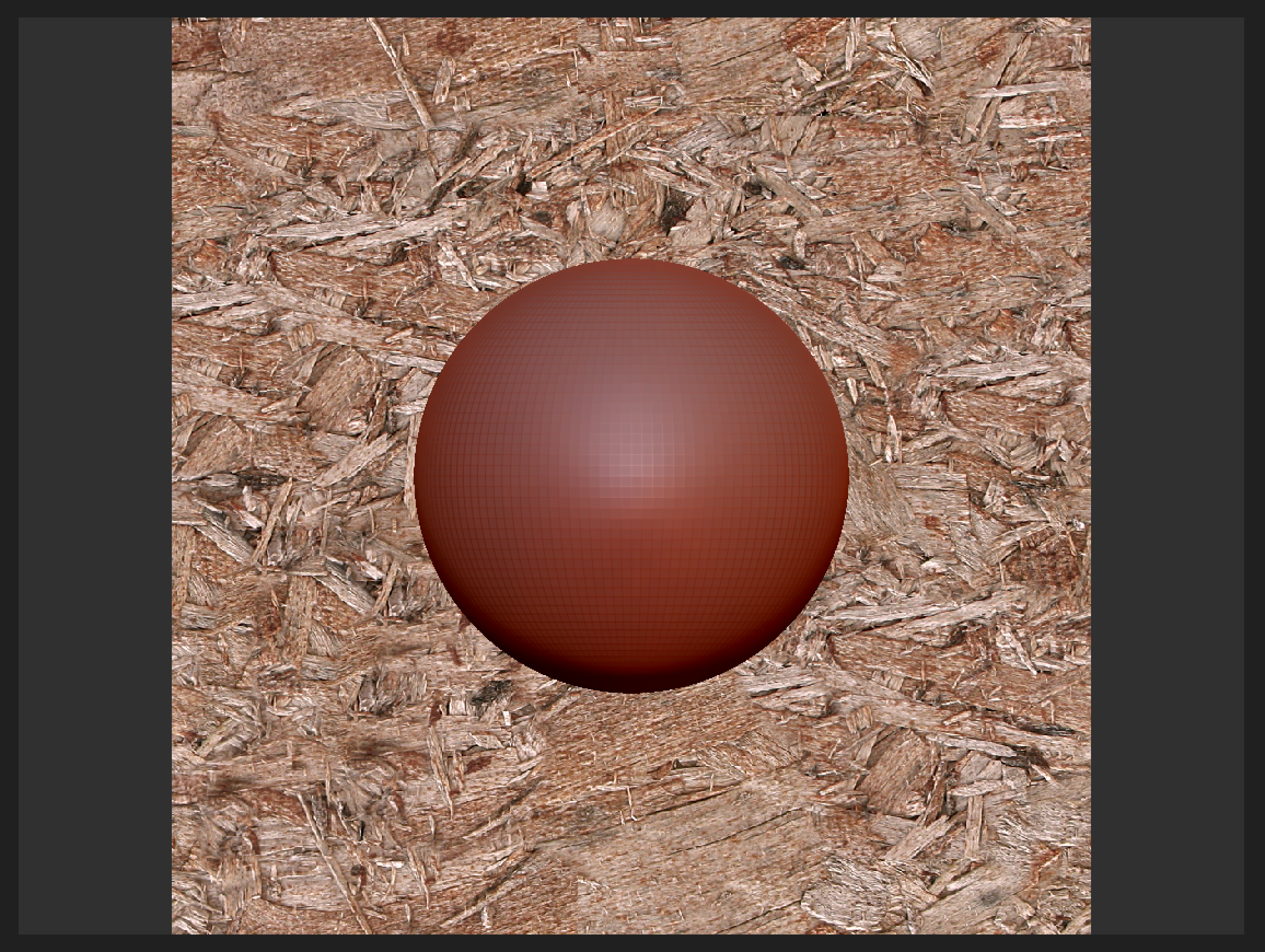

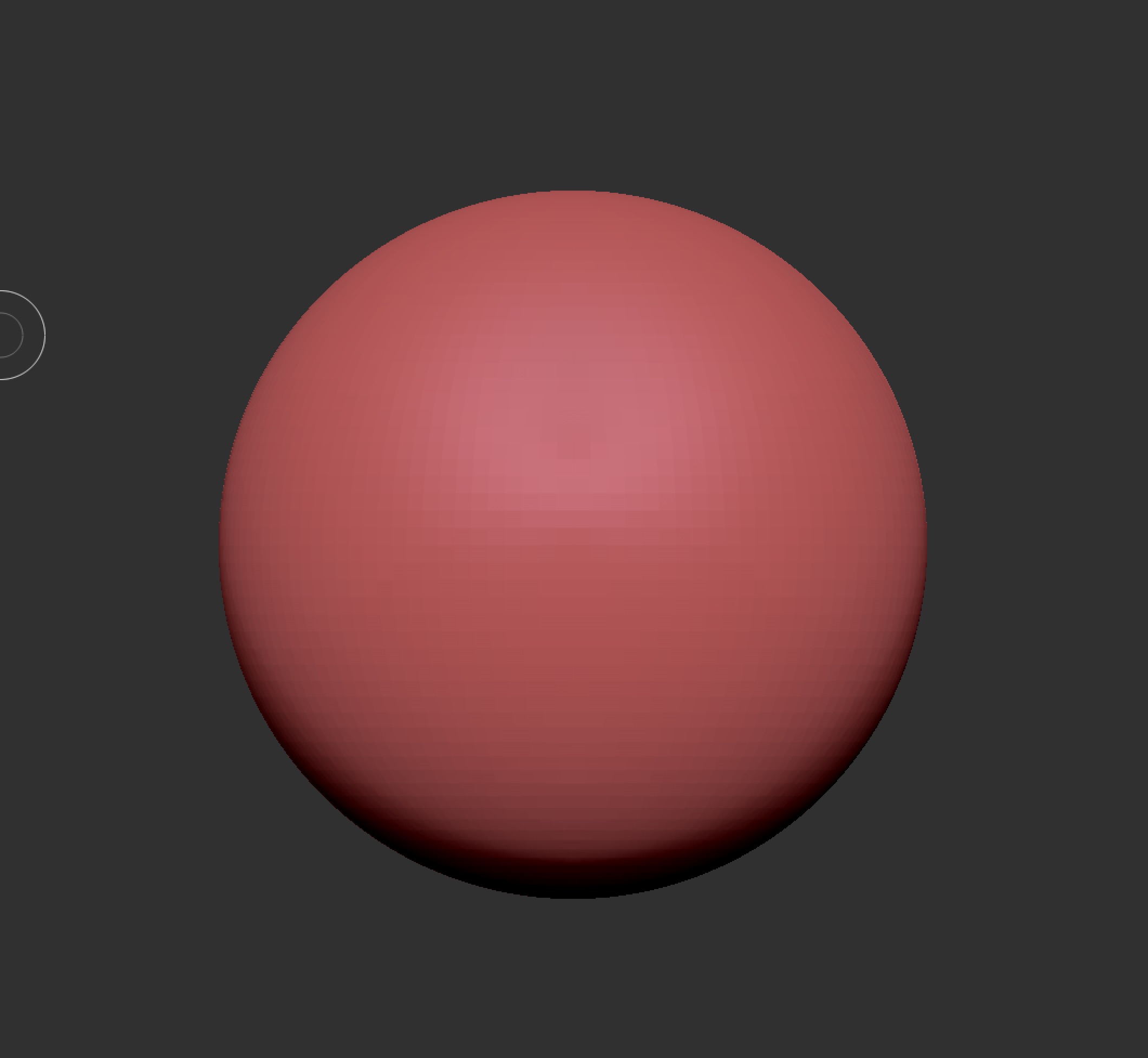

When I initially load an image into a view, it all seems fine. I line things up and hit Store View, go to the next view and repeat. When I go back to a saved view, it appears as though the image is gone. (Image 2)

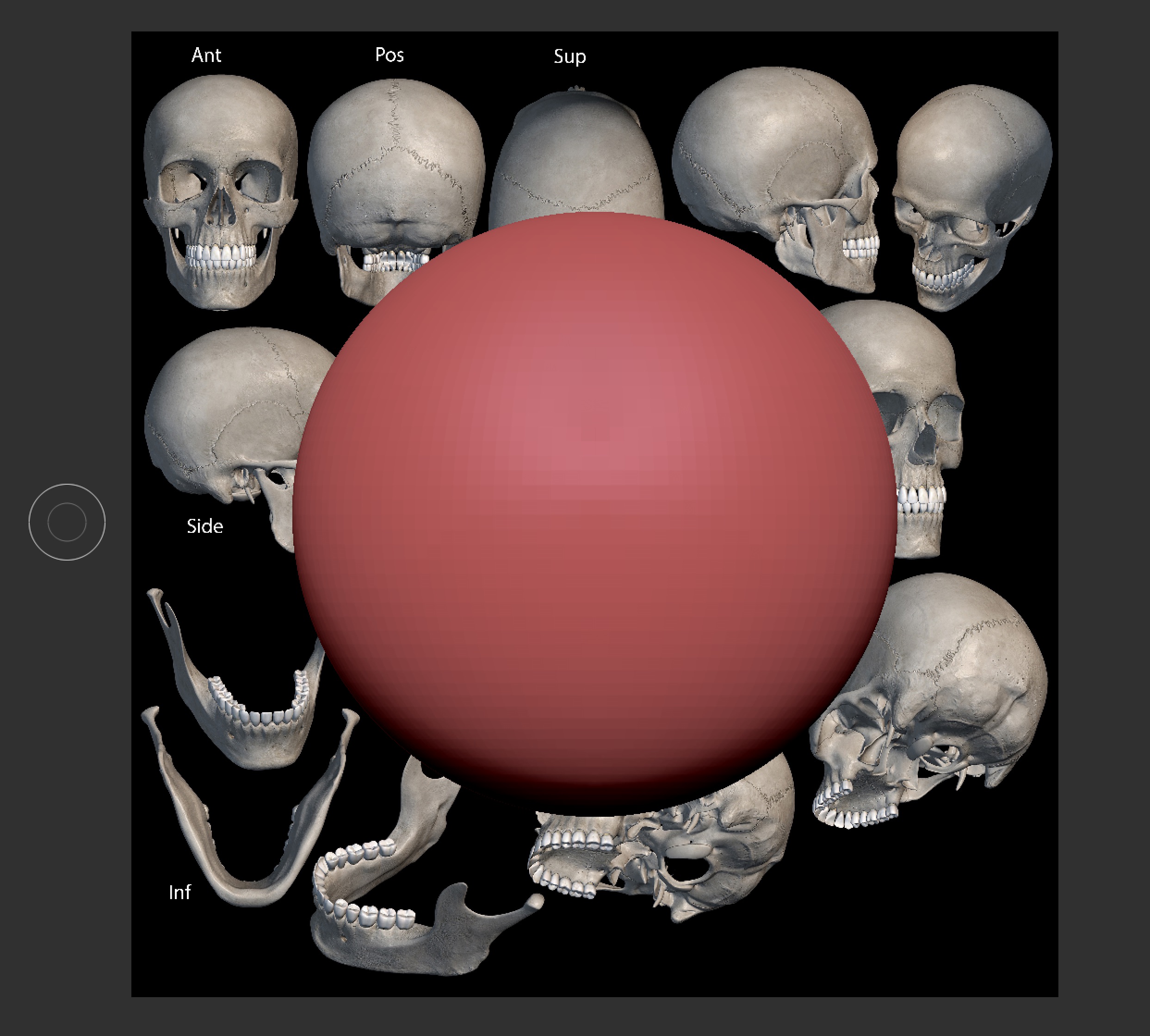

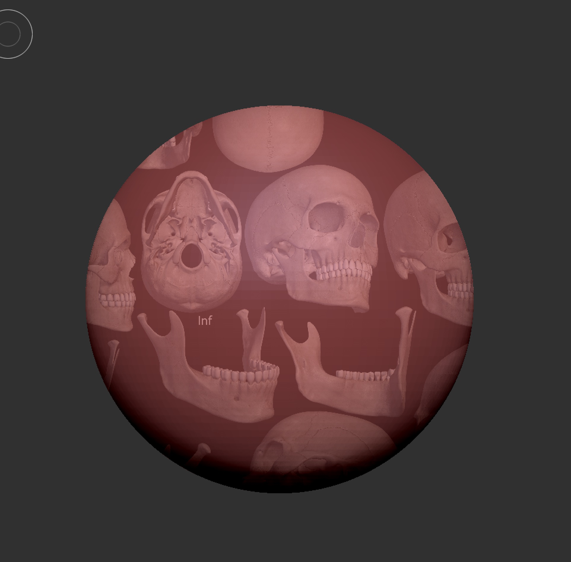

However, if I turn the Model opacity down, I find that image is visible behind the model and only behind the model. (Image 3)

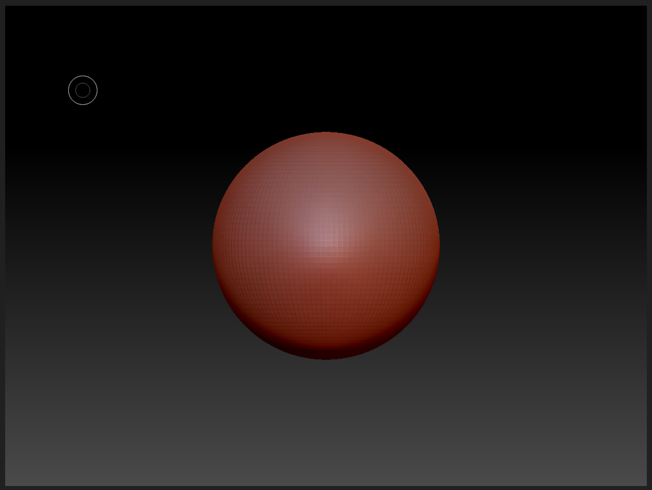

Here’s an interesting thing, during the very first launch after finishing installation, the Image Plane reference views work as they should. There is one thing I saw though. The default document still had the gradient background but when applying a Image Plane, the non-image, canvas area, appears solid gray. (image 1 & 2)

background gradient is gone on Image Plane with Reference present, gradient is still there on all other plane views

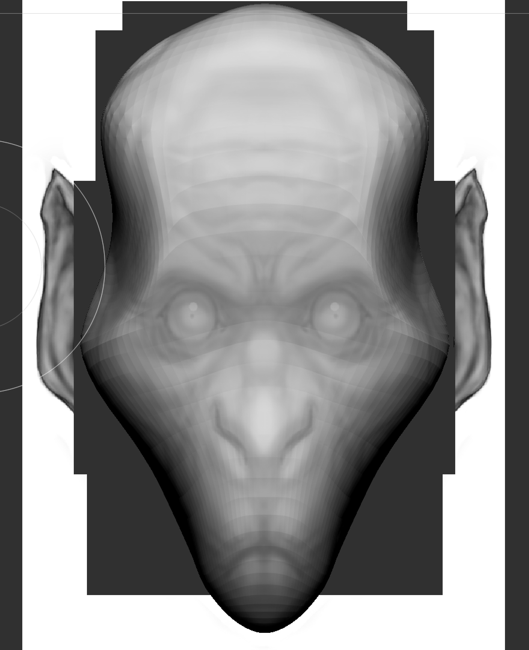

Thank you for all the help! I downloaded and installed the 2019 version of Image Plane as you requested. It does stop the transparency problem but now I’m having the old documented problem of gray squares showing up behind the mesh but over the reference whenever using the Move brush or smooth. Doesn’t happen with Standard or Clay. I remember this being an issue before.
11%20AM
Yes, I’m sorry to say you will get that with the 2019 version.

For ZBrush 2020, the ‘L’ button under Texture>Image Plane>Reference Views allows you to use Legacy mode so that subtool ghost transparency will work (though note that with this mode the problem where the image is temporarily erased when sculpting the edge of the mesh will return).
