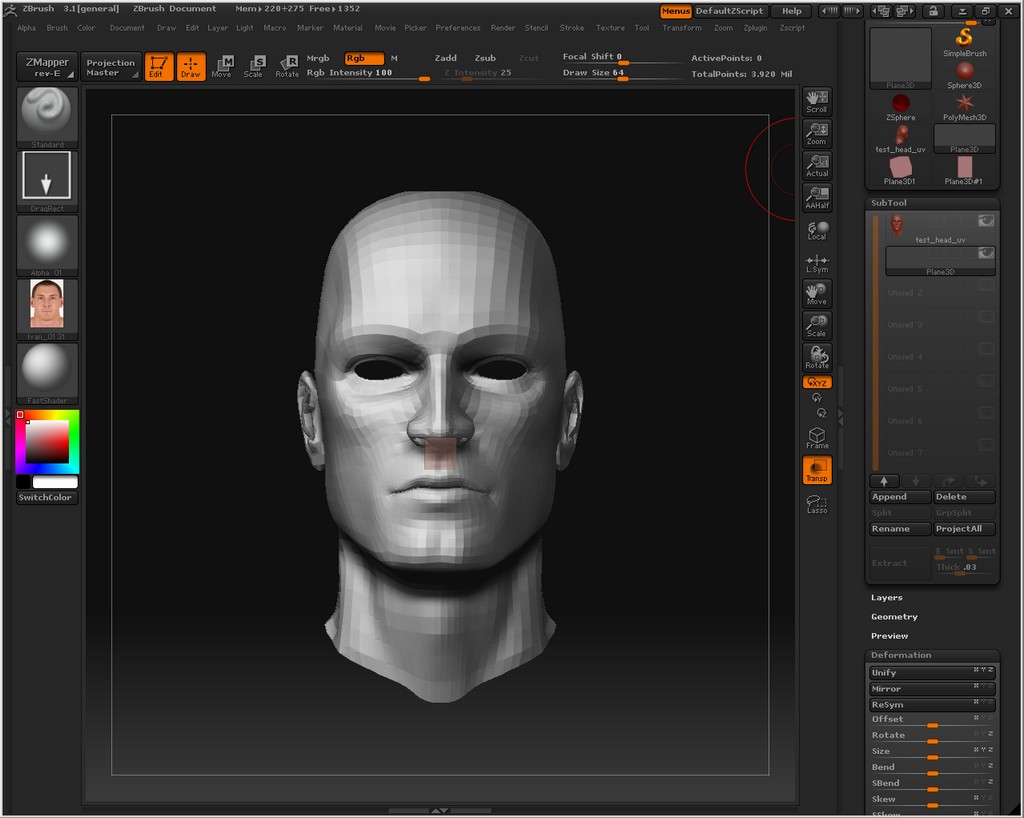

So after doing the whole process about 15 more times I noticed that in the menu above the subtool menu, that the image of my model gets replaced with a plane3D image when I go to hit the texture button to load the texture onto the image plane, even though I have the Plane3D subtool selected. Is it supposed to do that? And when I hit both subtools several times to see if it will correct itself an image of my model will appear above but it’s labeled Plane3D.
Then when I go ahead and apply the texture to the image plane and go to deformation to size it the Plane3D subtool vanishes from the menus.
I’m starting to think the Zbrush gods really hate me.

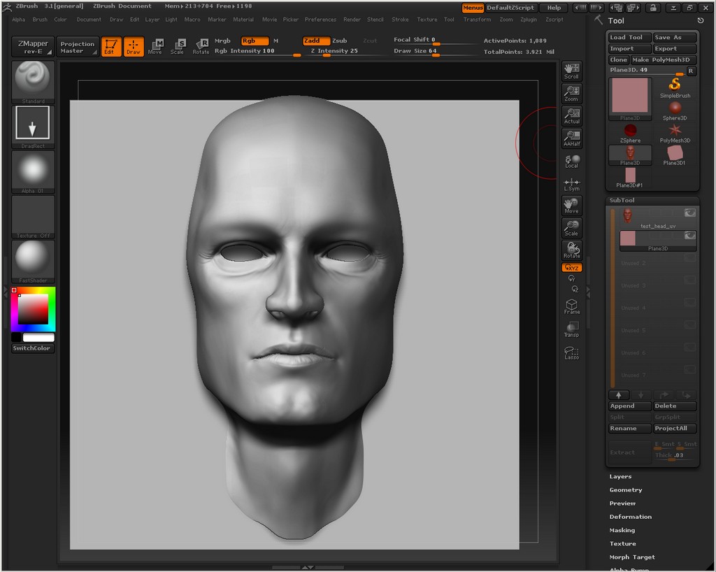

I just realized it’s my 3rd day trying to get this working right. So I installed Zbrush on another computer to see if it would do the same thing and make sure it wasn’t just my computer. It did the exact same thing.
As you can see in the image when I go to use any of the sliders in the deformation menu the image plane shrinks or disappears all together on the canvas, and if you look in the subtool menu and the menu above it it’s gone as well.
The only thing I can think of is that I’m missing a step that’s not in the tutorial and I’m too much of a newb to realize it, or, it’s only stable in the 3.0 and not the 3.1 version. I have no idea how I got it to work that first night if only for a minute.
And sorry for the multiple posts.

I’m sorry you’re having problems. I haven’t been able to reproduce this exact issue but I do know that some have had problems with appending the plane as a subtool. I am trying to find a way around it for the plugin update but for a workaround, see below*).
I did notice that you are selecting the wrong plane to append. The Plane3D tool is the default one, whereas the correct one will have the same proportions as your image. In your last picture it is named Plane3D#1. I don’t think this is what’s causing problems but you will find that the image will be stetched to fit if you don’t choose the right plane. (I probably need to update the tutorial on this to reflect the changes in 3.1 .)
Although the Projection Master way is a good one, the advantage of the subtool method is that you can ZProject-polypaint just those details you want.
*You may find that this method solves the problems you are having:
  1. Load your model and enter Edit mode.
  2. Press Image Plane button to load the image on to a plane. It will be placed behind the model.
  3. Switch off Edit mode and clear the canvas. Select the Simple Brush from the Tool palette and draw a few marks on the canvas. This is very important.
  4. Select your model again but DO NOT draw on the canvas. In the subtool submenu press Append and choose the Plane3D#1 or whichever from the popup.
    Select the plane3D subtool in the subtool list.
  5. Now draw your model on the canvas. Press T to enter Edit mode (also Ctrl+N to clear the canvas of the Simple Brush stroke).
  6. You should now be able to adjust the size of the plane using the Deformation slider and proceed with the rest of the method.
