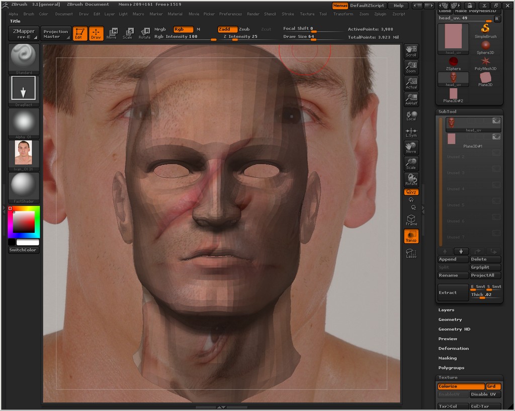

This is my first time using Image Plane 3. I’m following the tutorial to the letter but when I get to this part of the tutorial I’m not getting the results I should be getting–>In the Tool:Subtool subpalette, click Append and choose the Plane3DCopy from the popup (Note it will have a number such as ā€˜Plane3DCopy1’). There may be several Plane3DCopies - choose the last one in the bottom line.
Select the new Plane3DCopy subtool then apply the photo reference to it by choosing the Image in the Texture palette popup.Switch off all subtools other than the Plane3DCopy and the target mesh.
Switch on subtool transparency by pressing the Transp button in the Transform palette. You should now be able to see your photo reference through your target mesh.
[color=Lime] I’ve tried several times now and keep getting the same thing. I’m not getting the ā€œTexture palette popupā€ as it says in the tutorial, so I just go to the texture menu and choose it.–>
Well, turns out I was selecting the wrong ā€œPlane 3Dā€. I was selecting the one with a number, like the tutorial said, it was called Plane3D#1. The one that worked is just plane ol’ ā€œPlane3Dā€. :roll_eyes:
