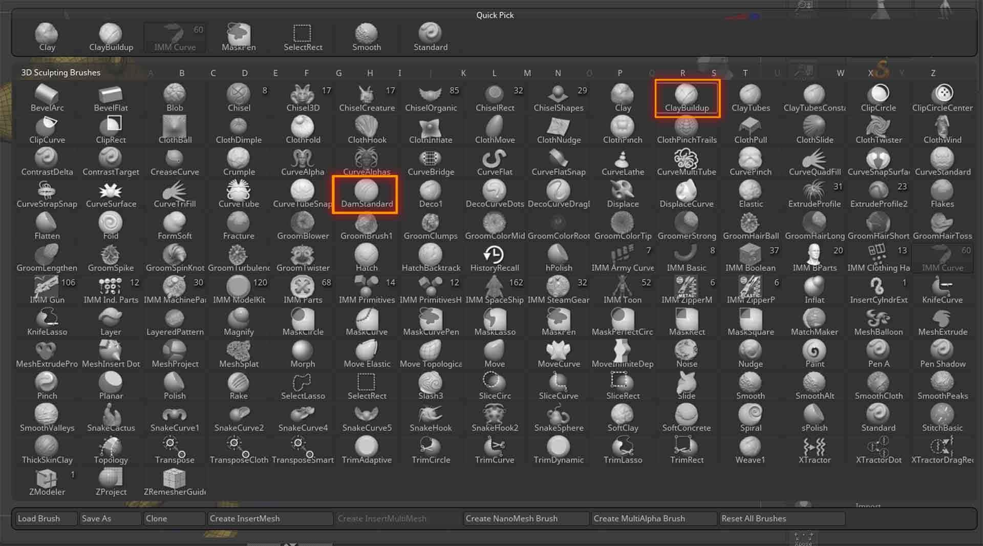

Please restart ZBrush, and load the dog.zpr from the Lightbox Projects folder. This should load a file with the 3d dog mesh already in Edit mode. Press the ‘B’ key to activate the brush selector pop-up. The brushes you are looking for should be in that pop up alphabetically.
brushpopup
If they are not, please post an uncropped screenshot of your entire interface here with the brush pop-up open. If the brushes are not present in that menu, then there is likely an issue with your installation, and I’m going to refer you to Pixologic Support for further assistance.

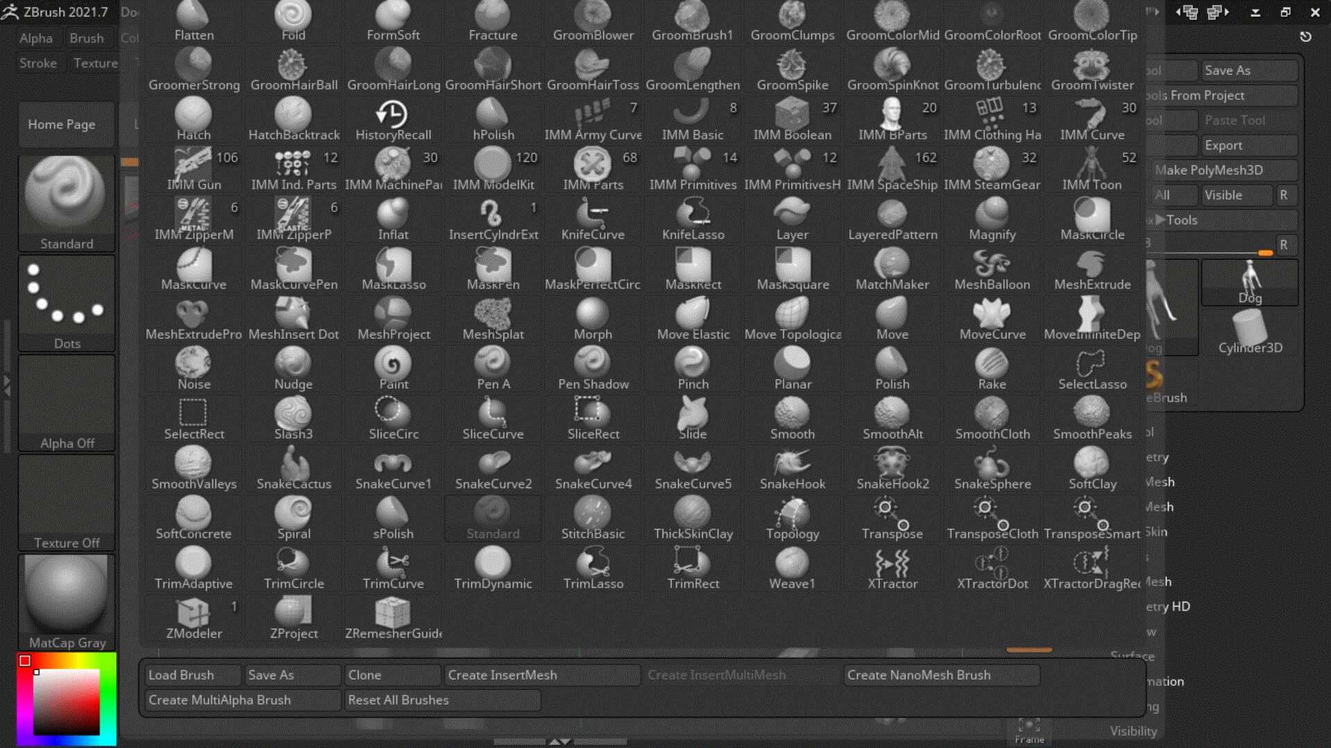

Screen capture @Spyndel thank you for the fast reply
I’ve tried as you offered but your solition doesn’t work for me :frowning:
I’ve add a screen captured image
Also I’ve uninstall and re-installed Zbrush but nothing has changed…

The top portion of the Brush menu is being cut off by the screen, likely due to running ZBrush at a display resolution below recommended spec. It is inconclusive as to whether the brushes are actually there, but I suspect that they are. You simply can’t see them.
The brush shortcut combo (by default ) for ClayBuildup is B-C-B.
For Dam Standard it is B-D-S.
This may allow you to select the brushes directly, but your UI issue is a separate matter.

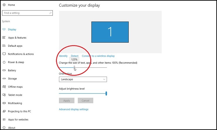

My monitor supports 4096x2160 and 3840x2160 resolutions but the problem was not resolution
So I’ve changed the other option as %125 at the top of the same panel
I didn’t notice that screen preferences panel issue because when this issue happens also causes hotkeys malfunctioned…
Thanks for the help :slight_smile:
