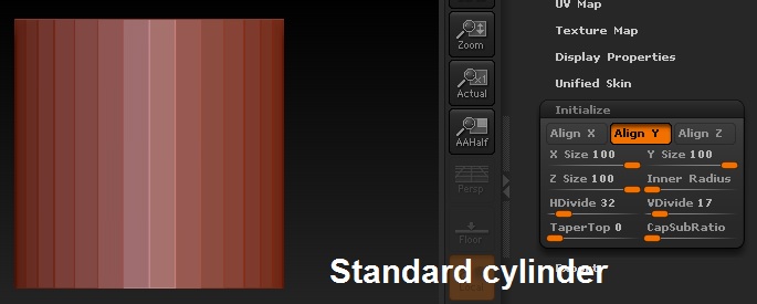

  1. Draw out a primitive cylinder
  2. Go into edit mode
  3. Initialize to the desired diameter leaving length alone for now
  4. Adjust HDivide and VDivide to get nice square polygons

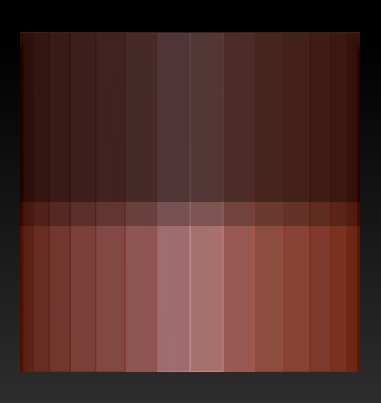

  6. Mask about 1/2 the cylinder and blur the mask several times

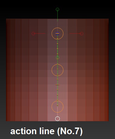

  7. Draw an action line from about mid way in the blurred mask toward the unblurred area holding Shift to keep it straight
  8. Holding Shift again grab the upper red ring of the action line and bend; this gives you a smooth bend but will introduce a buckleing effect.

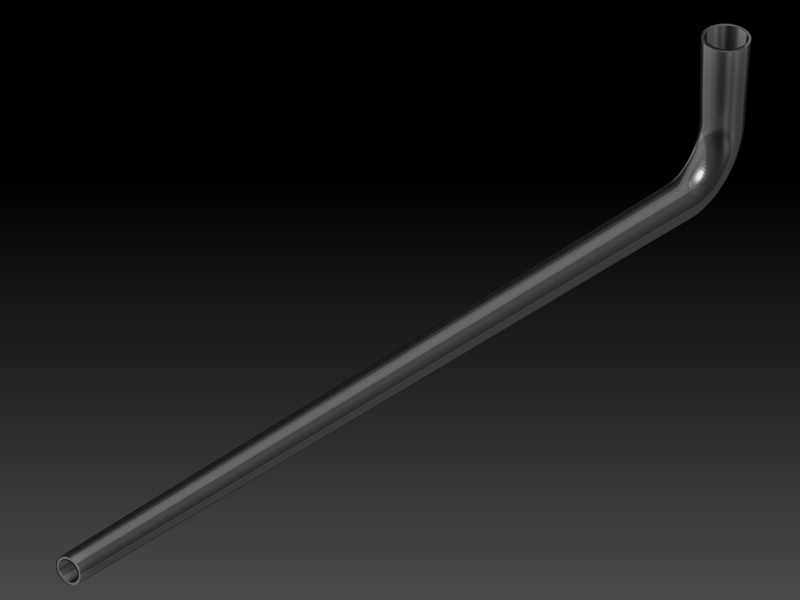

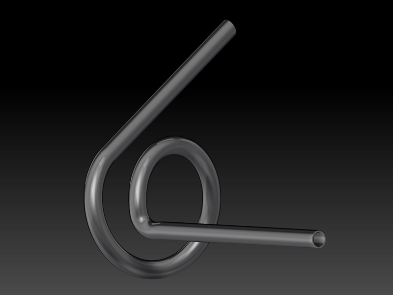

Here is a quick example of a tapered tube/pipe using the cylinder primitive

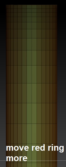

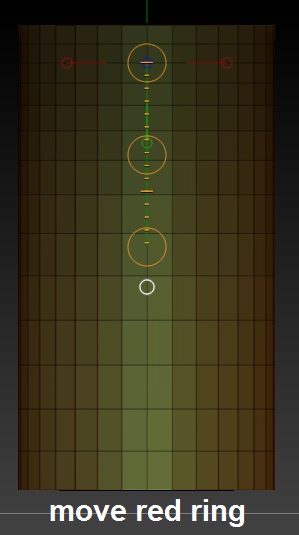

@DLangley
I want to make a stick without a bend.
Question to:
No.6 Masking top or bottom?
If i move the red ring my polygons are no more nice squares.
Whats wrong?
Do i’ve to do step No.6 and No.7 again in a loop, after moving the red ring?
Masking, moving, masking, moving… and again.
standard cylinder.jpgmasked half.jpgmask blurred 2x.jpgaction line.jpgmove red ring 1.jpgmove red ring 2.jpg
