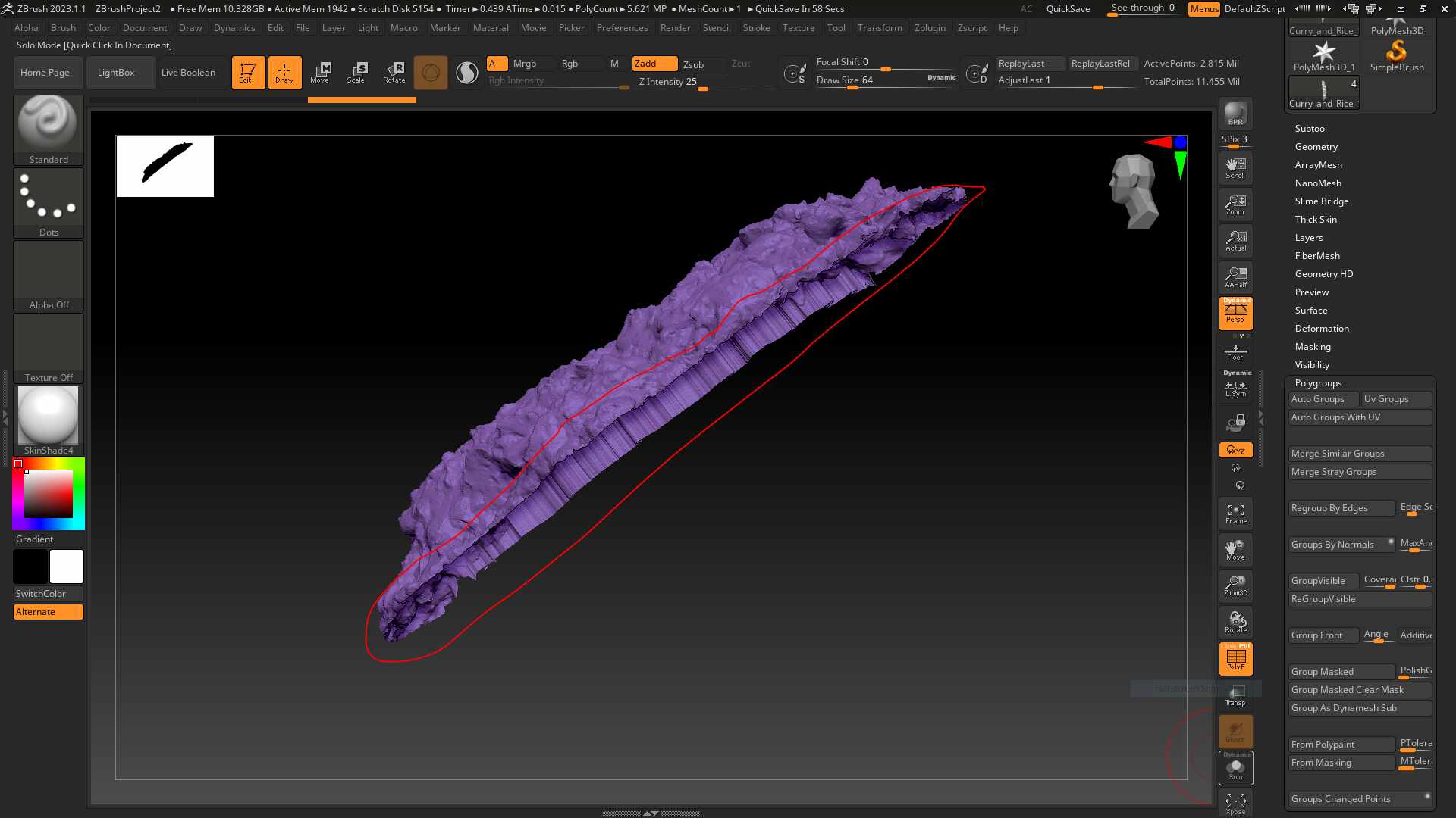

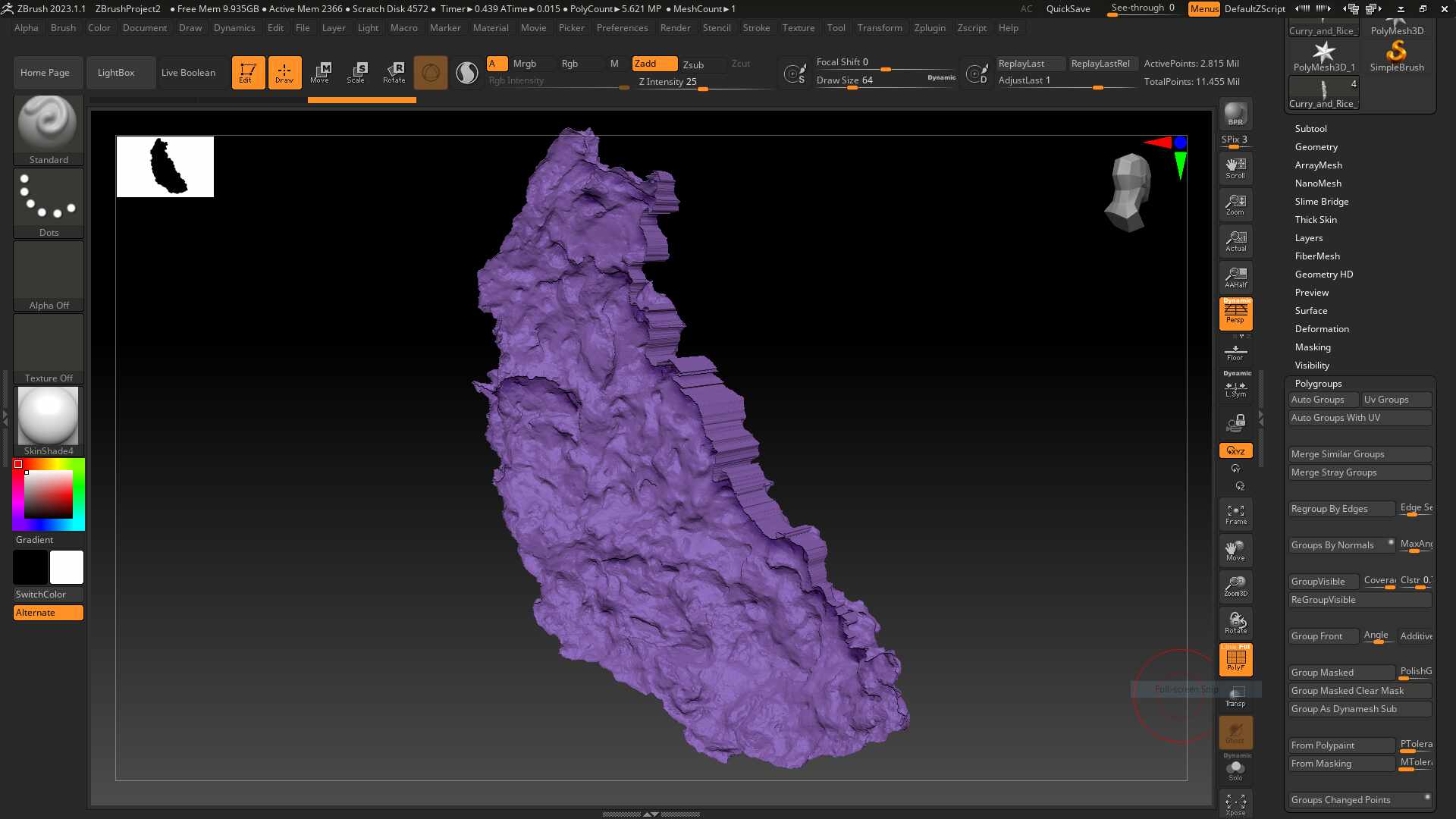

How would I create a bottom face for this mesh?
Hey there
I tried Dynamesh, hoping that I would get a nice face at the bottom to close this mesh, but unfortunately the mesh is too thin. Even when I thicken it using the extract tool, it doesn’t close the hole to form a nice base mesh in the way I would like it to. Any ideas on filling this mesh hole?
The object is a scanned curry. What need is a nice base. I don’t want a hollow mesh. Any ideas on how I could create this? Thanks

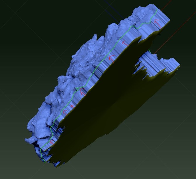

The only issue now is that I have this extension of the scan that I would like to eliminate. This is because I want to retain the edge of the scan, and the fact that the extension is not textured. (See photo). How would I bring the extension upwards while preserving the uneven edge of the original scan?
InkedWOOO
The scan is an odd shape so there is no simple geometric shape that will close the bottom. Think of a potato chip (crisp) and imagine what surface could close that shape without somehow extending the edges first. Also, even the original scan has extended vertical “walls” much like those created by the method I described, so it’s not clear whether they are to be included or not as part of the required edge.
Let’s assume you don’t want any of the vertical (“wall”) edges, even those from the original scan. So perform the steps outlined previously up to and including the Gizmo dragging of edges to make walls. Then it’s an easy process to box select the lower points/polys of the wall and delete them. Only the detailed curry scan polys remain. Polygroup this single sided surface. Then give it thickness by activating Dynamic Subdivision, set subdiv to 0, thickness to 0.001 and offset to -100 (thicken inwards). This will make a thin, solid body without any noticeable projection of polygons through the upper surface, except a few places near the edge. Click Apply to turn it into real geometry. Then Dynamesh, if required, to a high resolution (1500+). At this stage you have a solid with separate polygroups for the upper and lower surfaces and the thin side wall.
If you want a somewhat flat base then mask all but the inside surface and Gizmo move/scale to smash it into a planar surface as desired. That will introduce “walls” somewhere but that’s unavoidable if you want a flat base. You could then Dynamesh or Decimate this model.
Anyway, once you have a solid with polygroups for the upper and lower surfaces then you can do whatever you want (Decimate, Dynmesh, ZRemesh etc).
hth

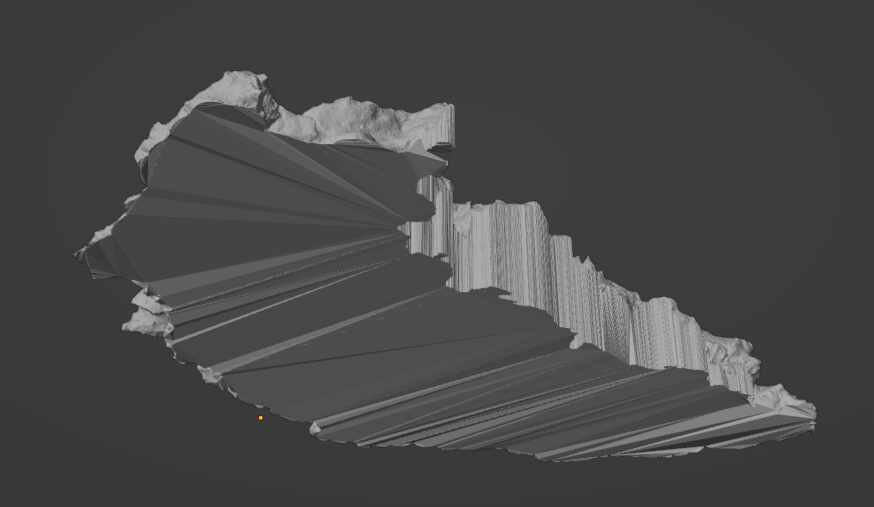

Thanks again for the detailed reply. I wanted to keep the vertical edges from the original scan. And to be honest I found that Blender was able to achieve what I wanted.
I selected a portion of the mesh and used the fill tool (F) to create faces. I did this about 6-7 times until I the base was filled. And then triangulated the faces (Face → Triangulate Faces). There were some strange faces created (hence why I didn’t fill the base all at once), but they’re unnoticeable, and if you take your time, you could probably eliminate all of them.
Here’s how it looks:
It’s not flat obviously, but it will be on a plate, so it will do. Most importantly, I have retained the original edges, so if you look at the curry from above, it’s shape is very realistic.
Now I can Dynamesh and Zremesh.
