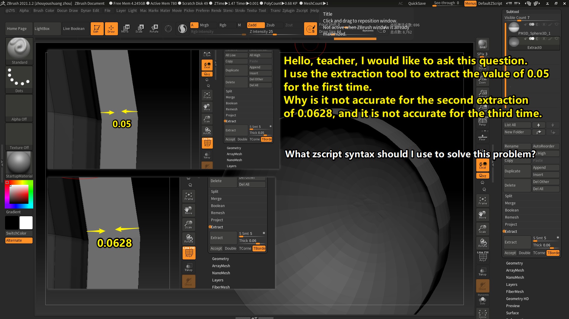

How to use zscripts to solve the exact problem of extracting values
Snipaste_2020-12-05_15-41-24
I’m not sure I understand your question. You can use zscript to set the value by using:
[ISet,Tool:SubTool:Thick,0.0628]
Does that not give you the value you want?
I’m sorry you didn’t understand what I mean, but thank you very much for your reply, I mean why zbrush Extract can not extract the same thickness repeatedly, for example, my ideal size is 0.2. The first time is accurate 0.2, but the second It’s not 0.2 this time, why?
OK, I see the problem now. This may be a bug in the program I will look into it further.
alright, thank you very much
Hello to bother you, can you get a solution to this problem now, thank you
I don’t have a solution. This is clearly a bug in ZBrush and will need fixing. There may be a way to reset the slider using zscript so that it produces the thickness you want but I have not found it. There appears to be some regularity to the extra thickness - for example, if you extract a thickness of 0.5 then the extra will seem be 0.25, 0.125, and so on but this doesn’t exactly transfer to other values, apart from the higher the value the greater the extra amount. With a setting of 1, the second extract is very nearly twice the thickness but not quite.
Thank you very much for your hard work
OK, I have found a solution. It turns out that the amount of extract is related to the bounding box of all the subtools. That is why the second extract is always different from the first - because the first extract extends the bounding box of all subtools.
I suppose it would be possible to calculate a correct extraction value based on the bounding box. But here is a simpler solution - the selected subtool is cloned, the extraction carried out on the clone and then the result appended back to the original tool. This gives consistent results.
