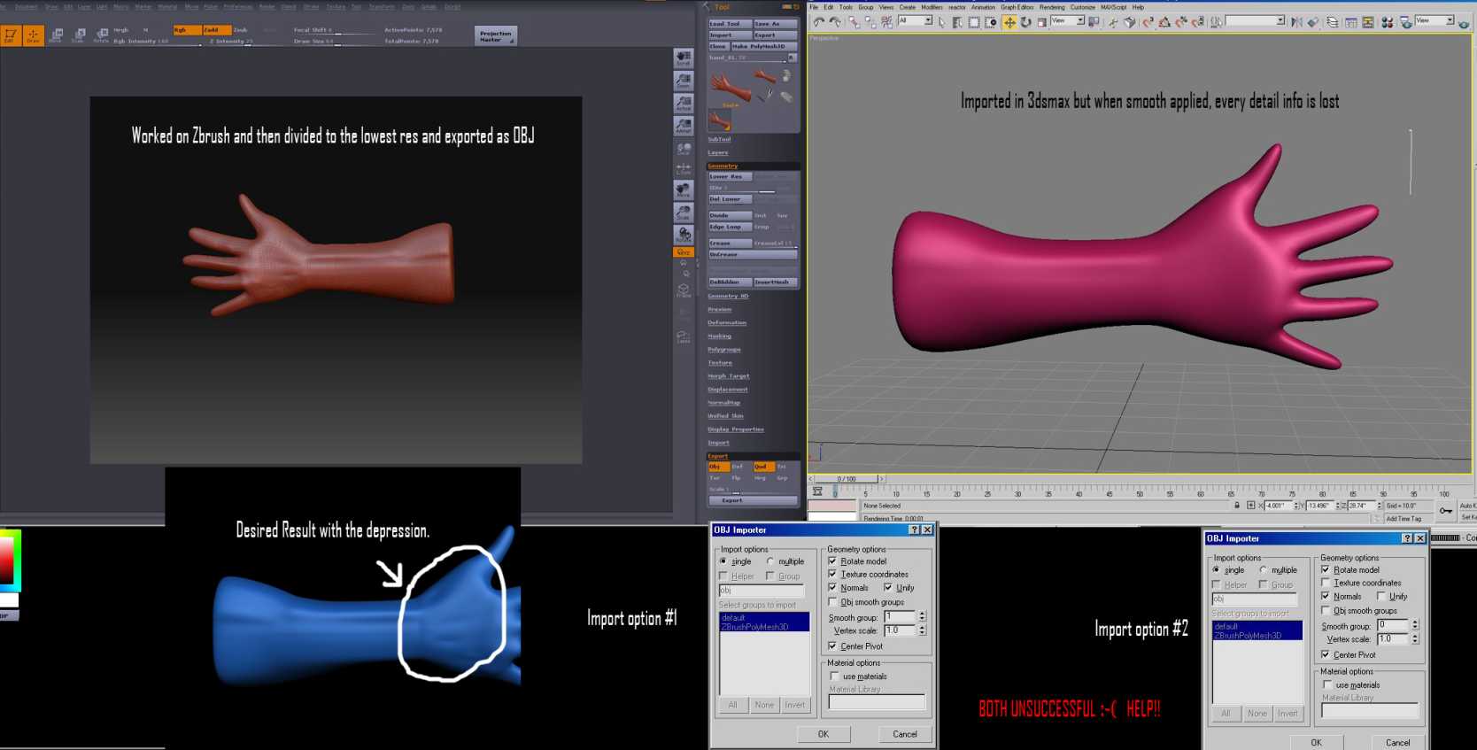

Since Im pretty new with ZBrush, even though I read most of the tips in the front page(whew, it helped me alot either way ) I dont know whether it applied to me or not. I modeled a basic hand in 3Dsmax and imported it to ZBrush, further detailed it and then subdivide it to the lowest poly and then exported it as an OBJ but when I open it on MAX, every detail is lost… :cry: …Is it supposed to be in a displacement form like you guys discussed it in the begining or am is it possible the way I am attempting and just did something wrong. I have the print-screen, a pretty detailed of my problem below. Thanks alot guys…My solution I know is here :+1:
you need to apply the zbrush texture as a displacement, see the beginners guide for more instructions, basically, export the displacement as a displacement map or normal map, then apply a bump>normal map in max, than select the map and flip it, should work ,follow the instructions at the start this thread (i think) and shouldn’t be any problems.

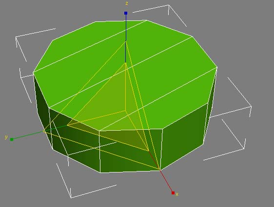

How do you export a cylinder out of max succesfully into zbrush WITHOUT it pinching!?

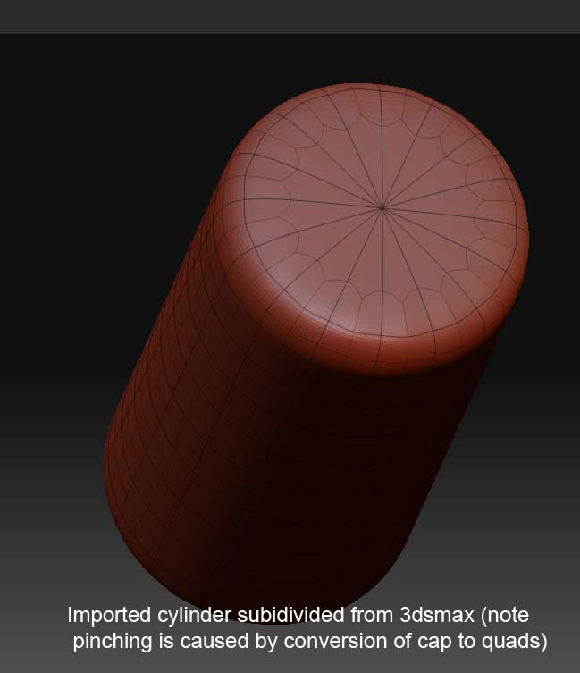

I’ve created a cylinder all quads except for the caps which are all tris. When importing to zbrush everything pinches when subdividing! ARgh! I’ve tried everything I can think of.

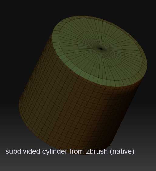

When using a standard zbrush cylinder as comparison and switching on the Frame to see the wires it’s visible that it also has caps made of tris. But when subdividing the native cylinder it doesn’t pinch around the top.
I realise the pinching is caused by the conversion of the cap to quads (exactly the same as if you add turbosmooth in max). Why does zbrush convert my mesh on subdiving to quads and not its native one? Is there a way around this. Is the only solution to spend ages working out how to change a cylinder cap into quads prior to export?

Pixeldamage, i have moced this up quickly in Max but not tested in ZB as i’m at work just now.
should be fine though.

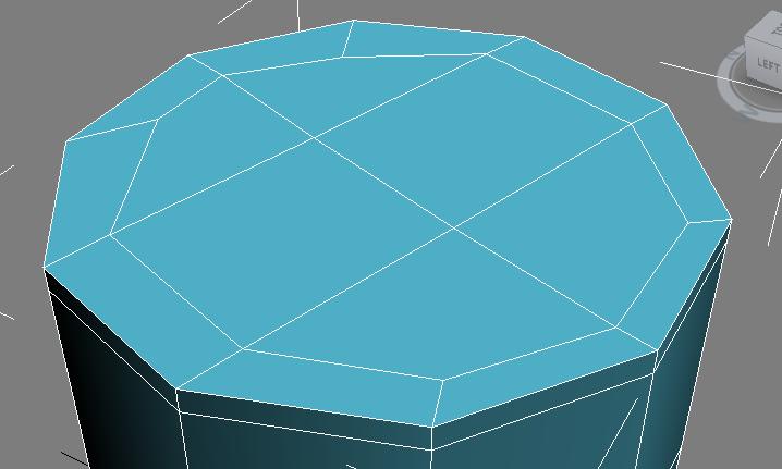

started with a 10 sided cylinder and deleted the cap polys. then made 4 polys across the top. Split them don the centre so you have 8. Then chamfer the new edges without the 2 nearest the cylinder edge selected. then created polys for the edges.
Hope this makes sense.
thanks rossco… got this far… where down the middle? where do you go from here? see my next post for a picture
some reason my pic didnt attach … here it is again (oh they dont like png’s)
Here you go pixeldamag…
as rossco … its as I thought… six sides on top rater than 8. so you get 3 divided to 6 not 4 to 8 – picky I know, sorry but I was trying to be exact. It’s weird that the default cylinders in max are badly modelled. Why wouldn’t they provide them like your example.

I’m using 3DS version 9 (not 2009) and the cylinder inport worked fine when importing & subdividing in ZB. Have you tried turning the Smooth off when subdividing? (The SMT button is beside the DIVIDE button).
