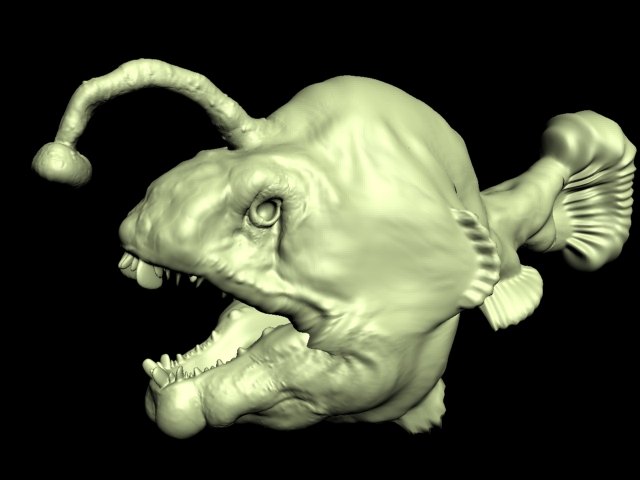

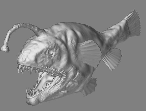

Attached is a picture of a fish, modelled only in ZBrush. (Bitey:)) If I follow the step by step tutorial, I get the following results - Bitey3ds
I used a 2048*2048 map, and the correct ZBrush model has 1.5million polygons
Does anyone know whats going wrong? :confused:
