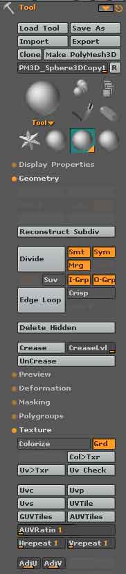

The way I’m doing it now is to use ZB’ GUV tiles. I can use Max’s Uv Unwrap, but even Max’s pelt mapping doesn’t compare with ZB GUV in the sense that it’s a lot faster (hey and I have stated before in this thread about GUV tiles and image apps like PS (obviously this is no longer the case with the ZApp Link)).
I can’t so far say many good things about Max 8, being a subscription holder I won’t even use it with all the bugs (some are concerned with the new UV Unwrap tools) and am still using 7.5. This is just my own opinion. I have been informed that an update to fix most of these is in the works.
Back to GUV tiles; three clicks and you have a perfect map done for you, can’t get much easier than that! Works with both Max base meshes and ZSphere’s. Swap em about-ZSphere-max-OBJ etc, it all works great (for me at least).
Meshes made in Max, UV’ed using GUV:

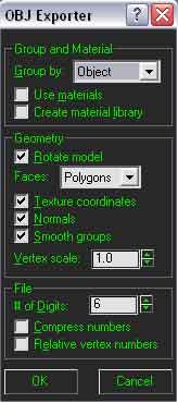

2: Export using these settings (hey once again, if you don’t like these settings fine use your own):

2: Use the same OBJ Export options as above. The 6 in the OBJ Exporter>File># of Digits is very important, without this your UV’s WILL NOT TRANSLATE over into ZB.

Scratchy, thanks for your reply. Your steps are all very understandable but I haven’t had success yet. The texture imports into Max but it is improperly mapped. Somewhere along the way I must have done something different.
I tried with a pretty low res model, wasn’t successful, and I ended up trying to break it down to a very basic extremely low poly model.
I started out with a low res model made in Max. No UVs just a basic model exported as a OBJ.
Imported the obj into ZBrush, followed the GUV,check UVs, fix seams. Textured and exported as a obj .
Imported into Max but the texture is off.
My test was very basic, no deforming/dividing. I just want to see a texture created in ZBrush imported correctly into Max. My work never required UVs until now so I’m not up to speed on UV-unwrap. I’m going to delve into starting out with a Max UV’d model after I am able to import a ZBrush UV and textured model.
Upham, that tutorial will come in handy soon. Thanks.
Here is a visual of what happens:
are you flipping the texture before exporting from z?
Yes, you must flip it vertically. Either before you export, or while importing in your target app. ZBrush also allows you a permanent ‘auto flip during export’ setting in preferences->export when you need that for your workflow.
