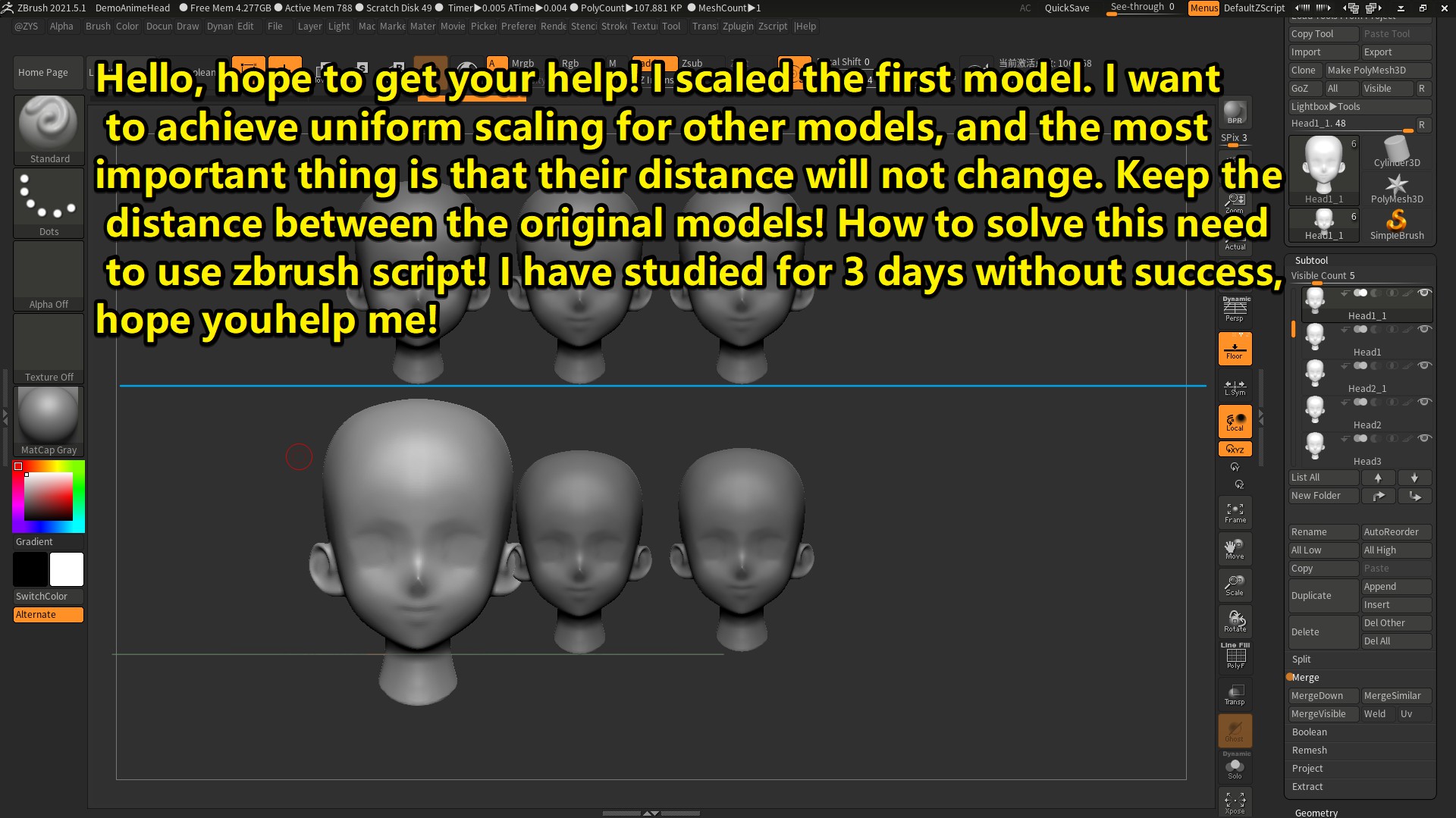

Hello, hope to get your help! I scaled the first model. I want to achieve uniform scaling for other models, and the most important thing is that their distance will not change. Keep the distance between the original models! How to solve this need to use zbrush script! I have studied for 3 days without success, hope you help me!Snipaste_2021-02-04_10-43-58
