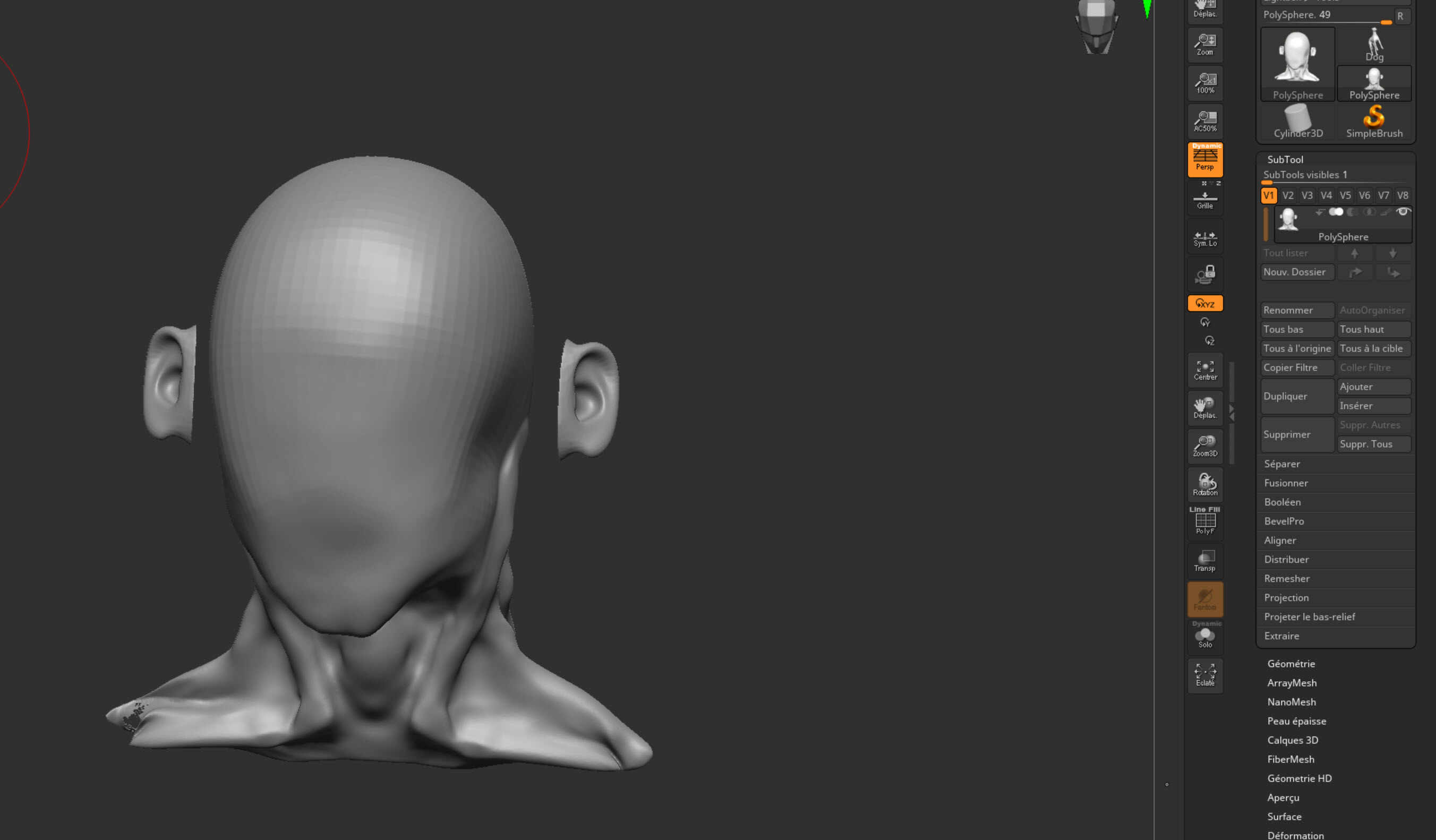

Hello, I wanted to add two ears, with symmetry, but as my head is not symmetrical, I created them a little further, only now I have to move them to stick them. When I select an ear with the selection rectangle for example, everything else disappears (besides I don’t know if it erases the rest, I did a ctrl+z. Thank you in advance for your solutions!!
2022-04-06_21-37-43
Hello @fl0645
If it’s all in the same subtool, you can just mask anything that you don’t want to move. For example, if you just want to move 1 ear, you would hold down Ctrl and draw the mask over the head and the other ear. Then you can move the 1 ear were you want.
Thank you so much!! I thought that like Photoshop we could select a part and move within the layer itself, I will try your method right now, without waiting!!
