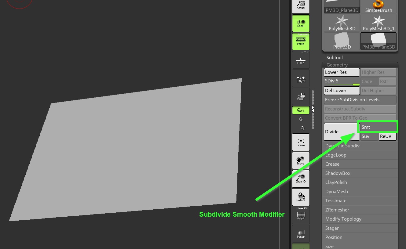

Hi @KT87
Turn off the “Subdivide Smooth Modifier” before you subdivide.
2023-10-15 11_22_45-ZBrush

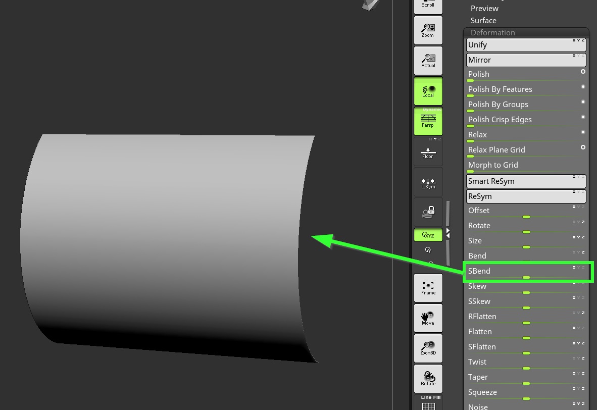

Not that I’m aware of. I’m not quite sure what you mean by “The plane I’m working on is curved”. A screenshot would help. You would have to subdivide while the plane is flat as I mentioned above then add the bend using SBend (Smooth Bend) in Deformation palette on the highest subdivision level.
2023-10-16 08_04_13-ZBrush
