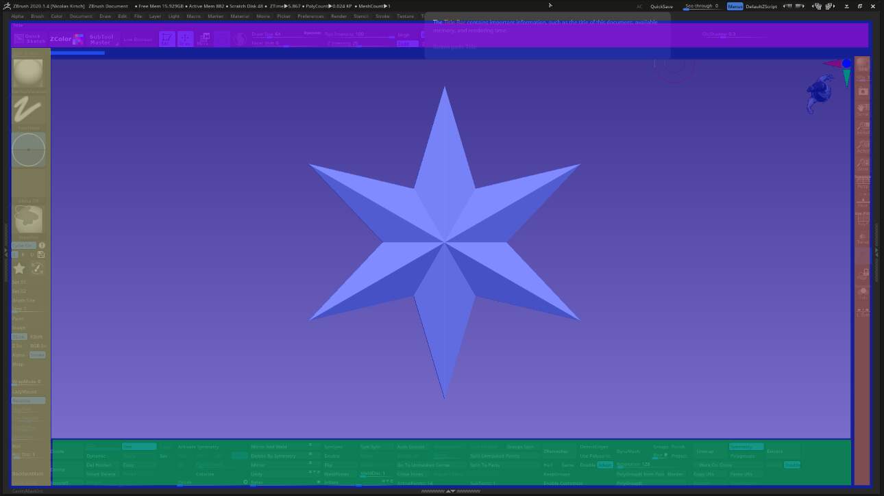

I have some issue to determined, depending of the custom ui the size height and width, of the floating menus.
do you know any way to define precisely about these values ?
because the height and width of the canvas includes the floating menus( the blue rectangle on screen represents the size of the canvas)
and each floating menu around the canvas can have different size depending of the custom ui.
I wonder if that would be not better to add two slider so we can set the gap manually, what do you think ?

The height and width of the canvas does not include the floating palettes - if you look again at the NoteInterface example I posted at the top of this thread it uses the canvas size to place the buttons. It will always be 200 pixels from the left edge of the canvas whether the floating palette is showing or not.

Ok I get it working perfectly now, it was because of a missing inotebutton, one that cover the whole zbrush size in pixel, so all items positions was relative to that first note item.
sadly the offset on h and V was exactly the pixel size of the floating menu, that made me confuse haha :rofl:.
