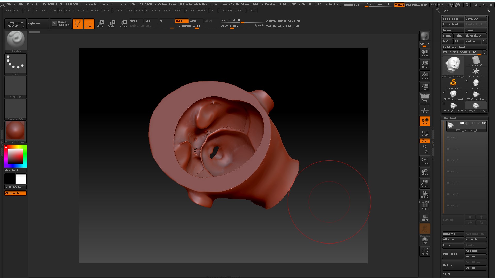

After hollowing out with edge loop or creating shell I have this awful result:

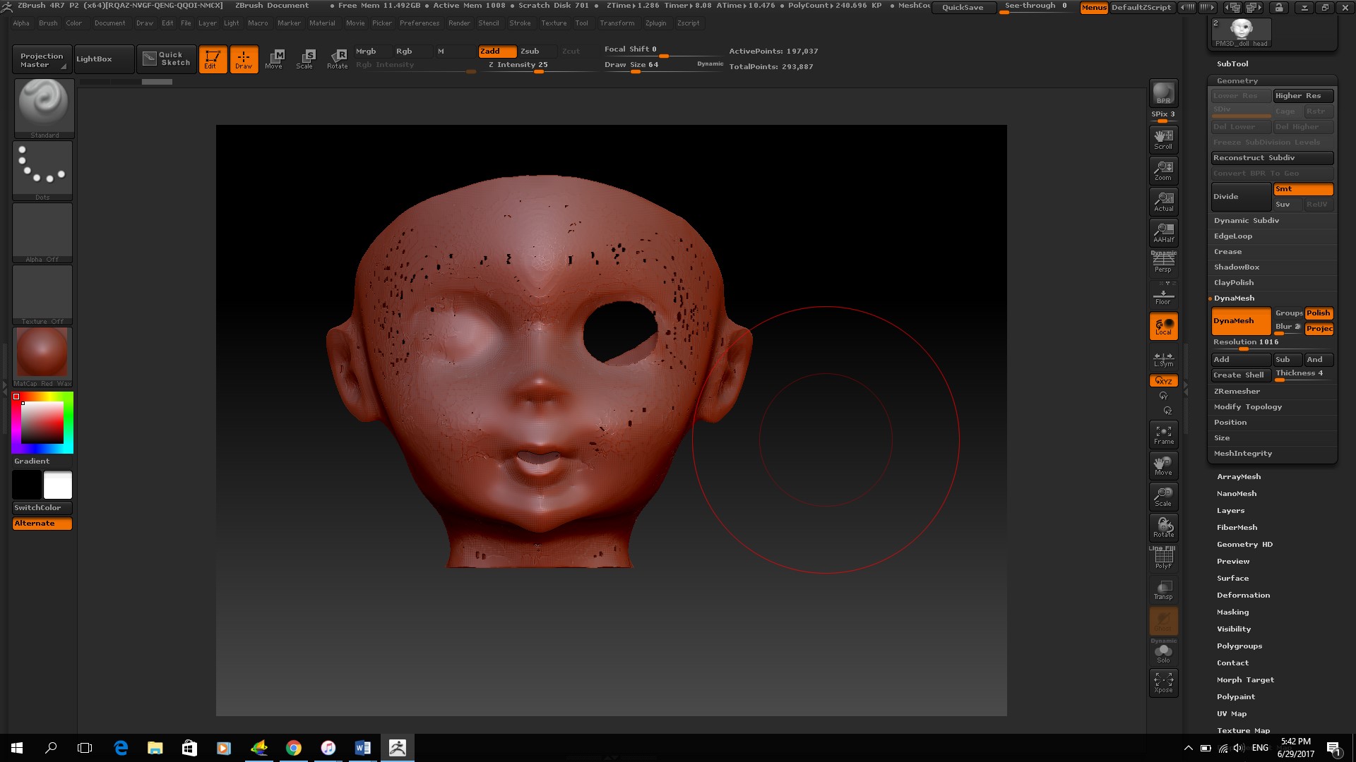

Then I tried to make a hole for one eye and mirroring it for the other eye,in order to do this ,I inserted a cube and subtract it from my main doll head.you can see the result:confused:(with lots of holes on the surface):
I tried to smooth it to fill the holes but the final result was worse than before.
