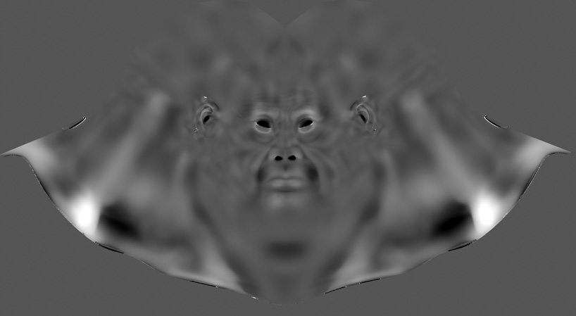

Hi Francois.
I tried your workflow and it works fine.

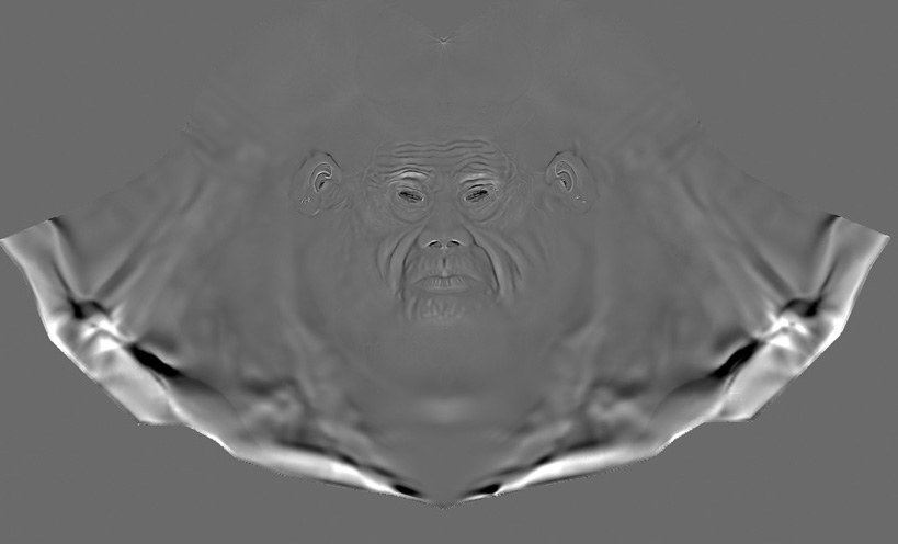

But I am a little unsure about the quality of your method compared to my ususal way of creating the dispmap in the second-highest subd-level.:confused:
Here is the result with your cage-method out of subd-level-1:
I didn’t try to render both, but I think my usual way leads to more details, don’t you think ?
When you create a displacement map from a higher subdiv level, finer details are always more visible on the maps. It’s the equivalent in Photoshop of High pass filter. Low frequency details are on the model rather than on the disp map.
I didn’t tried your method either. :slight_smile: but on the tests i did, i was satisfied with the results.
The point of this post, is that i found a workflow to change to more or less cage and avoiding distortions, or inaccuracy in the displacement map.
