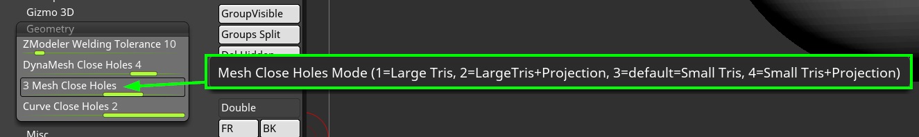

Hi @Rditms
Go to “Tool > Geometry > Modify Topology” and click “Close Holes”. Depending on the size of the holes, there is a setting in “Preferences > Geometry” you might have to adjust (see image), but the default of 3 might be what you need. Note that, you can only run “Close Holes” on a mesh with no subdivision levels.
2024-04-23 05_35_57-ZBrush
