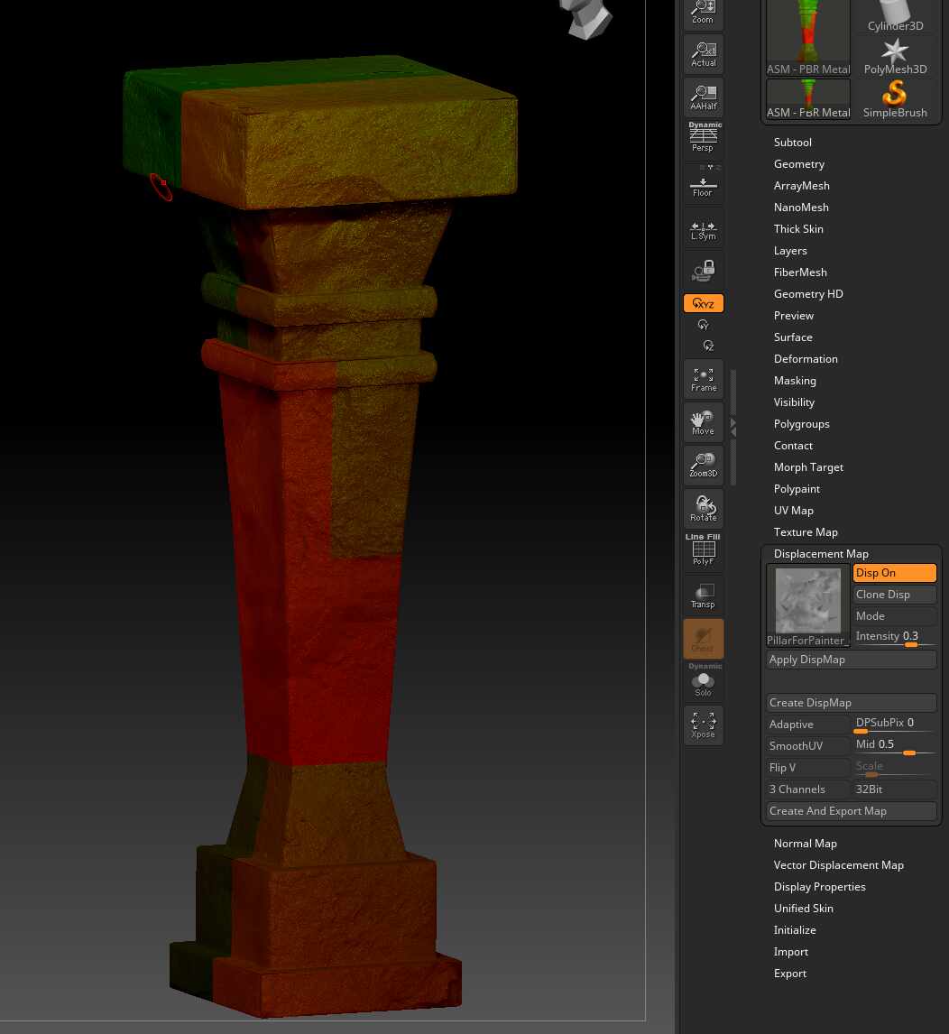

  1. I simply unwrap uvs in zbrush and apply the displacement map directly, which generates obvious issues at the seams:
pillarseam

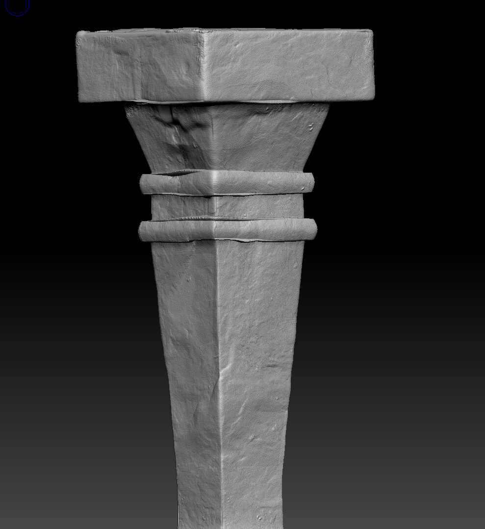

  1. I export the pillar model into Substance Painter instead, and fix the seams by blending heigh maps and other methods there. I export back the mesh and displacement into zbrush.
When I use Disp on for the preview, it gives the correct output :
pillardispgood

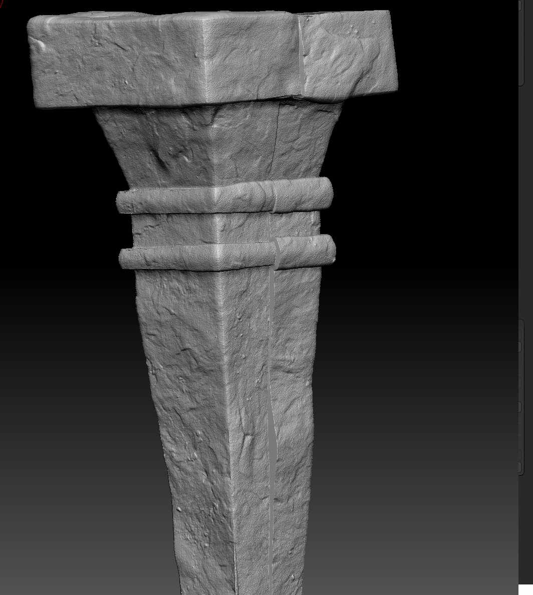

But when I click apply for the displacement map, I get the following:
pillardispnotgood
I can then proceed to fix the abnormalities, but I’ve come to notice that, actually, the details of the sculpt from the first approach are much crisper (possibly because I butchered the height map in Painter when I tried fixing it… guess I lost control of actual displacements there).
