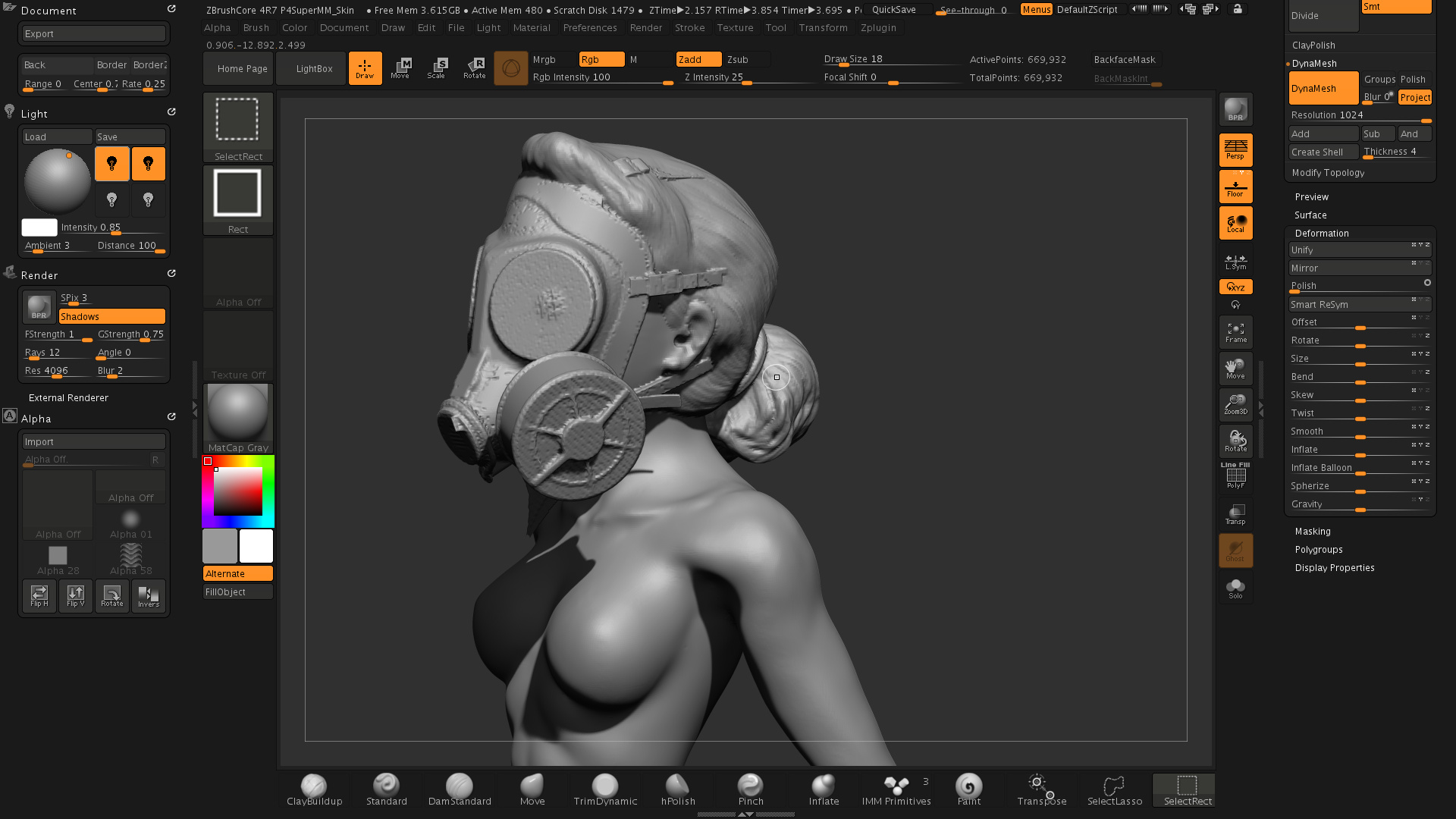

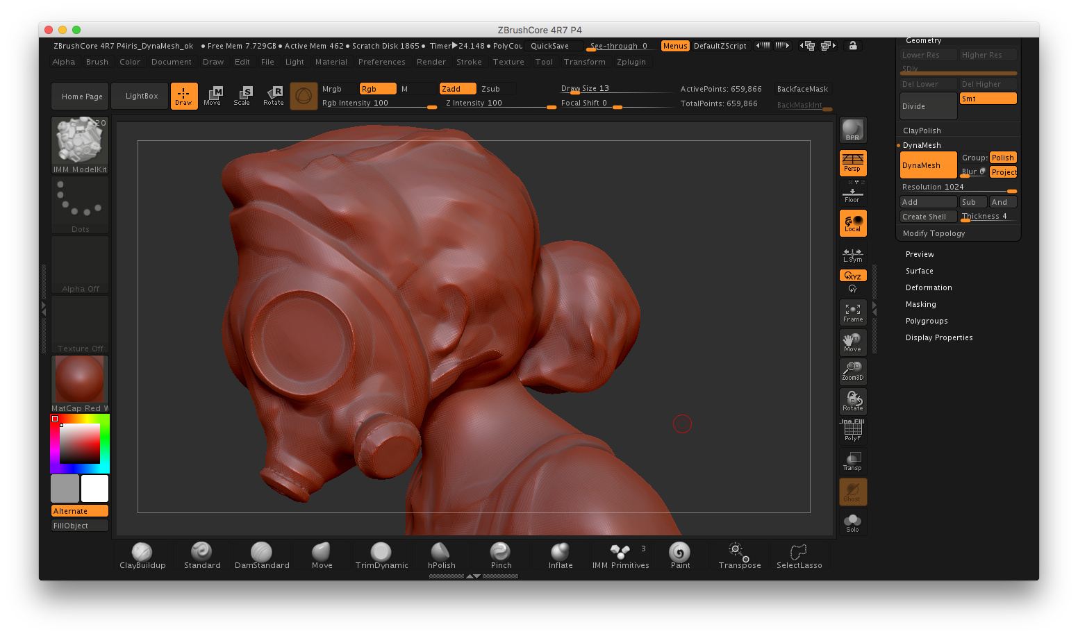

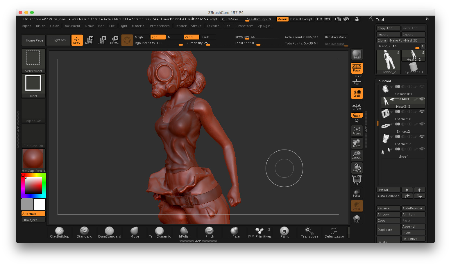

How do I keep perfect details before printing?
I finished a cool girl statue ,I want to 3d print her
So all objects are combined(MergeDown)。
It is one of the things that need to be printed,So I went on to execute another one(DynaMesh)
For the fineness, the Resolution value is set to 1024 max
But the details are still lost…
Would like to ask me how to do, will complete the perfect combination of objects, and then print.
thank you very much :)

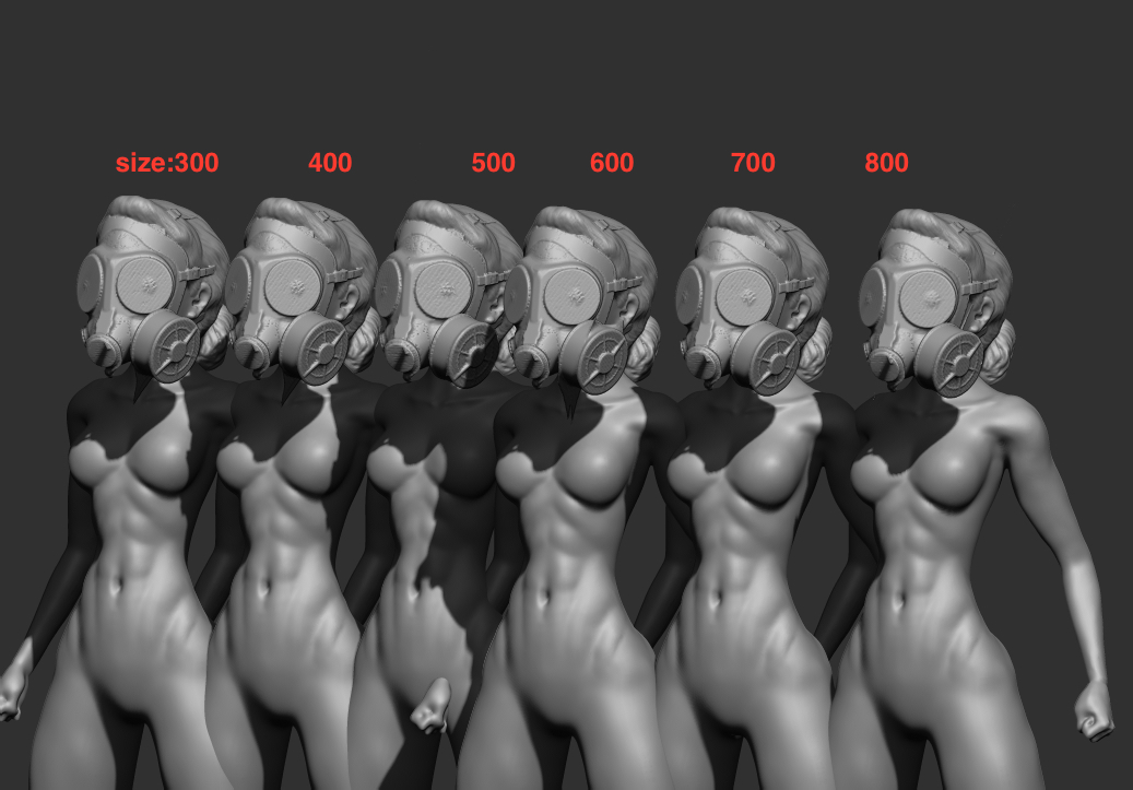

I try to increase the size of the core to 200 units, get the results as shown above (so still acceptable) will continue to try other values to achieve better results. Thanks for the two valuable suggestions! thank you all!
Try to adjust the size from 300 to 800, 800 part of the increase in the head of the subdivision, which seems to continue to increase the size, and will not make the situation better, but did improve the original surface condition.
