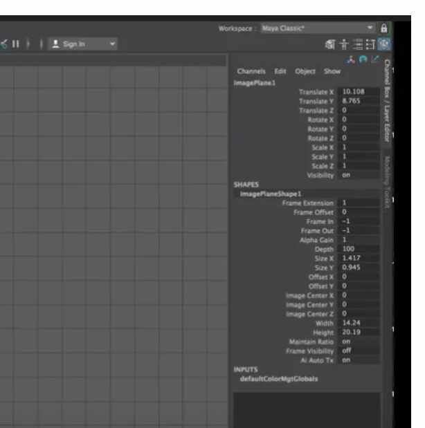

  1. Can we manually enter values and create a shape like in Autodesk Maya? The image below is a menu of the Maya 3d program.!
Screenshot_357
ZBrush doesn’t use the usual cm, mm, or inches. It has its own custom units. But don’t sweat it. You can simply assign a value to ZBrush’s unit, like saying 1 ZBrush unit equals 1 cm.For precise measurements, use the Transpose Line tool. Draw it across your model, and it’ll tell you the distance. That way, you can adjust your model’s scale or position with ease.Oh, and there are some handy plugins out there, like ZMeasure, that can help measure distances within ZBrush.Now, if you’re still on the lookout for super accurate measurements, consider trying a digital ruler tool like ruler.onl. It’s a nifty way to double-check your dimensions and make sure everything’s spot on.
