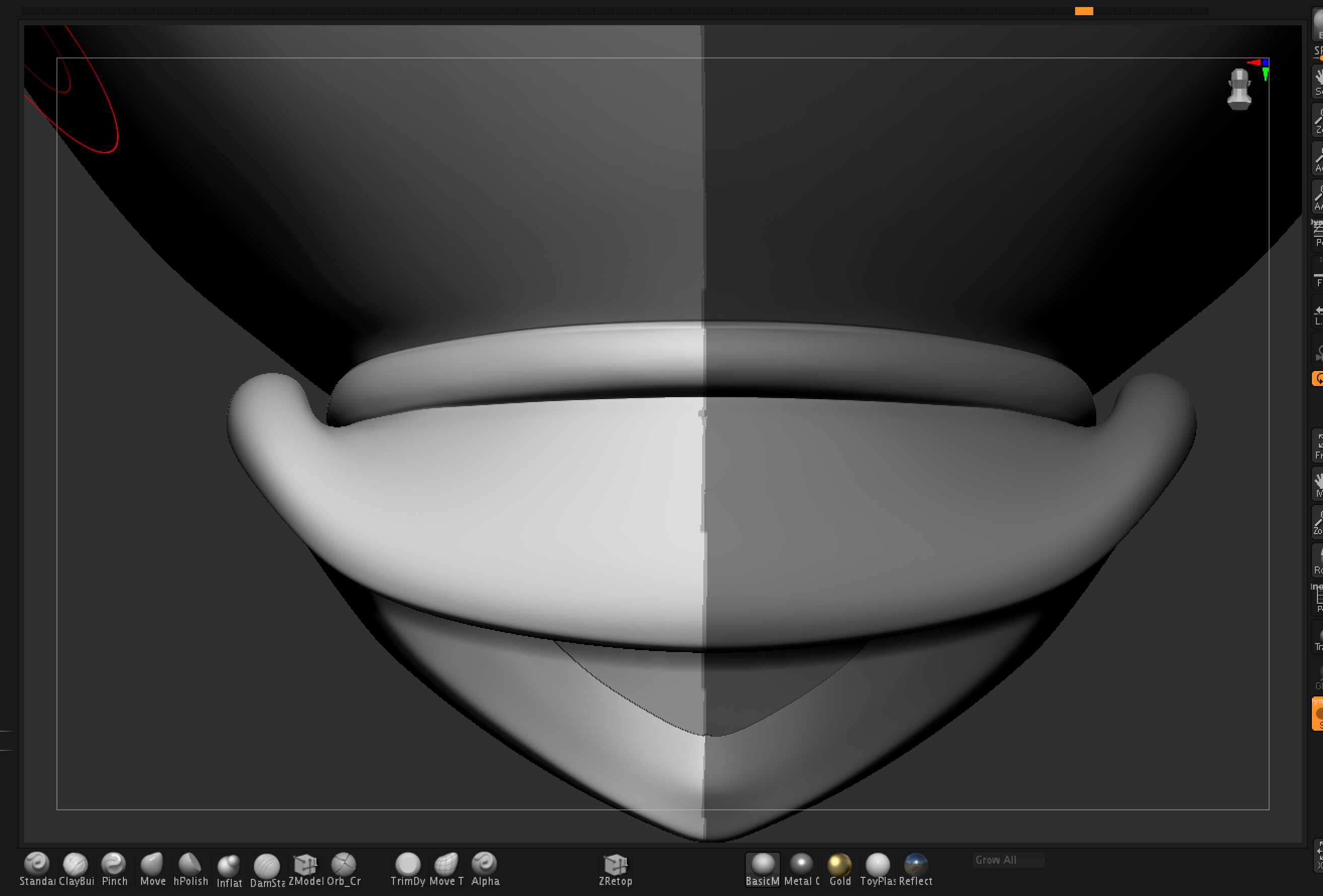

How can I mirror and weld this subtool w/ multiple subdivision?
Screen Shot 2023-07-24 at 4.22.58 PM

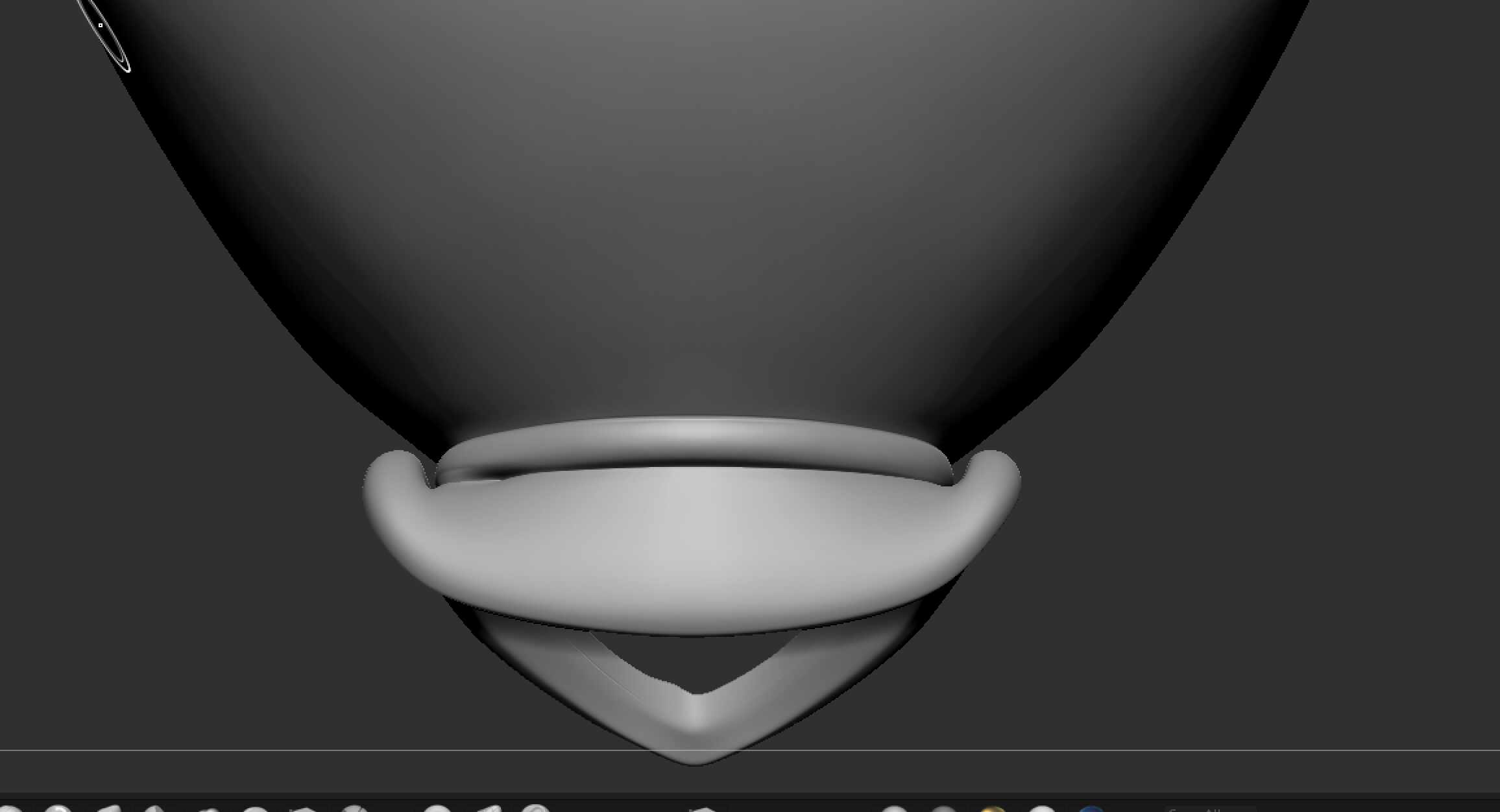

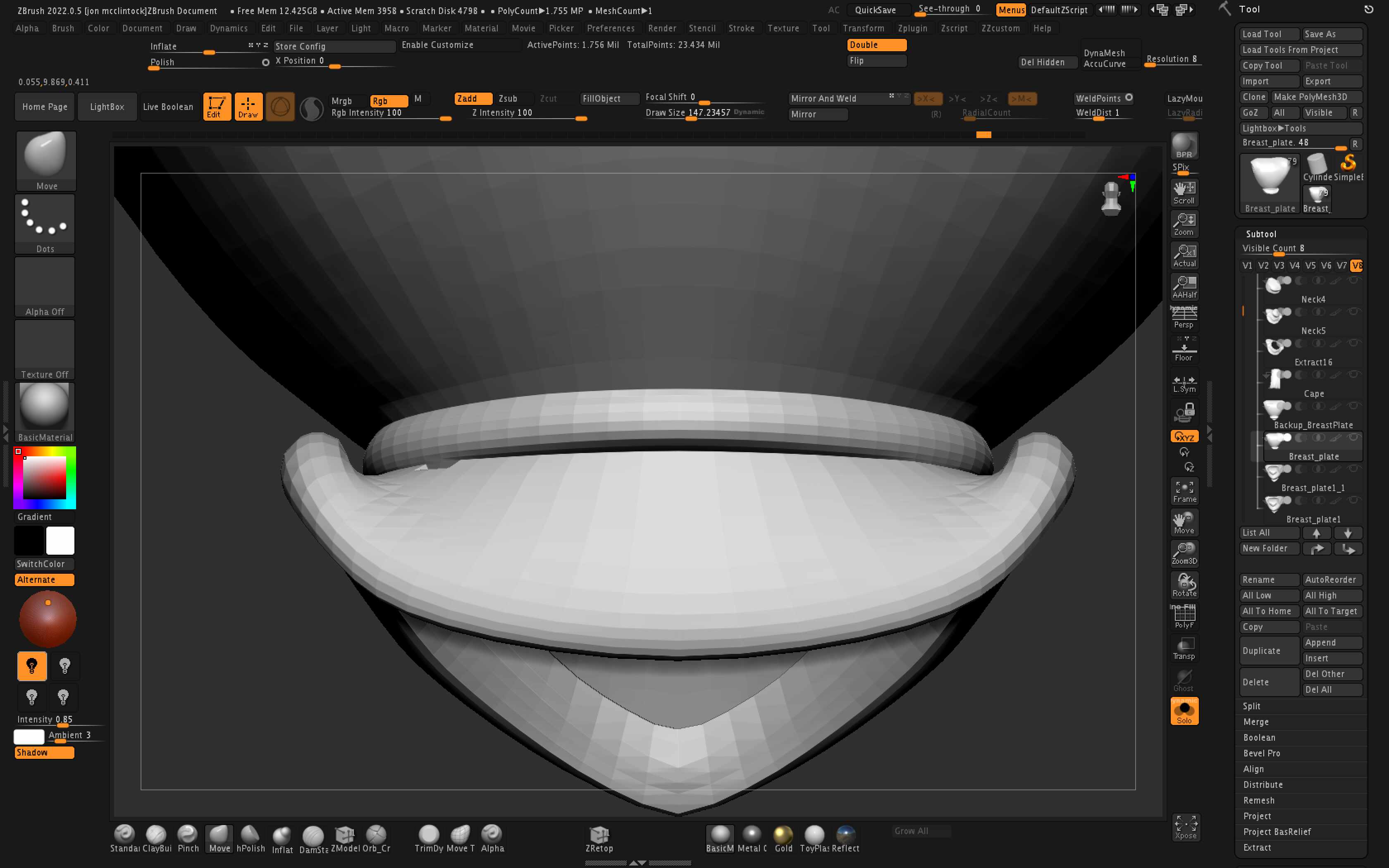

This subtool has 6 sub levels.
Screen Shot 2023-07-24 at 4.37.09 PM

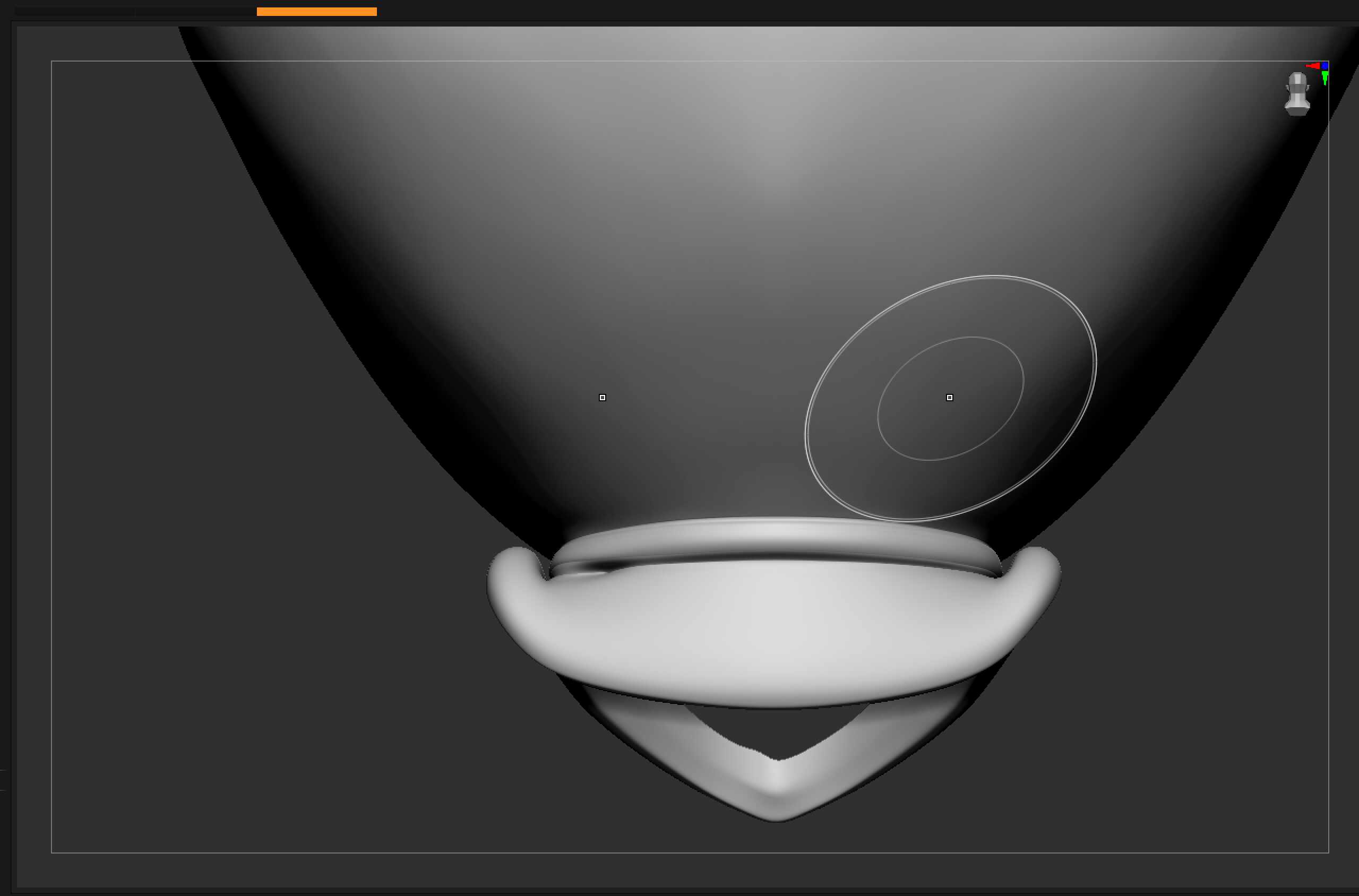

I noticed the rightsize isn’t the same as the left. I need to freeze the subD levels and mirror and wield.

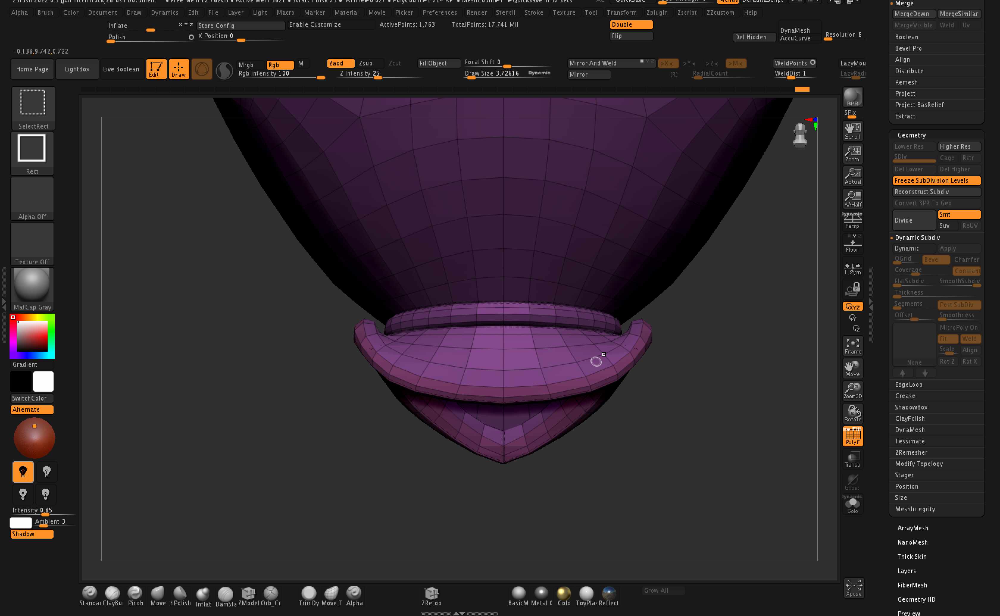

I froze the subDLevels and mirror and wielded it which corrected the issue (I also noticed at this point that one of the center points was off center, but that’s easy to correct if I can figure out what’s going wrong here).

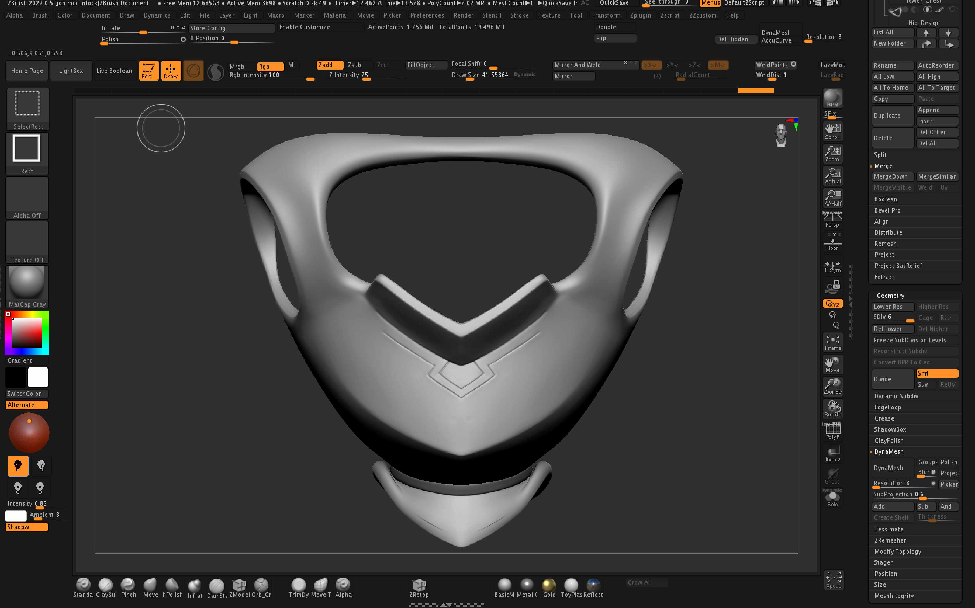

But when I unfroze the levels the asymmetrical issue came right back. What am I missing?
Related question: Does it matter if I freeze at the lowest subdivide level versus freezing at the highest subdivide level?

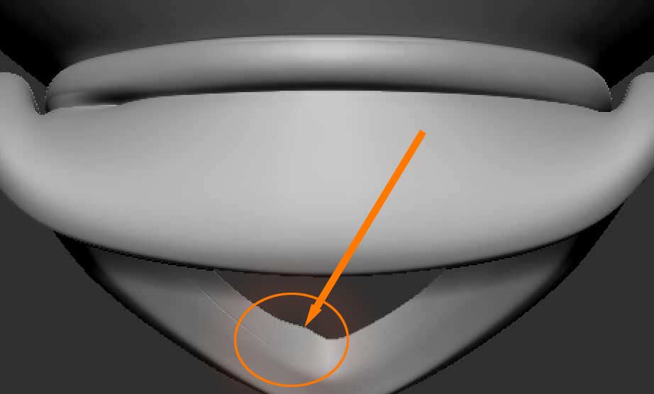

Are you referring to this issue when you say the mesh is asymmetrical?
asym
That would be a flaw in the form of the mesh, not merely the topology. One of the things that happens when you Freeze Subdivision levels is that it projects the detail from the original mesh back onto the new mesh. This would reproject that flaw in the form as well.
What @tobor8man suggested may work. The Smart Resym feature addresses symmetrical flaws in the form of the mesh, but does not change the topology. If you want to be assured of 100% topological symmetry, I would again Mirror and Weld after correcting the form.
An alternative would be to bypass Freezing Subdivision levels, and instead simply delete the lower levels of subdivision and then Mirror and Weld the mesh at the highest level of subdivision. The mesh should now be 100% symmetrical. To regain your subdivision levels you may be able to simply reconstruct them from the new high res mesh. Failing that you can Zremesh a new low poly mesh from that mesh, subdivide, and project the detail manually from the newly symmetrical high res mesh.

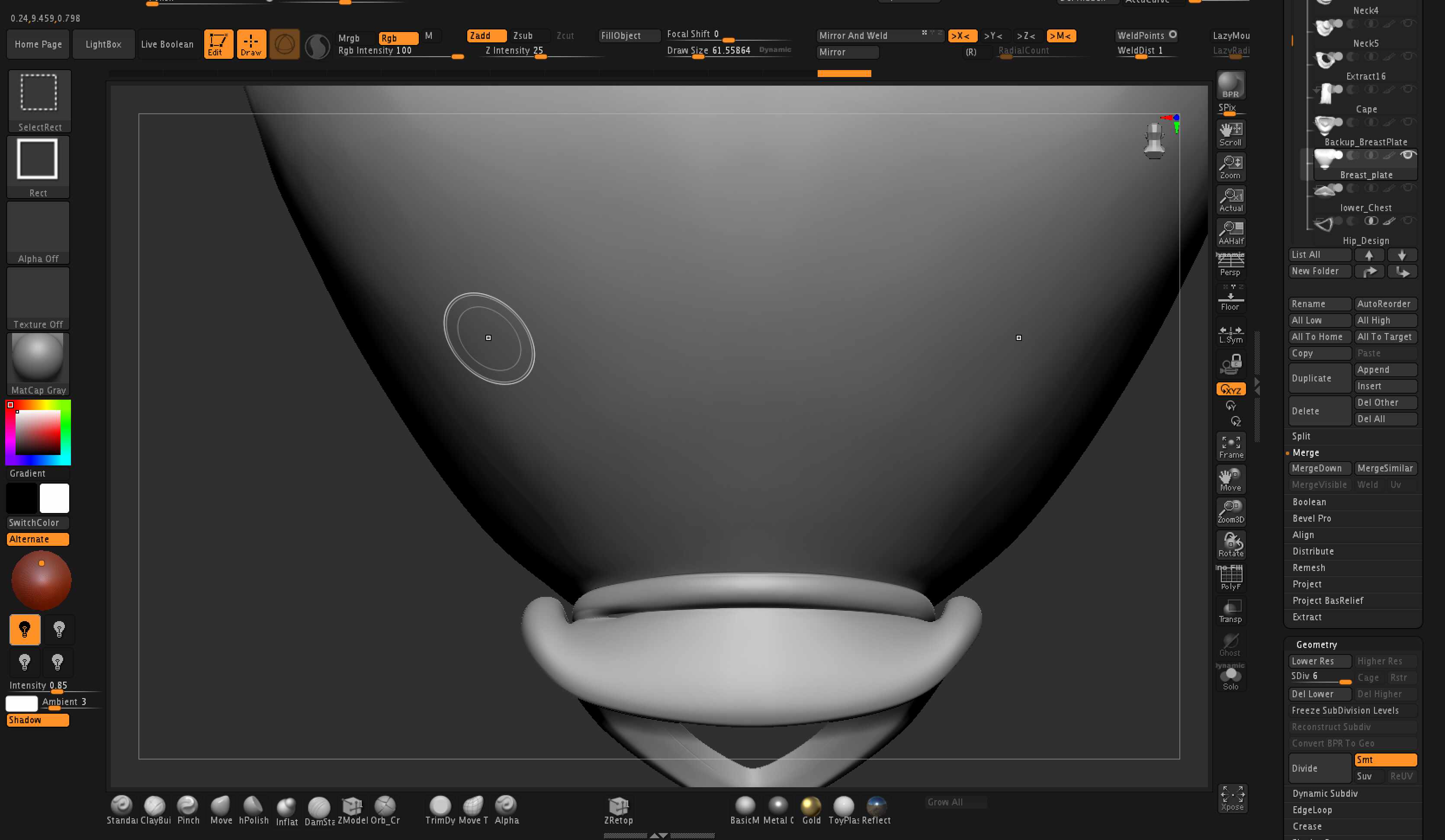

Oh thanks @Spyndel . That’s good to know. I tried that today. As you know, I was trying the get the shape symmetrical, but I was mainly focused on the hole to the left, under the belt.Screen Shot 2023-07-28 at 9.06.32 PM
I masked the side I wanted to Smart Resym, as you suggested and it appeared to work.
Screen Shot 2023-07-28 at 9.08.45 PM
But then when I rotate the view I can see its still not symmetrical when its in a lower res
Screen Shot 2023-07-28 at 9.09.32 PM
Oh well, I’ll just go back to deleting the lower subdivs. Thanks again for you help!
