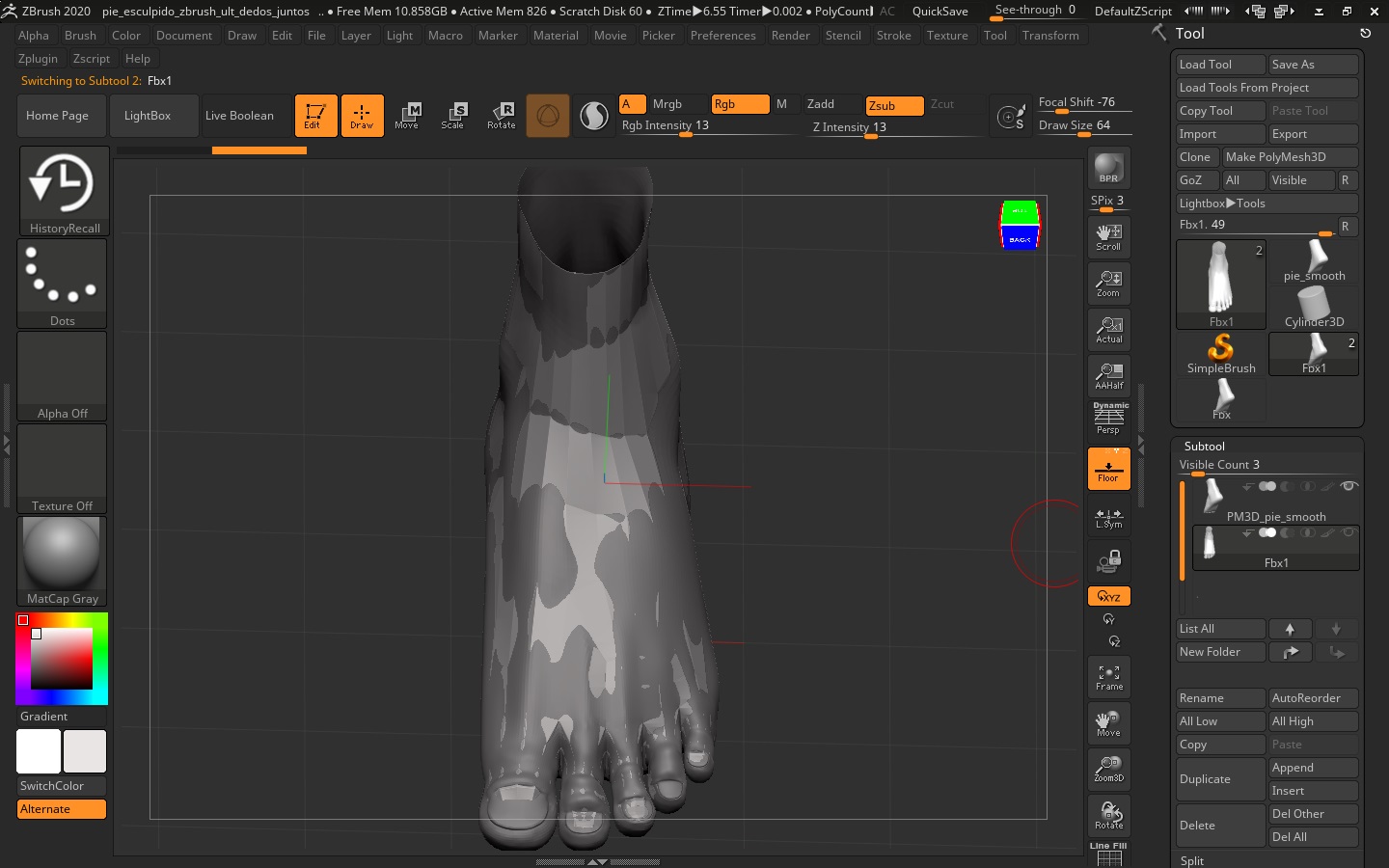

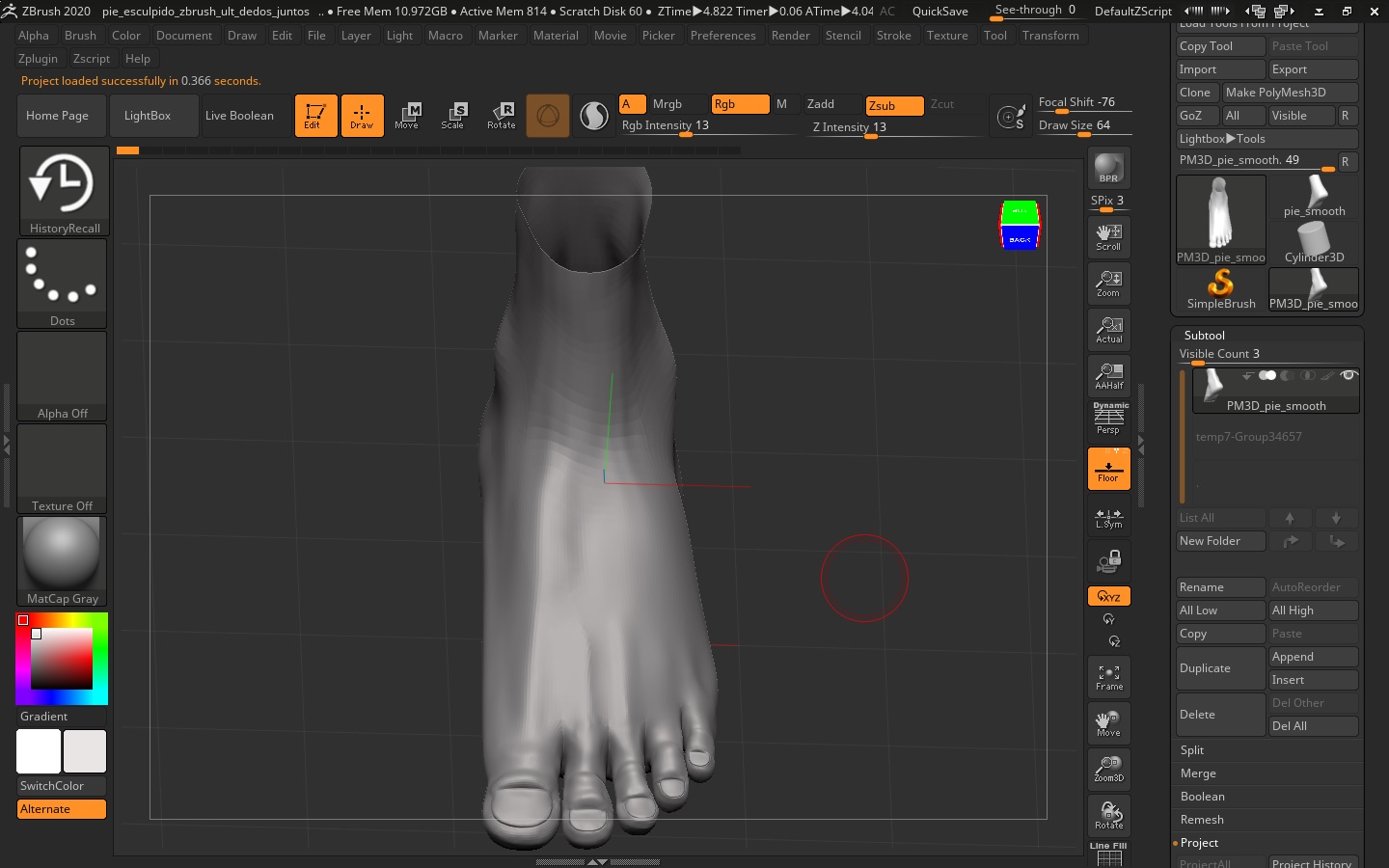

well, this is the sculpted one1
this both of them ready to be projected
2
dunno what im doing wrong, tks in advanced
The target mesh in that screenshot does not appear to be sufficiently subdivided to hold the incoming detail. Make sure to clear any masking.
