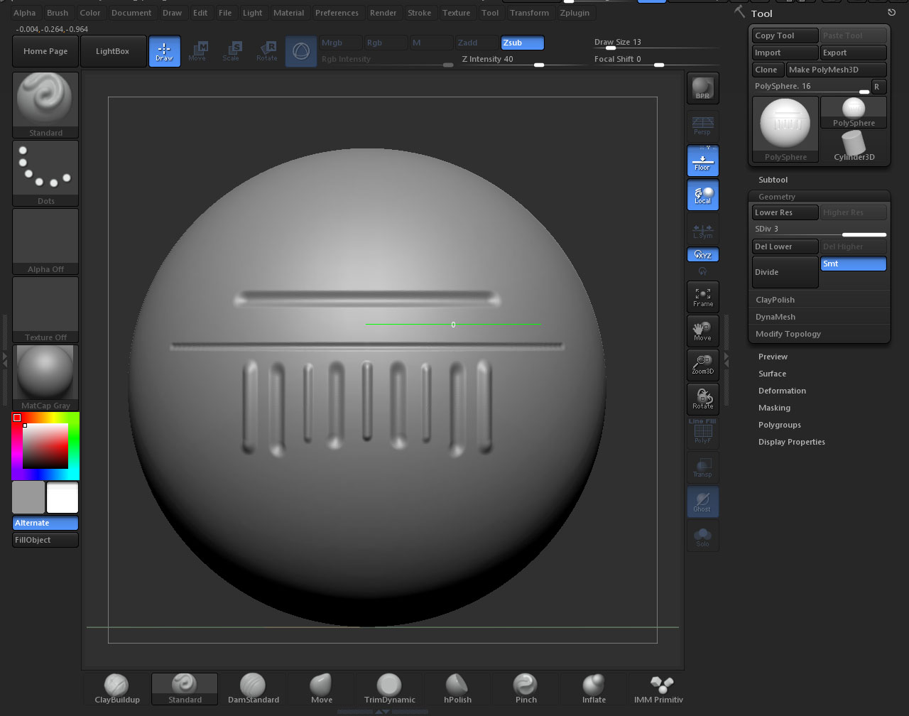

Hi mrJeef straight lines it works in core (I’m guessing the video is the old way of doing it with transpose)
Using just the Standard brush you just have to click on your model (dont let go) then hold shift (dont let go) then drag in the direction you want the line then let go of shift key first then the pen/mouse (the line will be made as soon as you release the shift key)
the pic i included shows the green line you will see while dragging the mouse when you hold down the shift key “after” clicking on your model and you can move your line around as long as you dont let go of the shift key and pen to get the line in the angle you want…its pretty cool you’ll see the angles IE: from 0 up to 45 .
(I only said mouse cause I use the mouse for that purpose (straight lines) and pen for everything else…but it works the same no matter what your using pen or mouse)
hope that helps a bit.
