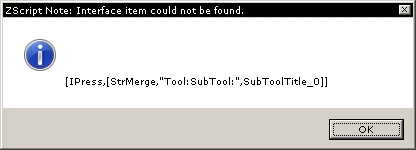

so. putting that into this loose macro form. it works sometimes, and yet others spits the error :
here i just lifted the IPress from a zb macro and replaced with the variable. if anyone can hint as to where i’ve messed up then thanks heaps
This is quite complex because you need to make sure that the subtool is visible in the subtool list before trying to ‘press’ it. So you need to find the active subtool in a slightly different way. The code shows one method. This positions the scrollbar so that the subtool at position ‘0’ is tested to see if it is the active subtool. This is only necessary when there are more than 8 subtools, as with 8 or less all subtools are always visible in the list.
This also uses the string compare method to test for the active subtool so it isn’t turned off (though this could fail if there were two subtools of the same name).
