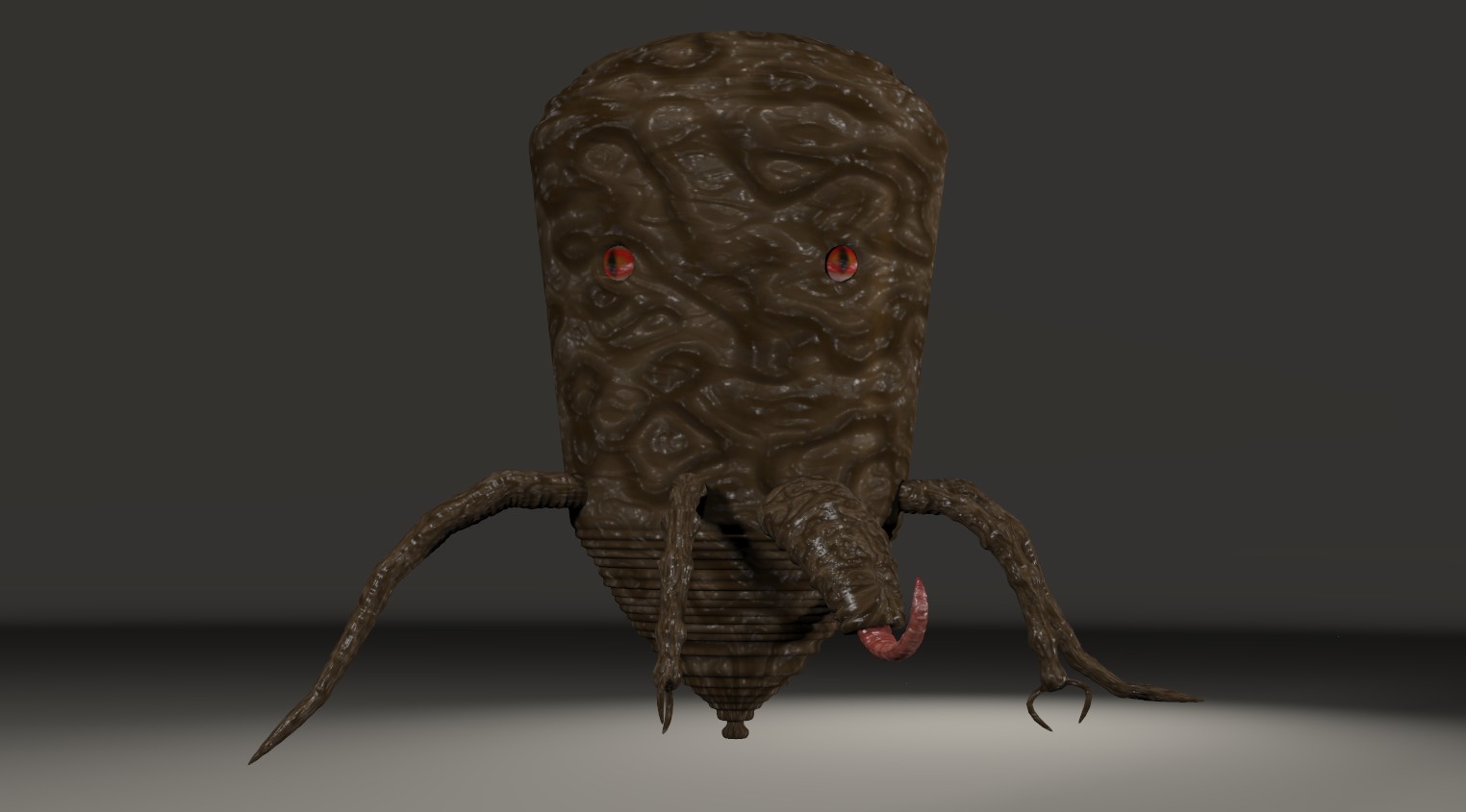

I posted the critter I made in literally minutes that if I could get a texture to stick to it (vs sickly green, sickly red) it’d be worth the time to rig and make morphs for in Poser. I also posted stuff I did - forgive the re-posts.
This I did with Hexagon - ancient freeware from DAZ and rigged in Poser to move the arms and such. Having issues with dial/morphs but consulting someone else for that Poser specific issue.

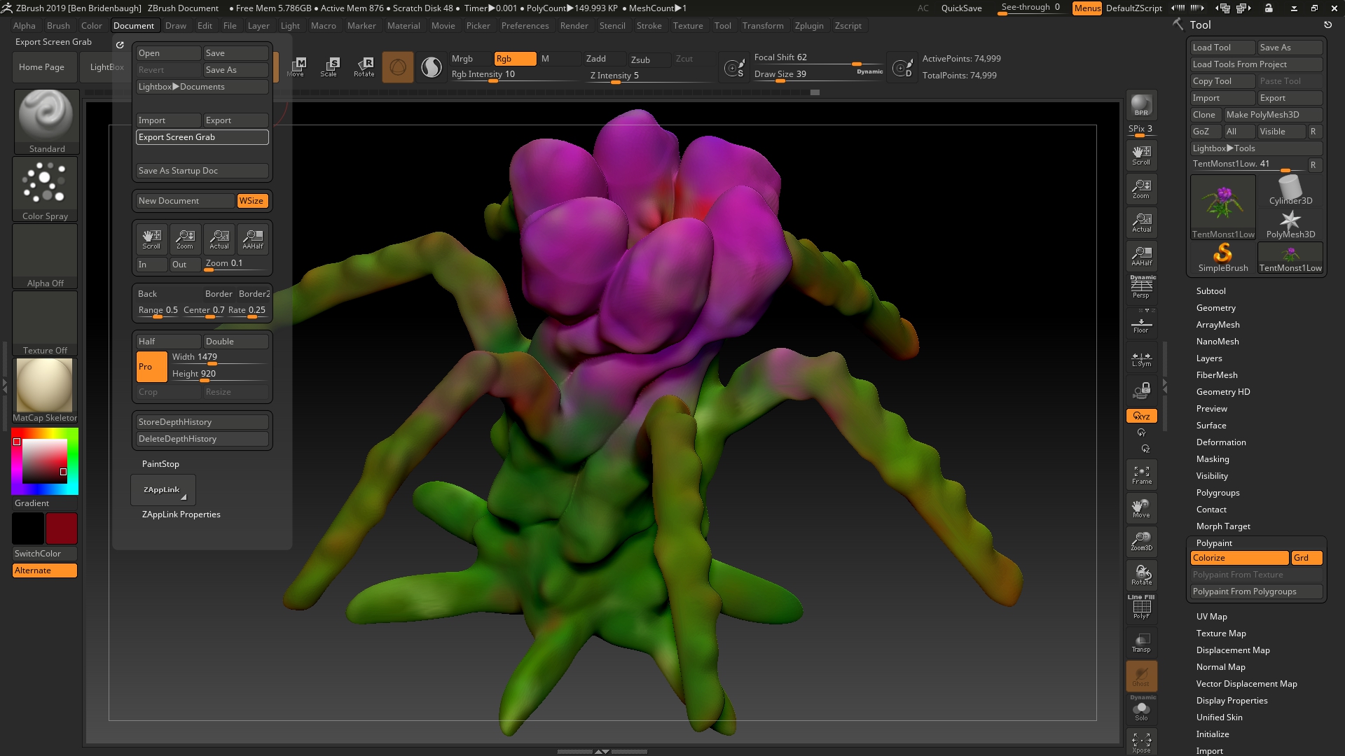

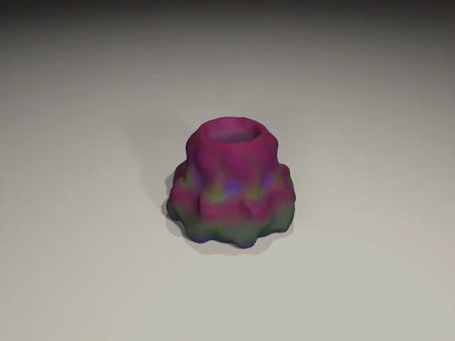

This I made last night in Zbrush.
GrabFlower
Took 10 minutes, including re-meshing so 2mb not 60MB model. THEN I spent 2 HOURS until it was way too late trying to get an exported texture so I could use it with anything else…

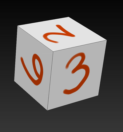

click to read Polypaint to Texture 101--should contain 5 images.
  1. Here I have my mesh. It has a low poly base which I will be exporting to another program. It has multiple levels of subdivision with Polypaint at the highest levels for reasons explained in my first post. You seem to already understand how to polypaint a mesh, so this needs no explanation.
texture1
  • We will not be doing that here, but the explanation is linked in my original post. It has some fairly specific steps that need to be followed, so read it carefully in the event you wish to use externally created UVs that need to be preserved exactly.

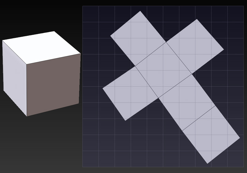

  • We will be using UV Master, because UVM is really neat, and the quick mapping methods are probably not suitable for most complex texture needs. UVM documentation linked in original reply. Like everything else contains a lot of important and useful information that might head off any number of potential problems or questions. I cannot distill all that information in the scope of this post, but you need to know it.
Here is the resulting UV’d mesh, and the simple unwrapping I’ve done herewith UVM at default settings. UV unwrapping/layout is a skill, and the more complicated the mesh/texture, the more consideration needs to go into the UVs. You will need to learn how best to lay things out to avoid issues with artifacts or texture distortion. I have deliberately chosen a simple subject to avoid those kind of issues, but expect them with more ambitious projects.
texture2

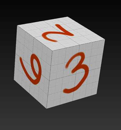

  • Note the Current version of Zbrush only contains a single slider for map size. Tool > UV Map> UV Map Size
Here is my newly UV’d model back at the highest level of subdivision with polypaint active. Note that it actually contains many more polygons than the polyframe would suggest. Zbrush filters out polyframe divisions after a certain threshold on multilevel meshes to keep it easier to read.
texture3

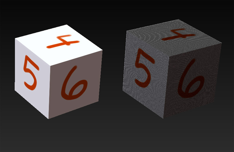

And boom. The polypaint is now converted to an image texture that can display on the low level mesh, regardless of actual mesh resolution. The base level mesh only has 6 polygons, but displays the former polypaint info perfectly. If you export the base level mesh now with the texture active (tool> export), it will automatically export with a texture .bmp that should auto import into many other applications with the .OBJ
texture4
However, if you want to do something more advanced with that texture, like flip it or export it in a different format, we know from elsewhere in the information I linked that:
So I clone that texture in the Tool > Texture Map menu, and send it over to the main texture palette and export it as a Tiff.

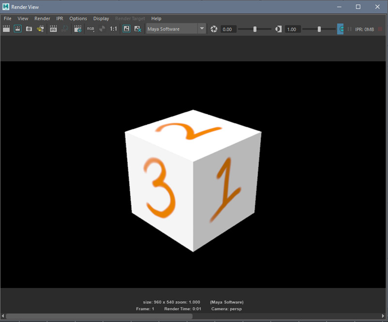

Here is my cube in Maya, subject to all the differences in the Maya render environment that may make it appear differently. Each program may have its own preferences as to how to correctly display a texture. You may need to, for instance, flip the texture vertically. That will require you to be familiar with the target program, in addition to the source program.
texture5
I hope you’ll discover that however much effort you put into the polypainting, the actual creation of a texture can be very easy, and very fast. This operation took less than 30 seconds all told. But it was a simple mesh/texture, and in order to troubleshoot issues with more ambitious texture work, you will really need to understand smoothing and seam issues, as well the texture display functions in your target program. The only way to do this is to dive in and start doing it, over and over.

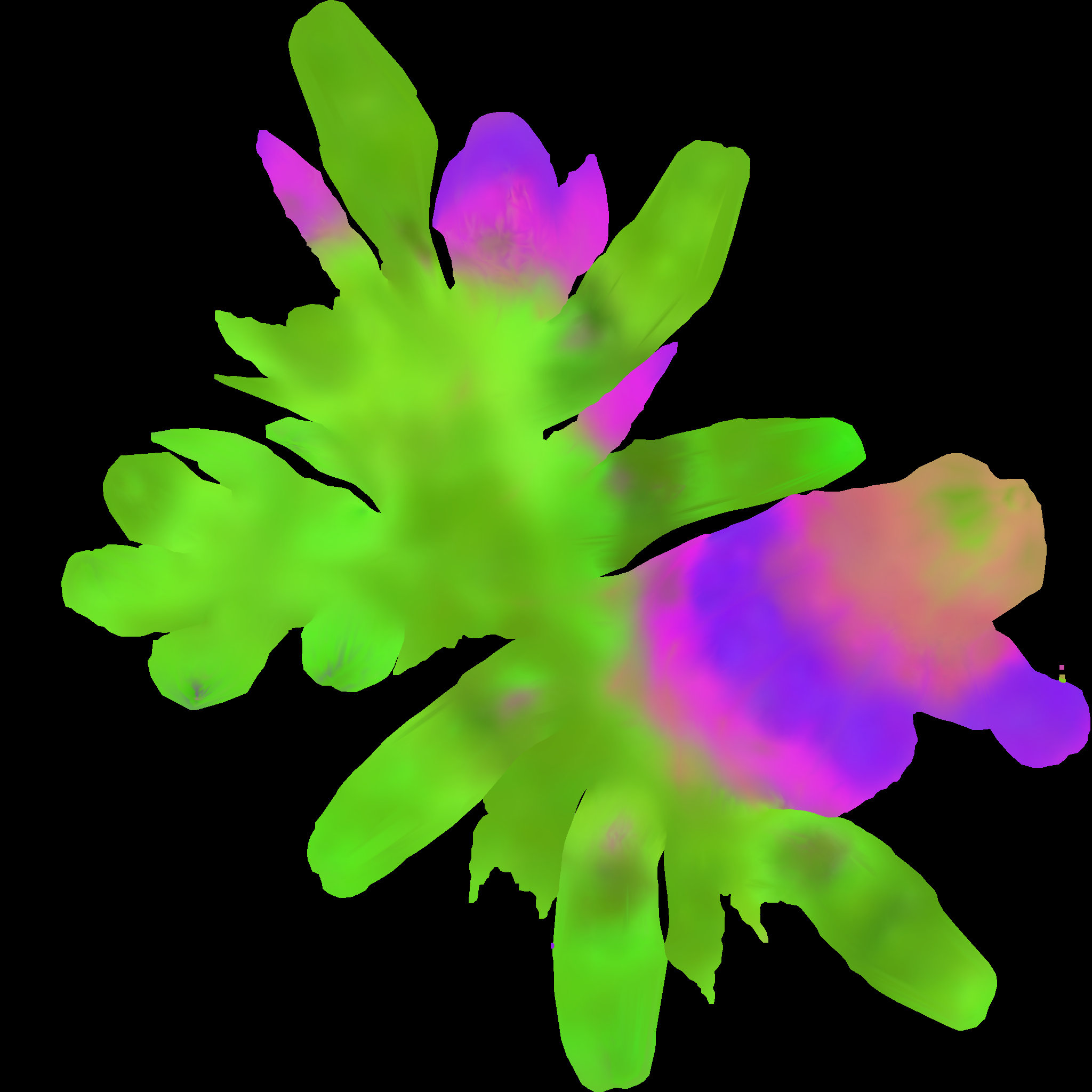

Thank you! I’m working on it now. So far I’ve at least figured out a work around.
I will spend some time researching this. And thanks for your time. So far I’ve made some progress (getting a mesh after letting it grind a few minutes) but doesn’t stick. Far FAR better than before though.
Still might just add crude painted textures in Hexagon then edit said textures with Affinity photo but will try some more. THAT does work, btw. extentmonst0
Ancient Windows XP era software can handle an imported Zbrush obj mesh so thick you can’t see the wireframe if turned on and I can paint parts red, green, etc. to edit later - and then there’s a base UV so can go lazy and add a tiled texture and it does work versus a raw Zbrush .obj that won’t even take a texture…
4TentMonst1LowZtlExMAP_u1_v1
Heh, I love the un-wrap but doesn’t seem to hold in Poser no matter how I flip it. I’m NOT complaining, this is big progress - especially the next pic. This I got that crazy peel - didn’t line up so far but able to use any/alt texture to get a cohesive pattern!
AfterRepeatTryAdviceZforum
Coz I now I CAN get it to hold a tiled pattern. Or paint one via Hexagon and then edit.

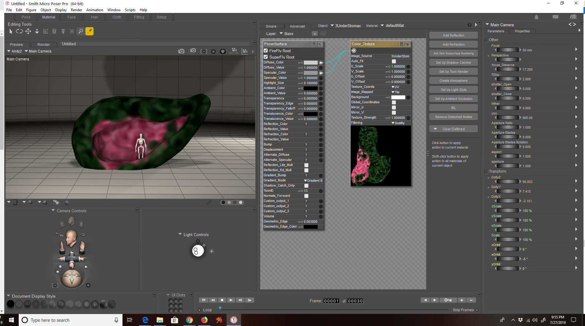

Update - late in the day -
PoserStomachWorked1

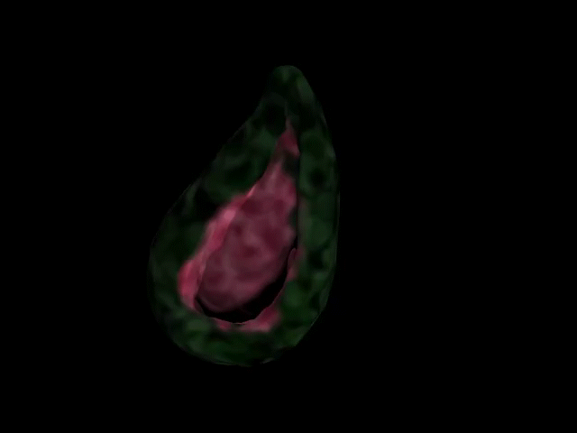

Had other things to do today but did a few hours trying to nail the texture down. This time I DID get a texture to work direct in Poser - didn’t even have to LOAD it. Simpler prop and after decimation even with texture 957K also! Alien stomach that swallows stuff. Vore stuff. So far a LOT of progress!
Another reply in thanks!
I’ve made the bridge and will do more research.
I was able to (using the tools near the top right menu) get the polypaint mapped and then after I can separate the map the thing decided to actually load…!?
And - this is another layer of pain - but related to Poser - and I was finally able to get around it I was able to get a morph working in Poser without the morph being a scaling nightmare.
This prop came from Z-brush (think an alien’s stomach for some kind of Vore/Tentacle thing) but was able to get to work in Poser (only 954 Kb!) so rendered a simple animation and converted to gifanimation.
