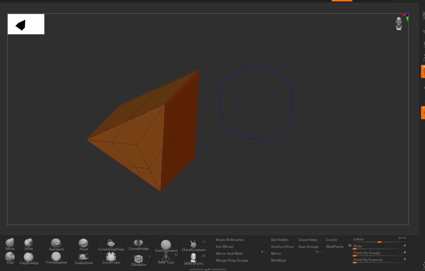

Help me in zmodeler tool
Screenshot 2024-09-01 122228
How to mesh this triangle to make it better

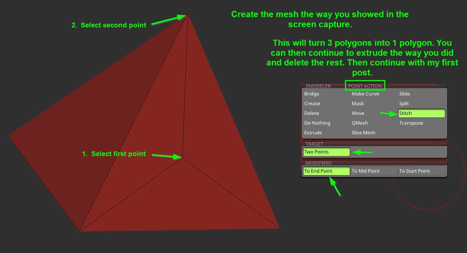

Only 5 polygons at the start. You will have to start a new one. Don’t use on the mesh you show in your post above.

@zber2
i made the triangle that way…it looks wrong
can you guide how to make it and some other simple geometry
thank you
You were half way there. All you had to do was Stitch 2 points to make a 1 polygon triangle.

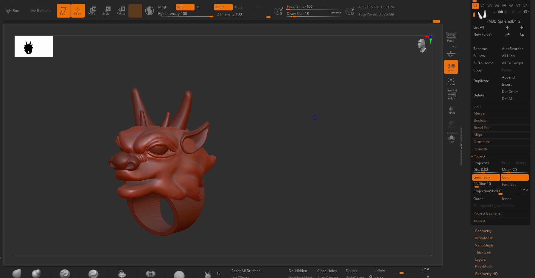

Can you tell me about the Project function in Subtool?.. I have watched the tutorial on youtube but I don’t really understand.Screenshot 2024-09-03 215307
@thai_bui
Basically, what it is used for is, if you have spent a lot of time creating a lot of detail on a mesh but then decide that the mesh topology is not right or could be better, you can create new, similar mesh with better topology then project all the details from the first mesh to the second mesh. That way, you don’t have to start all over again sculpting all the details. Paul Gaboury does a good job of showing one way of how it is done in the video below.

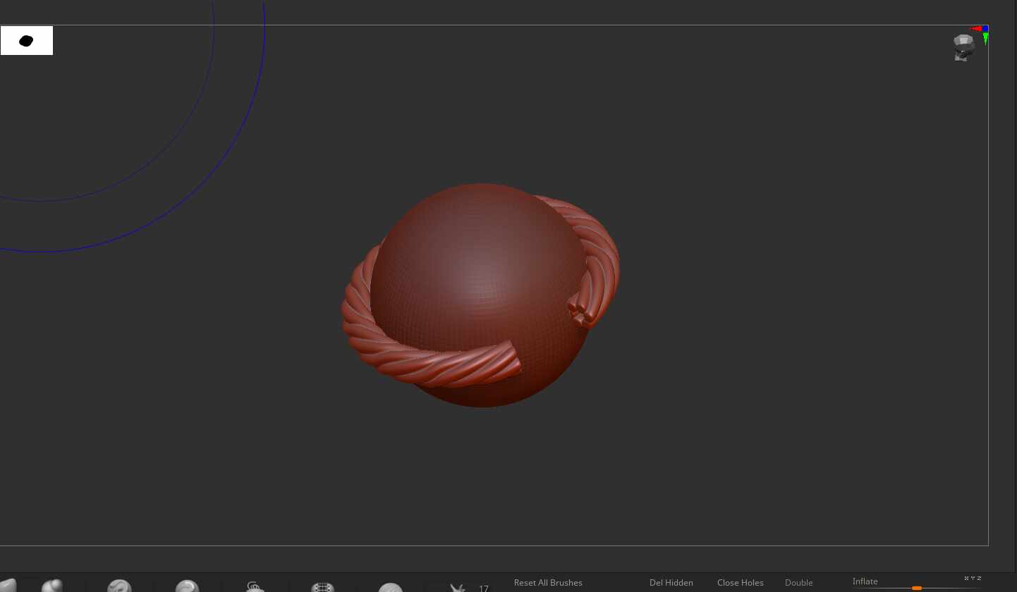

Hi @zber2
I have made a spiral brush of wire (6 round tubes)
how to connect them together seamlessly
thank youScreenshot 2024-09-21 162325
