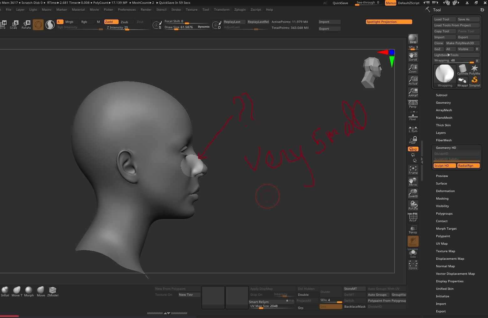

Help Geometry HD cycle is smaller
hello
how is Geometry HD cycle is smaller I need it bigger one
my email [email protected]
GeoHD Thanks
Hello @model_3d ,
The size of the preview area that Sculpt HD is able to preview is based on how heavily subdivided that area is. The more polygons there are, the smaller this area will be. There is no way around this other than to subdivide the mesh less with HD Geo, start HD Geo from a lower level of regular subdivision, or to more carefully manage and optimize your topology to require less subdivision overall for high detail areas.

Thank you very much spyndel you save My life
thanks again
