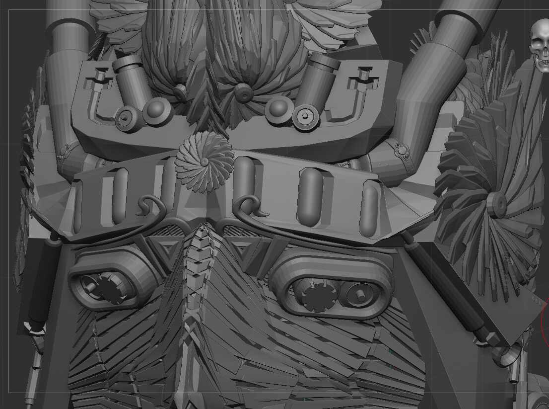

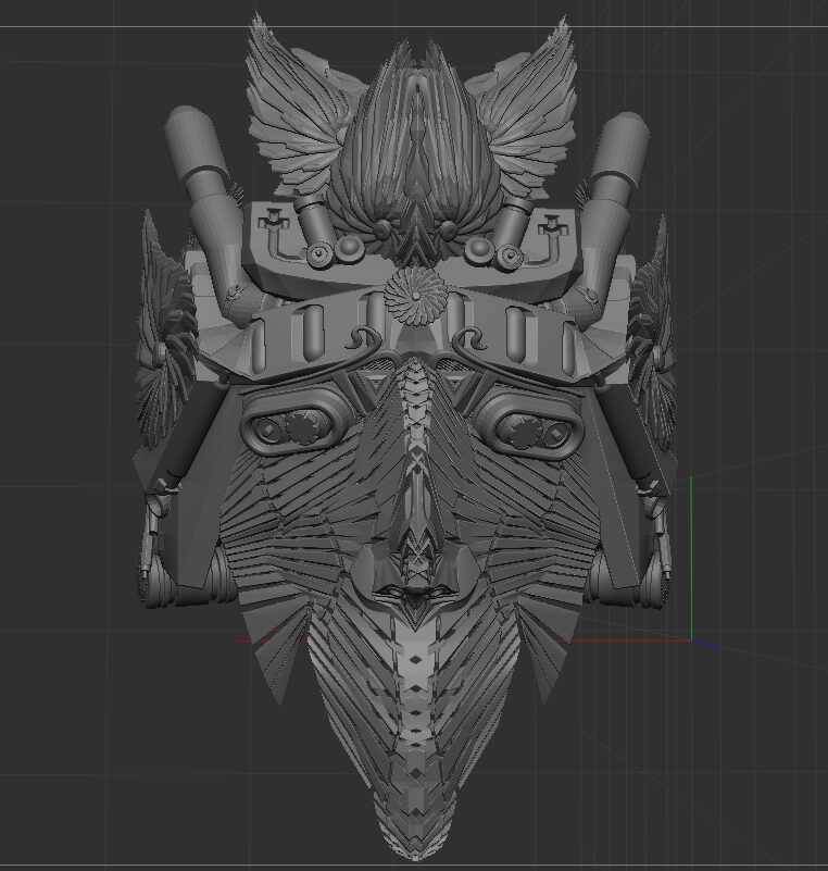

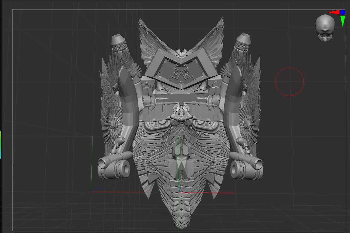

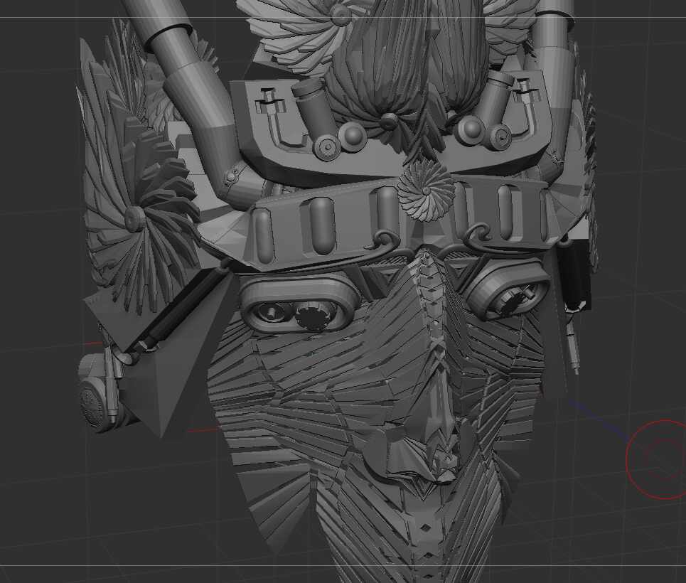

I am getting closer to accepting a loss on this model i’ve been hard at work on in the hopes of getting it to 3d print via Cura 5.1. This project was one of the first things I’ve made during my 1.5 month self taught zbrush journey so far so I understand that it may be full of mesh issues I am not experienced enough yet to comprehend. I understand the concept of making models manifold, and 3d printers needing things to be designed in certain ways so i made sure to closely comb over the parts to check and reinforce anything that wasn’t attached to something else. I’ve used zbrush’s mesh integrity option, fill holes, and even tried some 3rd party options like ms 3d which has a auto-fix mesh option, and tried mesh mixer which was making things unnecessarily complicated, and still Cura is warning me that there are mesh errors and printing may be a risk.
I will provide the images below of the model I am speaking about for reference.
When I was making this, I wasn’t using dynamesh or subdivisions much because I didn’t want to alter the geometry, and specifically the sharp lines caused by manipulating IMM brushes. I wonder if there is not a better way to be considering my issue here? I have decimated the final merged subtool, and can’t really use any zremesher or dynamesh as it destroys the intended final design results. Can anyone help me with my headache here? I have been trying for the last week to figure out if this should just be scrapped and I should move on, or if I can somehow maintain this, get the mesh corrected but keep things preserved and intact?
Screenshot (7) Screenshot (8) Screenshot (9) Screenshot (20)

I concur with @tobor8man–the mesh in the form you have on display here will be problematic on a fundamental level for an FDM print process for reasons completely aside from errors in the geometry. In particular the open sections of mesh that are made up of long, thin panels of geometry seem impossible to print as a single piece in the way they are now.
To be clear–even if you successfully fuse all this geometry together in the form it is now in ZBrush or otherwise, the mesh will still be problematic for print. The basic form of this mesh, not just the geometry, needs to be consolidated far more than it is now for the purposes of print. OR the mesh needs to be broken up and printed as a series of small individual pieces that will be fitted together after printing. Prepping a piece like this for that sort of process would be a daunting task.
For the purpose of print output you need to work towards closed, watertight solids with enough thickness for your printer’s capabilities. You also have * a lot* of deeply inset undercuts and overhangs that would frankly be a nightmare to create support for. You want to be working towards chunky, single piece solids with a level of surface detail that does not create overly complicated, deep cavity recesses.

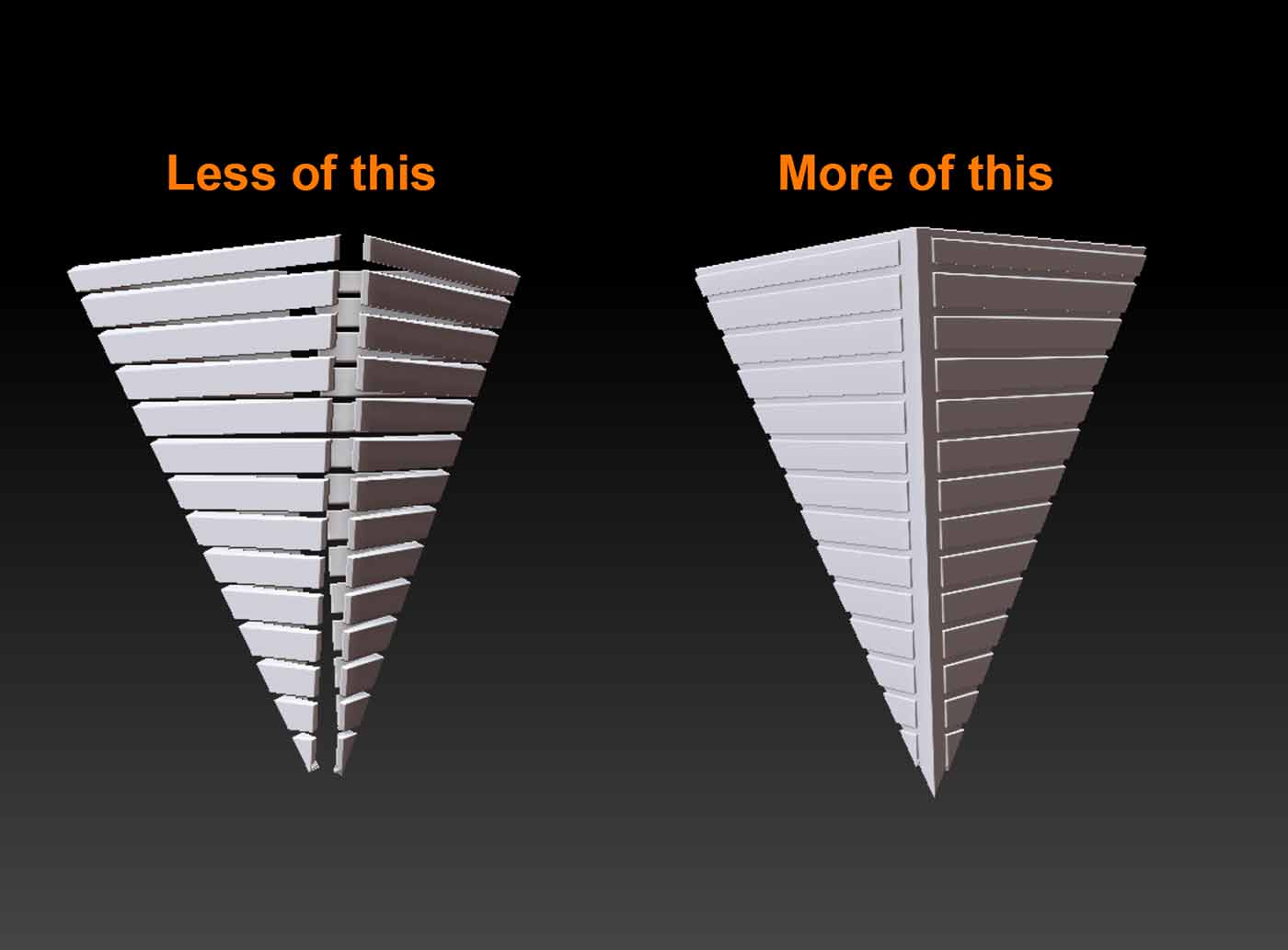

What really needs to happen here for the best results is that you need to completely re-evaluate the form of your mesh and consider how to create it as more of a unibody form with surface detail that does not intrude too far into the surface of the mesh. Sort of squint at your mesh and try to see it as a vastly simplified, solid form. How would you carve that solid, one piece form out of a block of wood? For best results, you’ll want as much detail as possible to be simple surface detail on that basic form, and not a series of tiny individual mesh pieces. The cleaner the form of your mesh, the better it will print, the easier it will be to prep for print, and the easier it will be to avoid geometry errors.
In order to do this you may need to retopologize completely new, vastly simplified geometry over the top of your model as a solid piece, and recreate the detail on the surface of that new mesh piece.

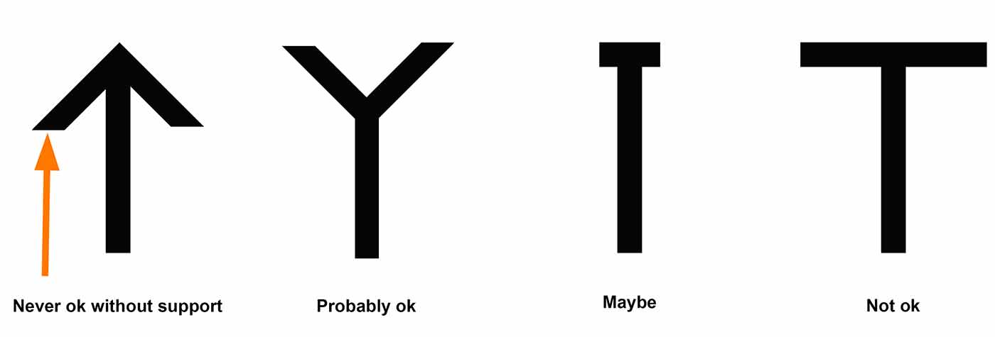

Printers are bound by the laws of physics and the limitations of their mechanical parts and printing process. FDM printers work from a printer bed > up process. Every layer that is printed must be built on top of another layer. If nothing is underneath it, it will need to be supported by a physical structure that you must create and print. You can expand outward as long as there is is a gradual upward expansion at not too severe of an angle. You can sometimes get away with expanding straight outward as long as you are not extending very far from the preceding layer. But any sort of substantial overhang will require additional support.
support2
The problem with all the long thin pieces with minimal connections elsewhere on the model is the level of additional support they will require. An FDM process also requires a minimal thickness. Depending on how large or small you are printing, your printer may simply not be able to create those pieces reliably with all the support connections they will require. Unless you are printing extremely large or as a series of small pieces that will be fitted together post-print, this is going to be a mess.
Long slender pieces are also going to be very sensitive to vibrations or mechanical disruptions in the process. A minor targeting error during the print can destabilize everything that comes after it. In other words, they will be extremely unforgiving and for FDM print you generally want a form that can absorb some minor mechanical errors.
Overlapped and redundant interior geometry will also complicate your model. You really want to be sending a single watertight volume to your slicer/printer.
