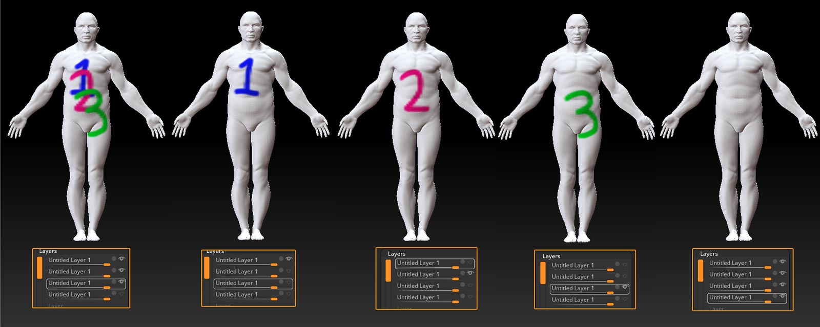

Polypainting on Layers appears to work as expected for me in zb 2021.1.1. If you have not upgraded to the most recent version of the program, please do so. Earlier versions of the program may be missing fixes.
Note the following image. I have filled my model with a base color prior to painting on the individual layers. Make sure the layers are in recording mode in order to record the polypaint. Make sure no Texture is active.
The layers all show up together or individually, depending on which layers are toggled to visible. Notice that each subsequent layer in the order overlaps the paint underneath. In the final image no paint is visible despite all layers being toggled on. This is because the final layer is painted with color that matches the base color of the mesh.
paintlyr
If this is not your experience in the the current version of the program, please try to document your process as well as possible with screenshots, and we’ll take a look at it.
