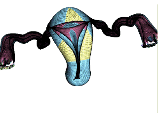

Hi all artists.
It’s a pity: only of late I found out a beautiful
plugin by our Marcus
-Mark2grp.zsc,
which colors
marked areas of the mesh.
It can, when in flip mode, render easily beautiful
tunes to the inner parts of complex meshes.
Only I failed to correctly color parts of the mesh with the colors I wished.
I wonder if one could choose any color to paint the group. That would be so useful!

Thanks so much dear friends for your feedback.
:smiley: now can use shift K all right.
In real one can use the knob with Marcus tool, put just on the working canvas nearest to the field of interest by CTRL and left mouse catch.
It is very handy.

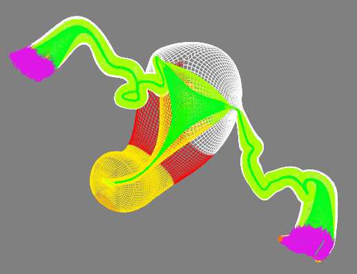

My task is painting transparent multistored organizations and revolving them like below. Grouping suits me so swell.

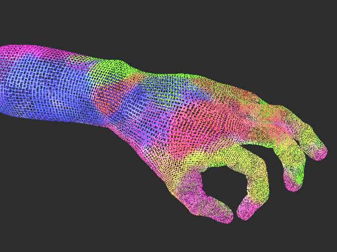

Here is a little zscript you might like to try. Basically it creates a texture of the wireframe (it creates a clone so that your original is untouched) so that it will render transparent. It’s not fully tested and produces rather a lot of textures in order to get the necessary result but you might find it interesting. If the polymesh is above 50,000 then it uses a lower level. I’ve not found a satisfactory way of coloring the result but you could create a separate colored mesh and combine the two in Photoshop (or similar) before reapplying.
Unzip the zip and load the Wireframe.zsc from the ZScript>Load button.
Cheers,
Here’s a color version. Press the Colorize Mesh button to paint colors directly on a polymesh in Edit mode. When you’re done, press the Render Wireframe button to render a colored wireframe texture. The result is not as clean as the ZBrush dots mode but you can paint any colors you want. Also using a different material (such as Fast Shader with high Ambient & Diffuse) produces quite nice results.

That is something, but doesn’t work on my models, saying the texture is wrong for my model.On lower mesh it does work.
The idea is to replace usual paint with colored parts of the mesh, so that the paint would not penetrate lower (into the inside of the organization).
Anatom
