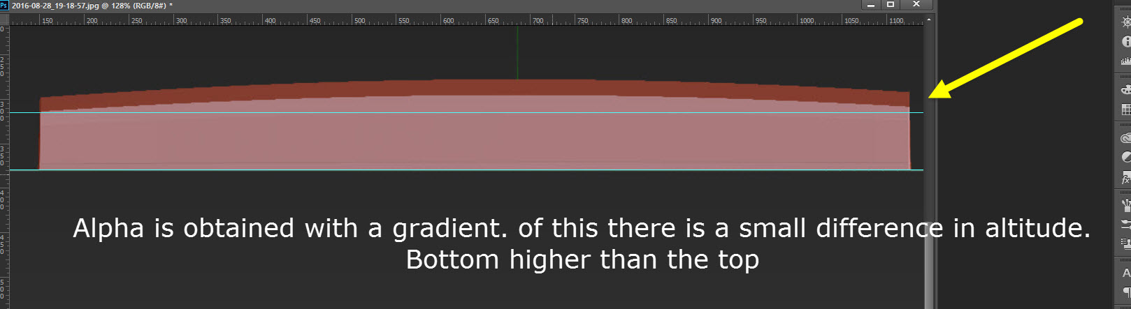

And what about the dark top and bottom light of the resulting alfa?
Are you still getting that with a single image? And how can you tell?
I’m getting one picture as you said.
Thank you.
But in any case, there is a gradient. top dark bottom light.
Accordingly, the underside is higher than the top side of resulting barel’ef from this alfa
I’ve never heard of ZBrush having a problem in this regard. The only thing I can think of is that your model is not placed parallel to the screen plane. Or possibly you have Perspective on and that’s affecting things for some reason.

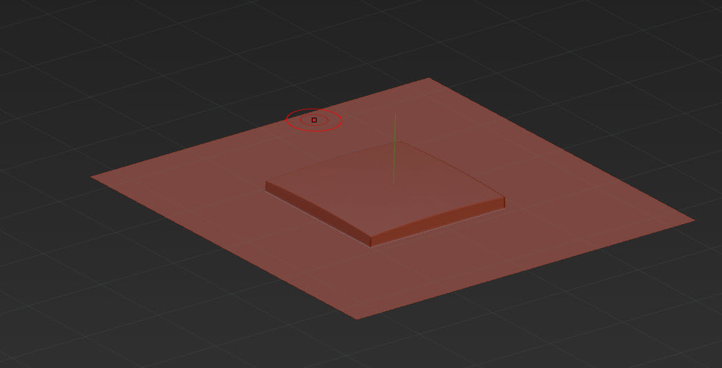

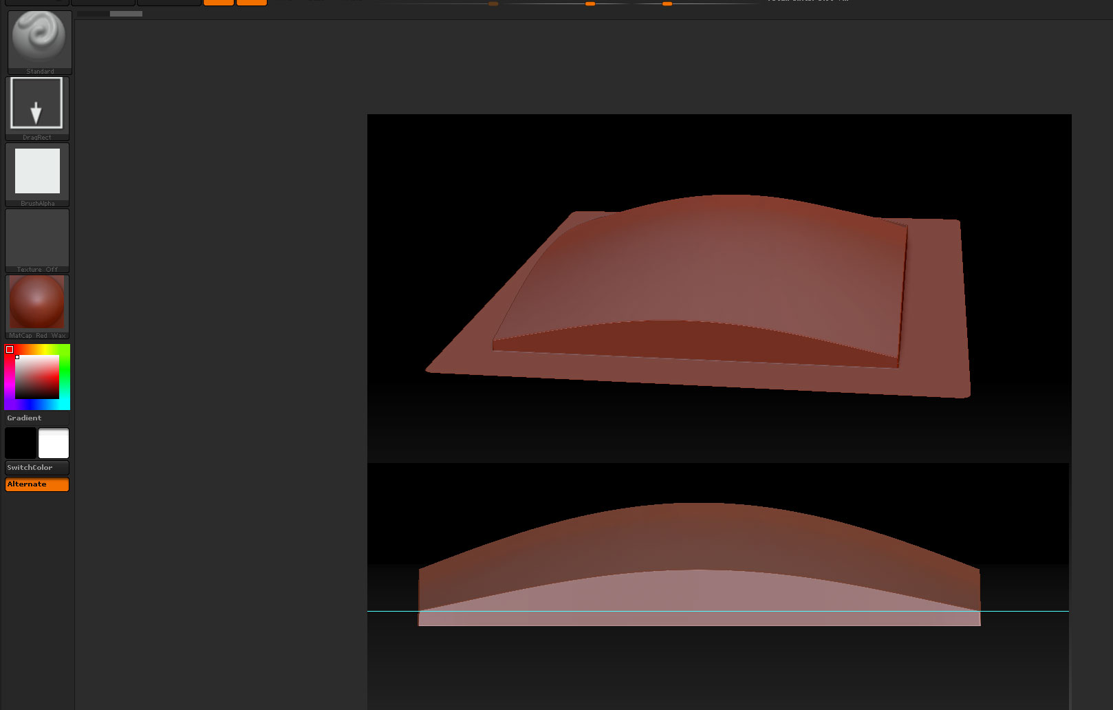

For the sake of experiment I took the standard Plane.ZPR
I made out of it alpha.
And that’s what happened.
Mesh-based Alpha looks convex.
One height is shorter and the other longer
Well, I don’t get that. The convexity is the way the sculpting brushes work. But there’s not a difference between top and bottom for me. I also loaded the alpha I made in Photoshop and checked the color values - it’s pure white all over.
