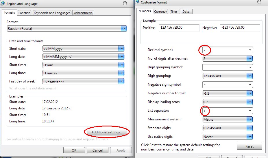

What do you think, whether period or comma in the system to influence this process? Or maybe Eset ESS 4, anti-virus and firewall?
best regards,
triar
