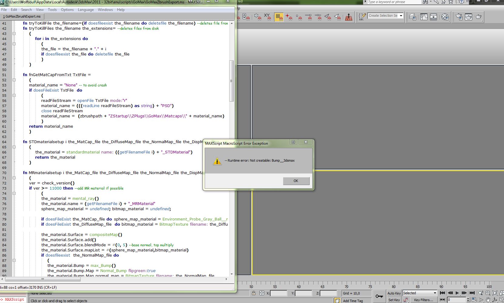

it work´s but when transfer the model from zbrush to max give a error and open the maxscript windows ! here is the error:
 [attach=189108]error_gomax.JPG[/attach]   [](http://www.zbrushcentral.com/zbc/faq.php?faq=vb_read_and_post#faq_zbc_display_images)
2011 is obviously not supported fully, the plugin is built for 2010 and below.
I’ll download the 2011 trial - it seems the max_bump part of Mental ray has been removed or changed into something else. If you are running on 2011, DO NOT use mental ray as your material and you could be fine.
And please guys, 2011 was released really recently, we’ll of course update GoMax to work with 2011, but until then only max 9 to 2010 is officially supported so do know that if you try to use 2011 you may run into bugs.
