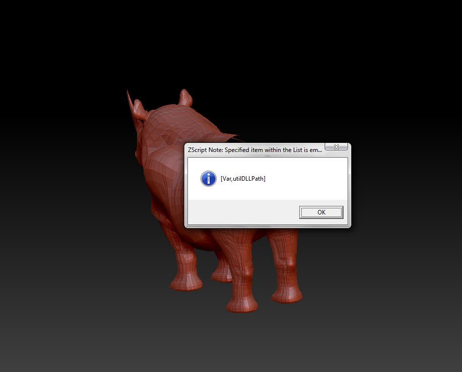

I get this error in the new version (old was running fine 1.6 or something)
Every export ends in the same way. All tickboxes were green on install. It sits in stdplugs in my max dir.<img src=“http://www.zbrushcentral.com/pixo/atn.gif”>

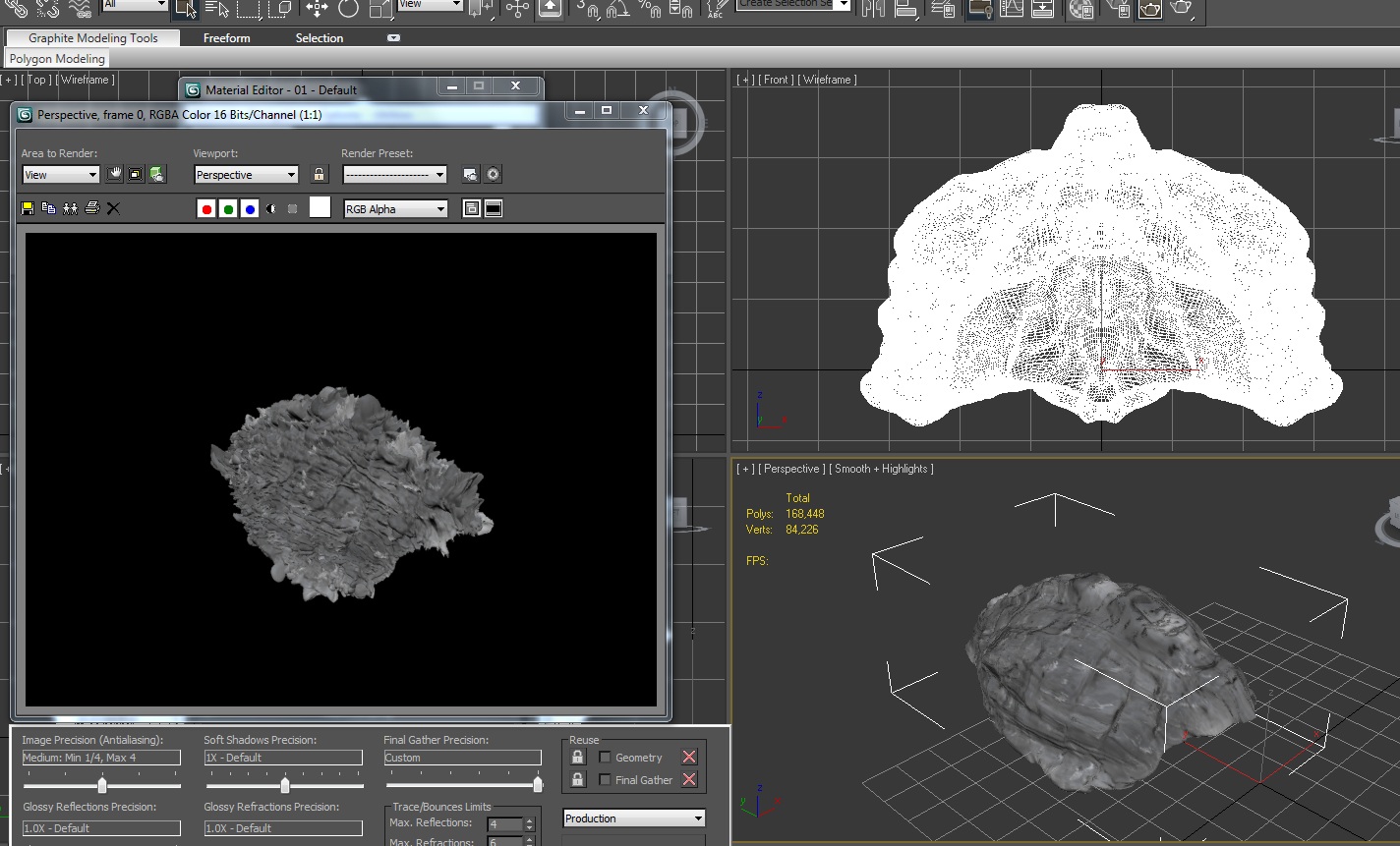

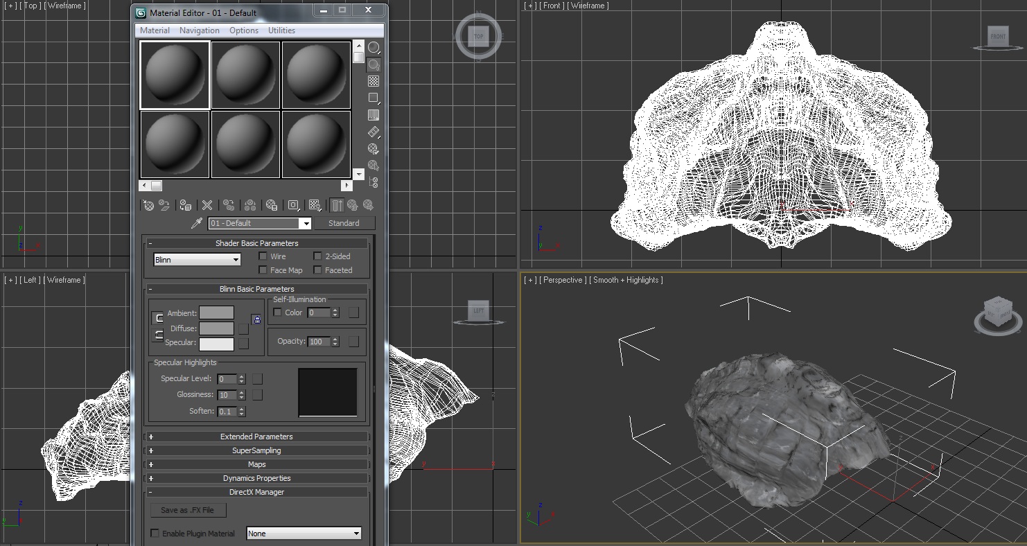

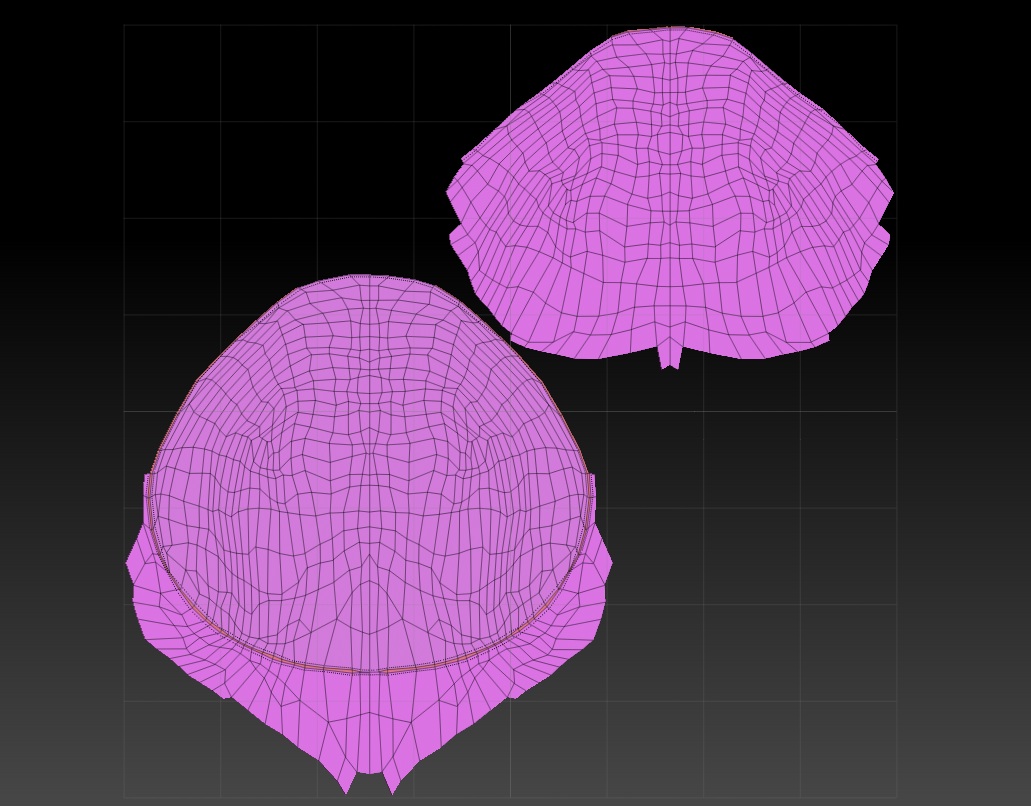

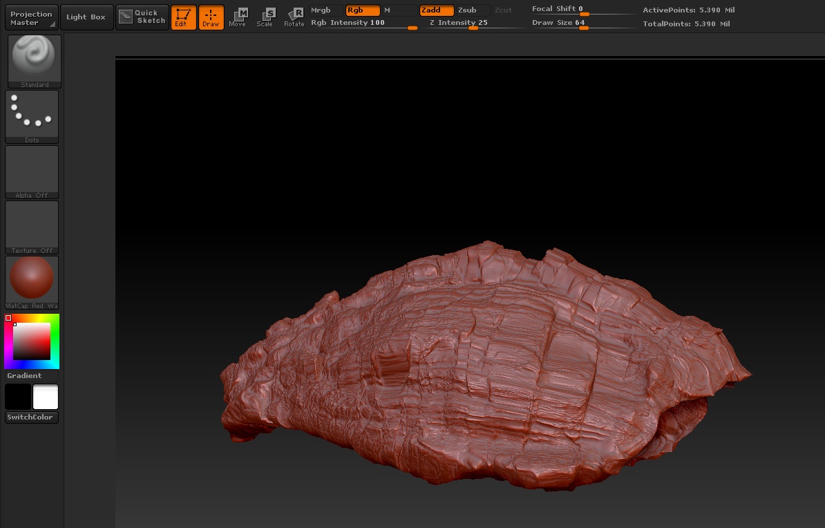

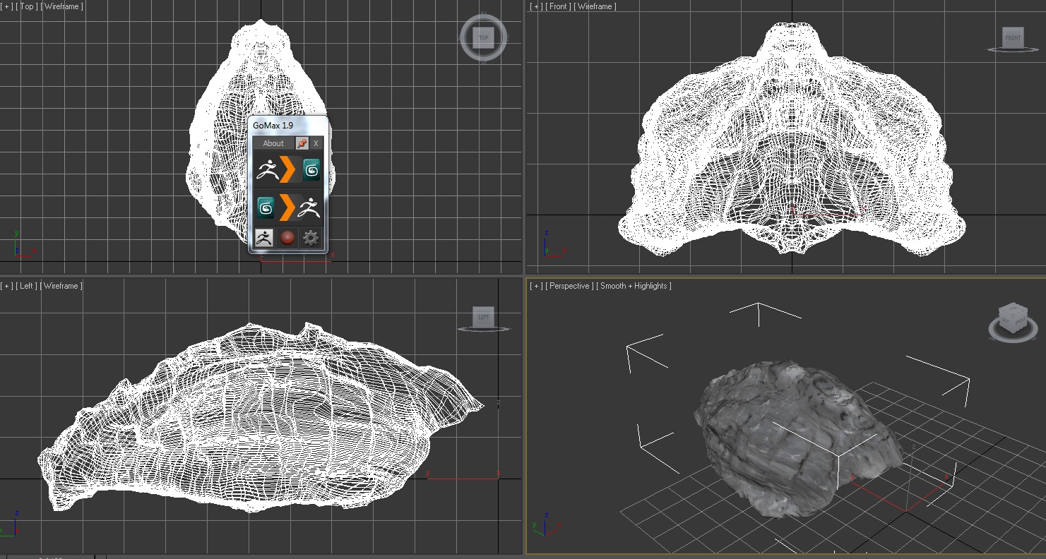

ok, i can see a lot of people got it workin with no problems, but im having a major one so i decidede to take a screenshot at each step of what im doing to see if someone more experienced can help me.
I dont know if the problem is with my uvmaps ( generated with uvmaster within zbrush ) or what, i even added a turbosmooth modifier but it was useless, i hope you can help me solve my problem.
everything shows normal on the directx preview as you can see but in the render its all messed up, also there is no material in my material tab, is that normal with gomax?
thanks in advance.
It looks “messed” up because you are rendering with a displacement map, and it probably hasn’t the proper values set. The Material is in slot 24, which you can’t see because your material editor is set to bigger slots.
In any case, just take the pipette and click on the mesh so that the material appears in the currently selected material slot.

thanks a lot norman! will check into this
problem solved, it really was my displacement settings
