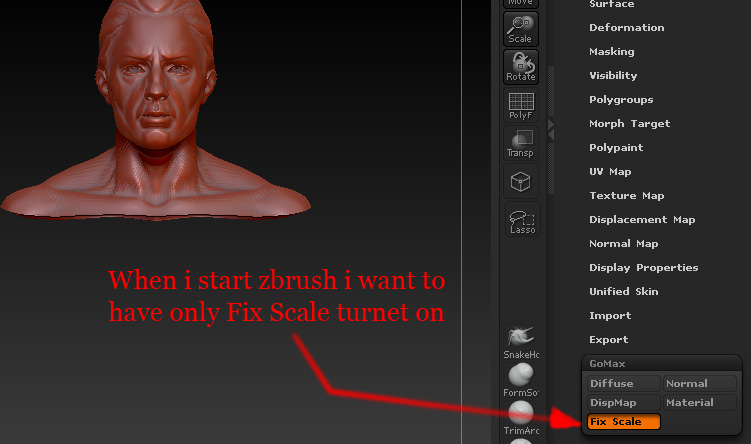

just one question
how i can set the settings in gomax that anytime when i start zbrsuh to have turned ON only Fix Scale in gomax , i tray to store zbrush but this doesn’t work
Thanks
and i m sorry for my English ,i hope my question make sense

We’ll work on this for the next version… for now you could open the GoMax.txt under ZStartup/Zplugs,
and change the 1 with 0 in those option you want to have turned off.

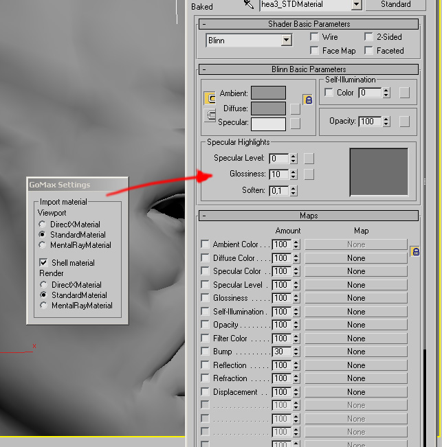

Thanks For the help Norman ,
i have another question
i have this problem only when i do this :
i set the gomax settings:
Viewport - Standart Material
Render - Standart material
after zbrush export in 3ds max in standart material slots is empty , there no textures loaded
[[attach=186209]eroor.jpg[/attach]]
Thanks so much
