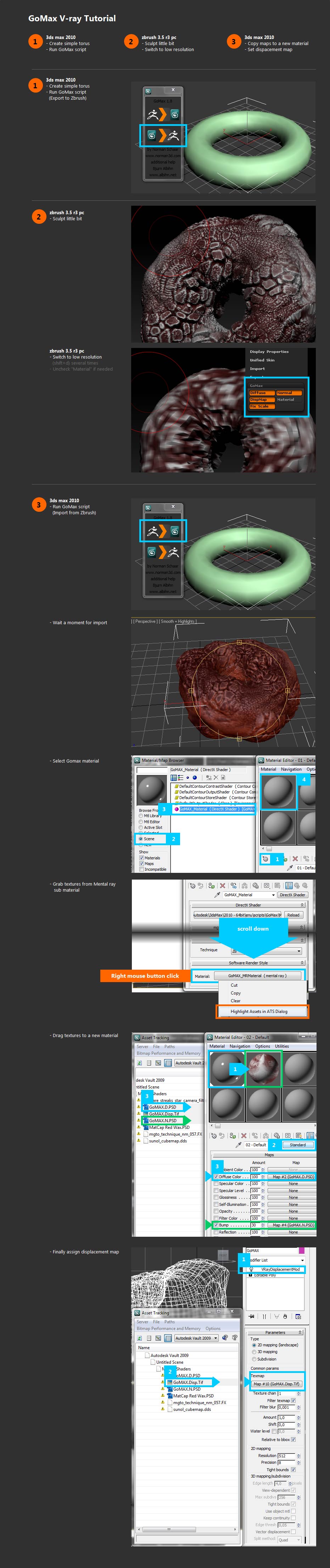

guys, does anyone have correct setting for Vray render?
mostly interested to see working displacement settings (with screenshots? :wink: )
here is my workflow for gomax + vray
sorry for bad english, if needed correct me pls

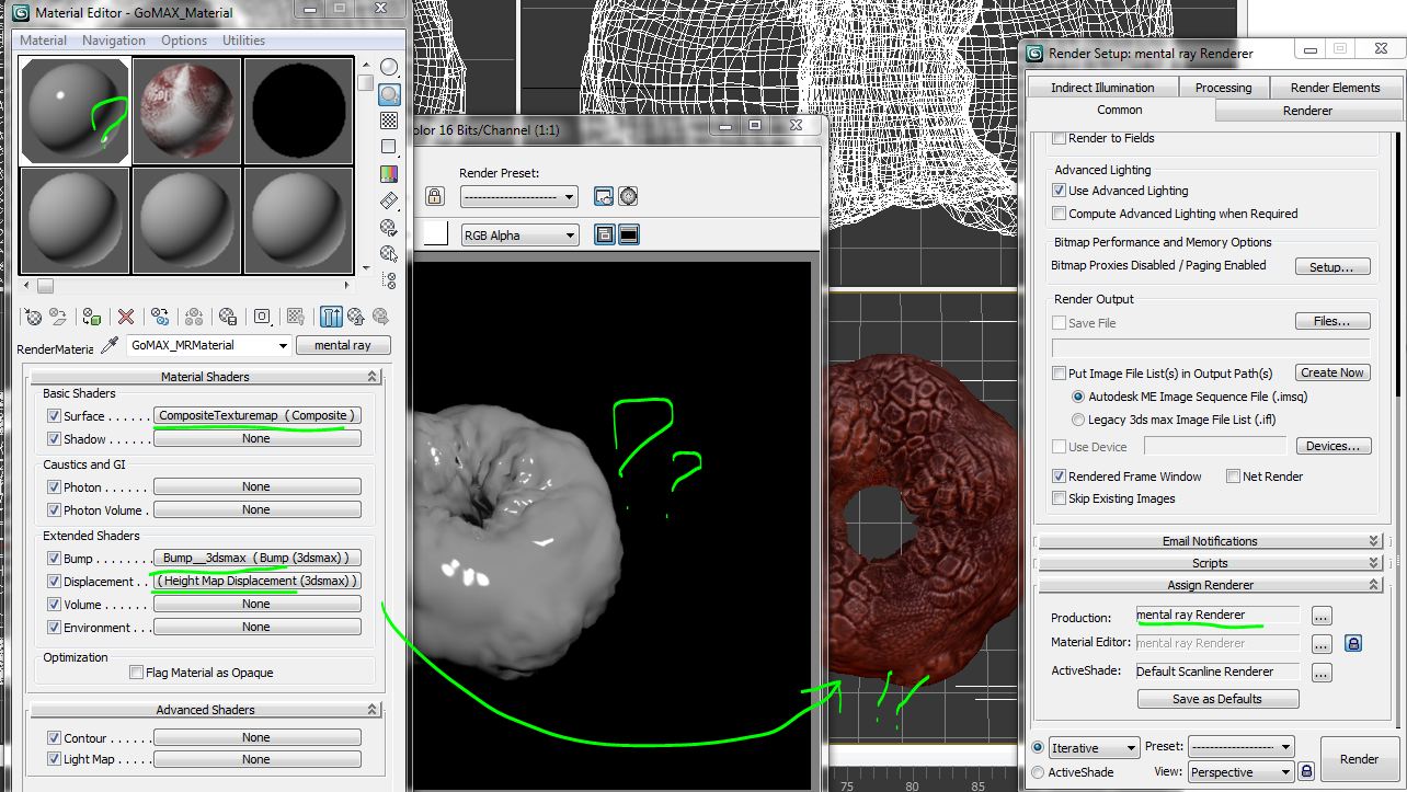

norman, here is a bug i’ve encounter in mental ray:
[attach=185233]mental-no-psds!.JPG[/attach]
(one time i’ve saw in MR message window: psd is not compatible, converting to raw data… blah blah. could this be a reason?)

i’ve mentioned above about bug, but not described thoroughly it.
so, do this now - when i do export from zbrush in viewport all displayed correct, but when i git render button, i see only base geometry without maps (diffuse, displacement etc) :o . mental rey set as default render.
any ideas? thanks in advance
yep we are aware of it. Problem is the “Render slot” in the DirectX material is not working. It’s basically ignoring whatever is inside. Right now you’ll have to drag and drop the material out of the slot into a new material slot and apply it to the mesh.
