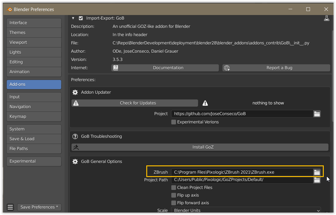

In Windows, ZBrush installed on non standard path:
Lines 1446 - 1454 and 1472 - 1481 of GoB.py, about the filepaths, get priority to whatever I enter on the ZBrush path in the addon option in Blender, so that, if ZBrush is installed on a different path that C:/program files/ , the exporter doesn’t work, giving a FileNotFoundError.
The only way I could make it work was to edit the filepath directly in the GoB.py
@marcolomeo thanks for posting the issue, id you enter your custom zbrush path in the preferences? if not please try this while im looking into this issue.
can you tell me what version of GoB you are using?
I already tried it, and nope, it gives the same error; I think the path in the code overrules it, or it simply doesn’t get read.
I’m using GoB ver 3.5.1
maybe i overlooked this usecase i will try to reproduce it but could take me a couple days.
Thank you!
And no worries; even if it’s just did a crude hack by editing the path in the code, I can use it in the meanwhile.
can you tell me that path you entered in the preferences to your zbrush executable? that might help find the issue
I think I’ve tried this path below, and also the same path without the executable; I don’t remember if I tried also with the inverted slash “/”: I would try now, but I prefer not to mess with the plugin ATM, as I’m in the middle of a sculpt.
D:\+++ PROGRAMS +++\Pixologic\ZBrush\ZBrush.exe

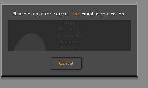

The Export from Blender works as expected, it imports into Zbrush fine, but my GOZ setup is grayed out
image and if I try to locate the Blender Path, Zbrush crashes.
Any ideas?
Thx
~t
@lildragon i have not seen this before, can you run the GoZ installer and see if that solves your issue? you should find it in the zbrush troubleshooting folder.
Hiya yeah moments after I posted that, I realized Zbrush doesn’t like when the app in question is opened.
So when you yave blender open when searching for the path then zbrush crashes?
Yup

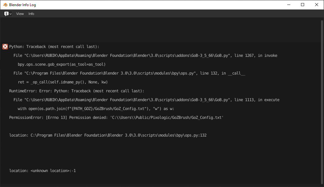

when i try export from blender any mesh i have this error / in any versions blender blender_JwVESY9y3C
Hi @111868 ,
the issue you have is because the blender addons can’t to edit the following file :
Permission Error: [Errno 13] Permission denied C:\User\Public/Pixologic/GoZBrush/Goz_Config’
try to run Blender with run as administrator, that might fix the issue.
Hope it helps!
Nicolas
its really work . thanks

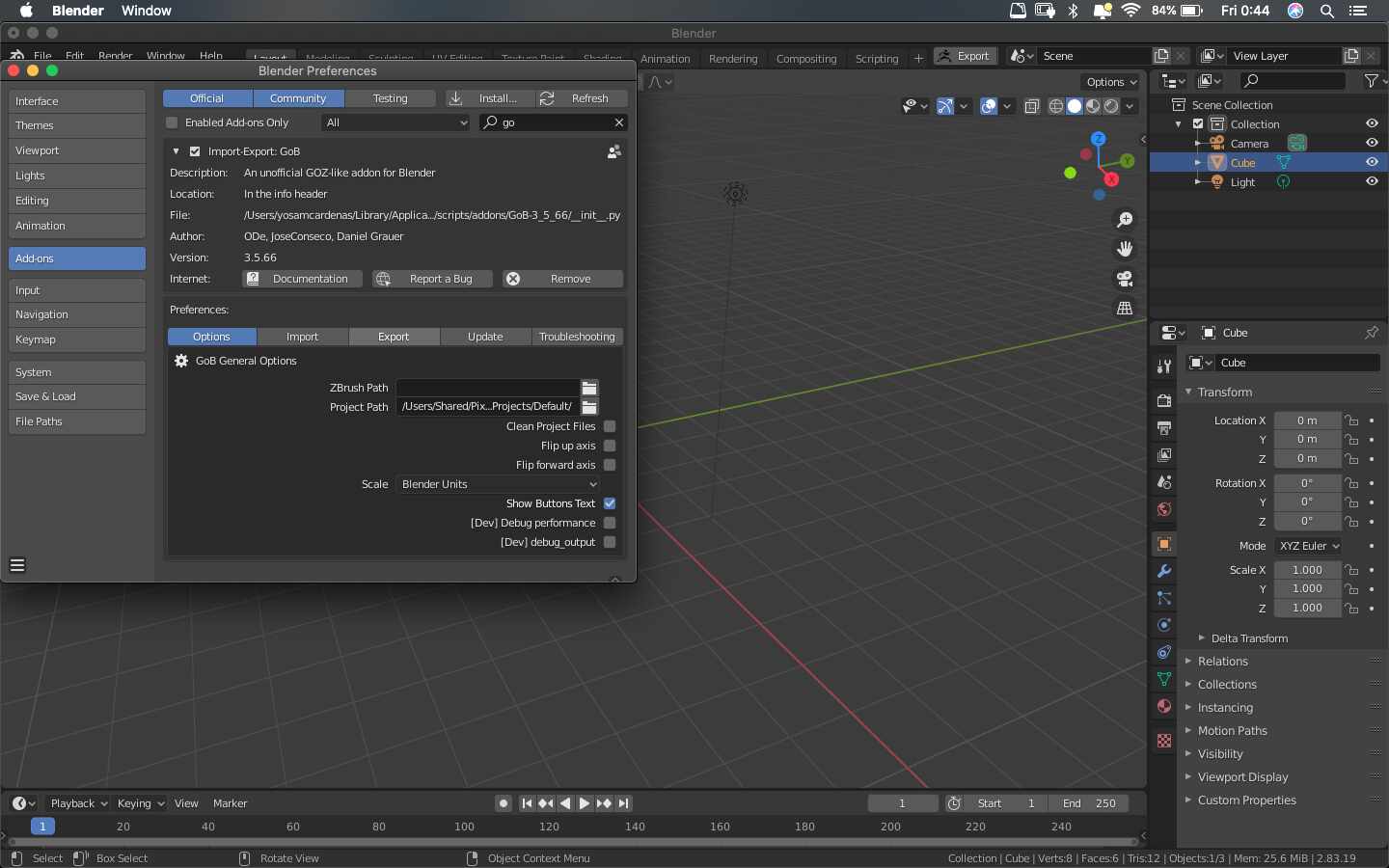

hello Kromar, I was using the add on and it was working fine the export and import, I upgraded zbrush to the 2022 version and I lost the import button, I jus have the export button.
Screen Shot 2022-03-18 at 12.44.37 AM
it seems the zbrush path is empty, what would be the path?
I’m using a mac.
Hi, this is strange, upgrading zbrush should not impact the blender addon. I will need to try this on my mac and see if i can reproduce it. In the mean time maybe you can try to remove the addon and install it again and see if that solves your issue.
