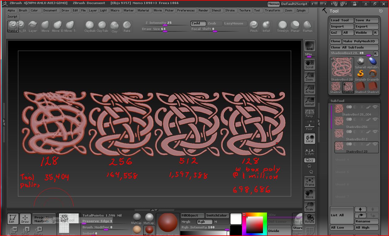

Here’s a little test I did regarding this subject.
Left to right I used a 128 shadowbox, a 256 and a 512 on the far right I increased the polycount of a 128 box to around 985,000 polies before I created the tool. I jotted down the poly counts of the 4 tools beneath them. You can judge resolution of each for yourselves.
I’ve found that subdividing and unchecking smooth before entering shadowbox, you can get much more detail out of it, because it keeps the detail level from before shadowbox. Maybe that’s obvious, but I’ve found shadowbox extremely powerful in making things that are oddly shaped and unique base meshes that are maybe a little tricky otherwise. Spheres are great, too of course. I was just thinking of higher quality alphas too.

ezra… just realized what you did basically proved that i wasnt going completely looney :smiley: … thanks :slight_smile:
