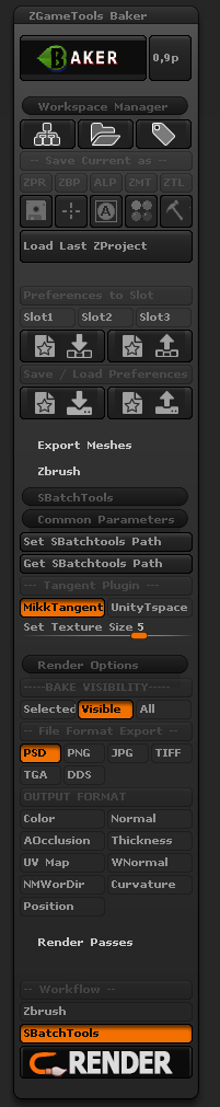

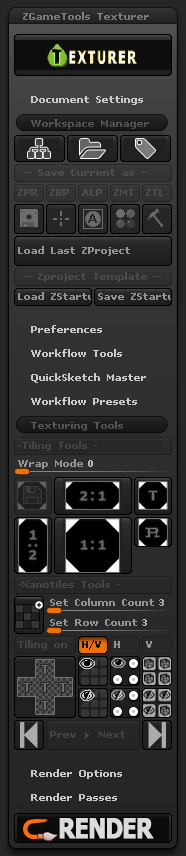

some new idea for the structure of the plugins
Module 0 : PSD Document Bridge
  • logo
  • psdsend - psdreceive
  • 4 switchs
  • quicksketch module
  • Texturing module
  • Illustrator module
  • baking master ( substance batchtools)
  • License Activation
    -About
-content Here - (depends of the Selection)
if Texturing module ( with pbr tools)
  • ALL bpr + filter
if illustrator module ( no pbr)
  • ALL bpr + filter
if Substance baker
  • no bpr filter only available map that batchtool can create.
Module 1 : Quicksketch Tools
  • texture to qsm
  • bpr 2 qsm
  • classic quicksketch
Module 2 :Texturing Module
  • document size
  • texturing tools
  • workflow tools
  • workflow preset
  • render passes
  • render options
Module 3 Illustration
  • document size (preset ?)
  • workflow preset ( could be different than what is available on Texturing module )
  • render passes
  • render options
  • include Quicksketch tool ?
Module 4 : substance batchtool Module
  • document size
  • render passes
  • workflow preset
  • render options
What do you think ?

I had successfully created the buttons paths to be stored into a vars list, that was another challenge ^^
I also made plenty of icons to make a more fancy UI :slight_smile:
Hope you like, it takes more time then expected at the moment it no more 1 plugin but 4 plugins :slight_smile:
Nicolas
