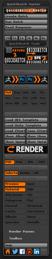

i could have something interesting to show you , you knowledge on Zbrush could maybe help me to make more than what i can do using my plugin.
let me just show you the Plugin Ui so you could understand what i had worked with :
it a little bit rough now cause i putted some buttons for my tests and some should be simply removed for the 1.0 release.
create batch, run batch and read respond should become Activation button.
i made some material you can found for free here that i use in my render passes batch.
a world normal map material and an enhanced tangent normal map.
My challenge as to make some pbr texture using Zbrush only, but it a little bit limited.
First i had to make this Rendering passes system to handle classic texturing workflow, capturing matcap and more.
make it also interesting for illustrator that want to quickly use Zbrush and a psd editor to make and mount all the rendered passes.
After this had been done, i had been in capacity to test out a workflow to make albedo, gloss /rough , specular, metallic.
unfortunately the only way i found is to use the quad shader
first channel store the albedo rgb value ( so i need to create preset material that match the chart and ofr UE4 and for Unity)
second channel store the gloss/rough it just a grayscale value
third is specular
and the fourth is the metallic.
the only way to bake this four maps, are to switch from SH1 to SH2 for all the used materials. and then bake, and again disable SH2 and enable SH3, then bake.
For all this the polypaint must to be disable or it will appears on each albedo/gloss/spec/metal.
it prevent me from create some variation on the albedo etc, i would love to have a texture sampler that repate along the canvas and then i can change depeing of the channel is am displaying and i m going to bake.
That would not be awesome to have PBR texturing ready in Zbrush and that can beat quixel /substance designer or that can be use as combo to give more option for the texturing workflow. This is what i am trying to achieve :slight_smile:

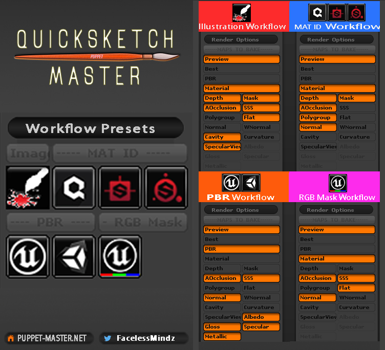

The objective are multiple with quicksketch master plugin, ( if anyone have a better name you can suggest me )
Illustrator/Rendering Usage:
The plugin has PSD Editor bridge and a Render Passes Batch system that renders and save all the requested maps so you can open them in photoshop and rebuilt the all the passes to get a similar rendering then when you render in material shaded mode.
The problem is that Zbrush can’t to export a layered psd file, so you have to do that manually within the psd Editor
oh it’s even better when the PSD editor supports the hot reload.
Sketch and concept art,
There is a tool that acts like the originally Quicksketch function made by pixologic,
but it renders the selected maps using BPR,save as a psd file, then reload the file as a texture, to apply the render onto a plane3d mesh texture maps slot
and turns the texture into polypaint data. So you can instantly start to sketch/draw on it.
It can be useful, when you make some silhouetting /concepting sketch into Zbrush, example : if you use move tool on the plane3D mesh
there is a distortion that can be removed by using BPR 2 Quicksketch feature.
There is also the classic Quicksketch option so everything is at the same place within Zbrush UI.

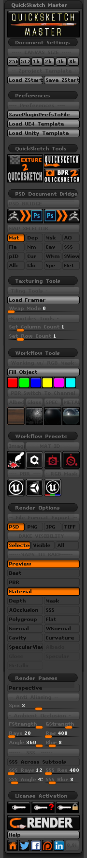

That say, the main reason and objective with the development of that plugin was to create PBR textures using Zbrush, unfortunately, Zbrush shader system is restricted, so I made some workflow preset so you can work with many other software, substance designer/painter, quixel suite, using matID maps with the rendering batch.
I m working on a save plugin preference to File, so you can load custom settings and make you own.
I added some tools that help to create RGB mask for using with UE4 material editor, so you can have different shaders blended on the same UV set.
Lately i could develop a material library for ue4 or even use the starter pack material at first time, so i could recreate the setup just by pushing a button
and reading a config file that will be created from Zbrush.
Note that PBR shaders in Zbrush are preset materials already calibrated for UE4 and that respect the pbr charts.
shaders are simple quadshaders, you can load from lighbox, ( it a full mess, into the Zb material picker to handle all this pbr presets so i prefer to use lightbox. )
Albedo, gloss or rough, specular, metallic are store within the SH1, SH2 sh3 sh4 properties, just that pbr are very flat at export, because the quadshaders do not support texture input.
There is a switcher in pbr Workflow subpalette, it checks every materials used in the zproject, and switch to SH1 channel, disable all the SH2,3 and, 4 than bake the maps,
after that it disable SH1, enable SH2 and render again, and so on.
Now that everything is working as expected, i am working on tools that will support the use of nanotile mesh to create tiled textures.
When i would have achieve this part of the plugin, it will mean that Zbrush will have a full NONE DESTRUCTIVE Workflow, to create Tiled Textures maps.
I planned for the 1.1 version, after the release 1.0,
to add models support, so you could export from Zbrush your scene and subtools models and then Bake the maps you need using Substance BatchTools.
Voila !

some progress :
illustration Workflow :
i added some more options for this workflow
  • shadows
  • floor
I just had published a tutorial that show up how to work with the render passes baker in Quicksketch Master plugin and a PSD editor ( photoshop in that case)
I try to give function that could be handful for different kind of work , i just been focused on that kind of work to be sure every one will be happy :wink:
Nicolas
still very slow progress,
quicksketch master roadmap on trello :
I would like to have place where i can write down some idea that I can’t focus now for the 1.0.
so any people could see what features are expected to added into the next builds (1.1, 1.2, etc).
But for now, I am in lack of motivation, it hard i try to get some feed back but it likes i’m invisible :stuck_out_tongue:
